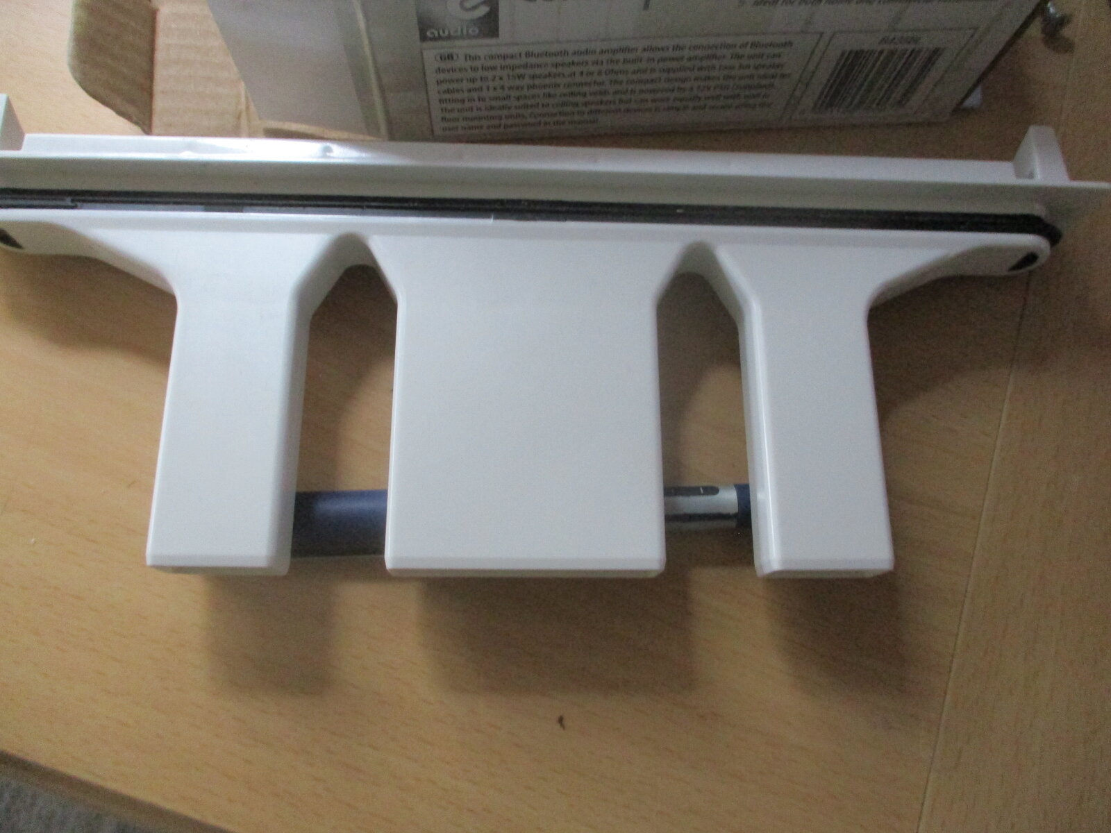

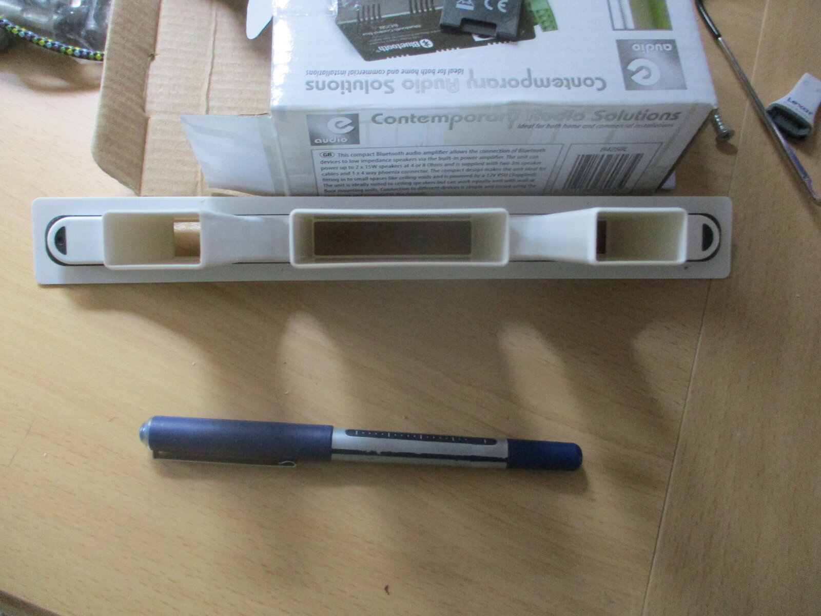

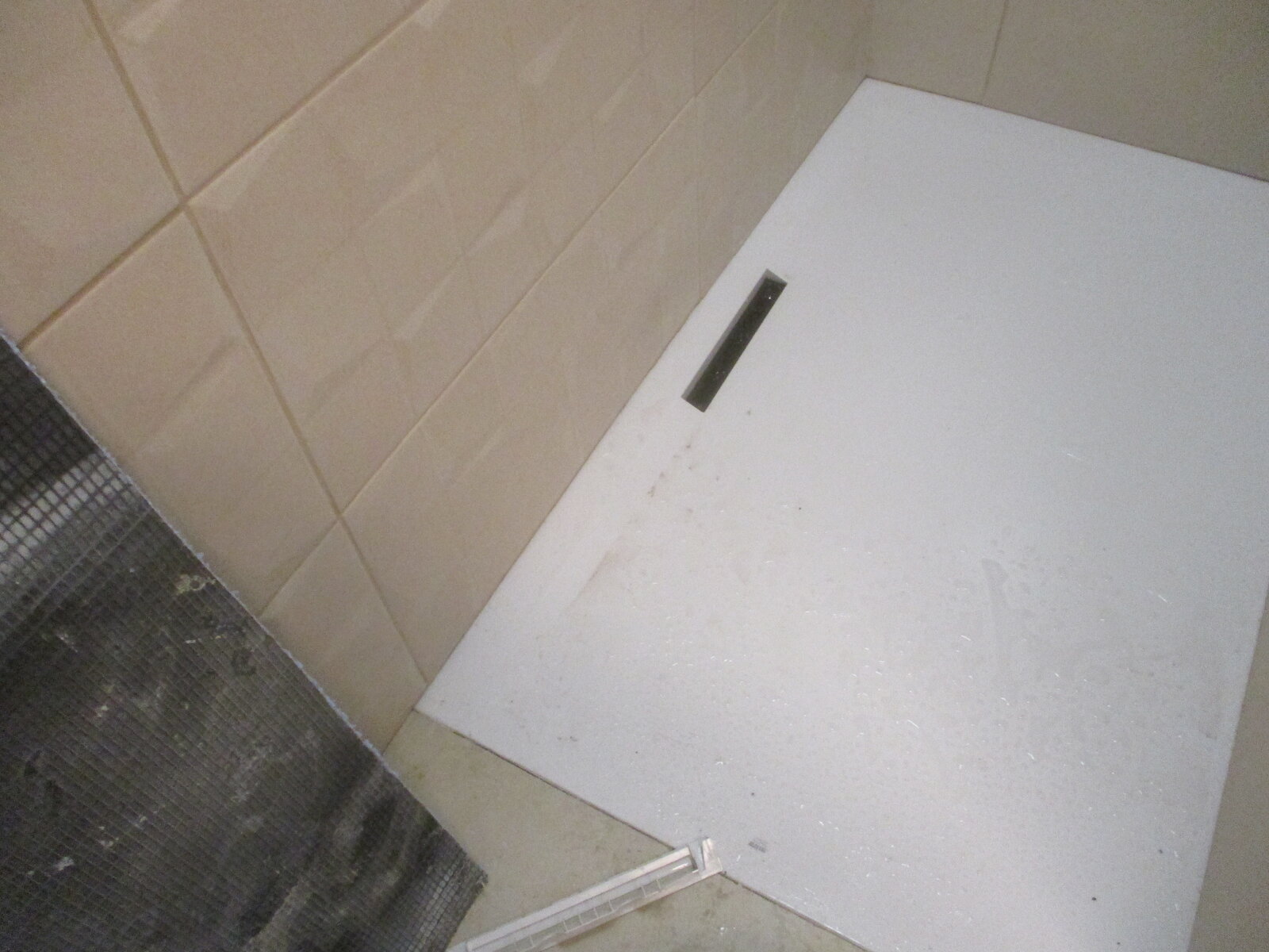

There is an update on this worth keeping in mind if you use Mira flight shower trays with the slotted centre waste.
Having made all of the pipe fall adjustments I ran the shower to double check for any leaks at any point so I left it running.
After 4 minutes, the shower tray had flooded once again so I knew for 100% it was related to the waste this time.
In desperation, I called the Mira support line and explained what was happening. Their immediate response was to email me a diagram on how and where to drill extra holes in the waste cover to improve drain away.
The waste has a hair guard which is removable for cleaning but when in place, the form is very restrictive to flow.
Having removed the hair guard, drain away was perfect, no flooding. Hair guard in place, flooding in 4 minutes
I measured the apertures in the guard (only 3, 2 small, 1 larger) and I calculated a drain flow to be a max of 10 l/min against their stated 30 l/min
The fact they had an immediate fix suggests they are well aware of this design fault
So It was not ALL my fault after all LOL
middle slot is 50mm x 11mm, the two smaller slots are 11 x 20mm..

So where did you have to drill the holes, that's the fix for when you have a standard round waste with a chrome cover, you drill holes in the top of the cover to allow the trap to expel the air when filling with water, doing that breaks the airlock.
Never seen that with a linear drain but it makes sense.

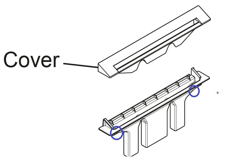

This was their suggestion:
"You might be able to help the situation slightly by drilling a hole in the tube section, if you lift it out and turn it over you will see dimples on the underside. See above.
You can drill through this quite easily with something like an 8mm bit… try the side opposite to the waste pipe at first… see if that does it, if not try both sides."
Yeah that'll be what it's doing, where the catcher narrows, it'll airlock and if the fall on the waste isn't the greatest then it needs that extra venting to allow it to overcome that and run easier.
