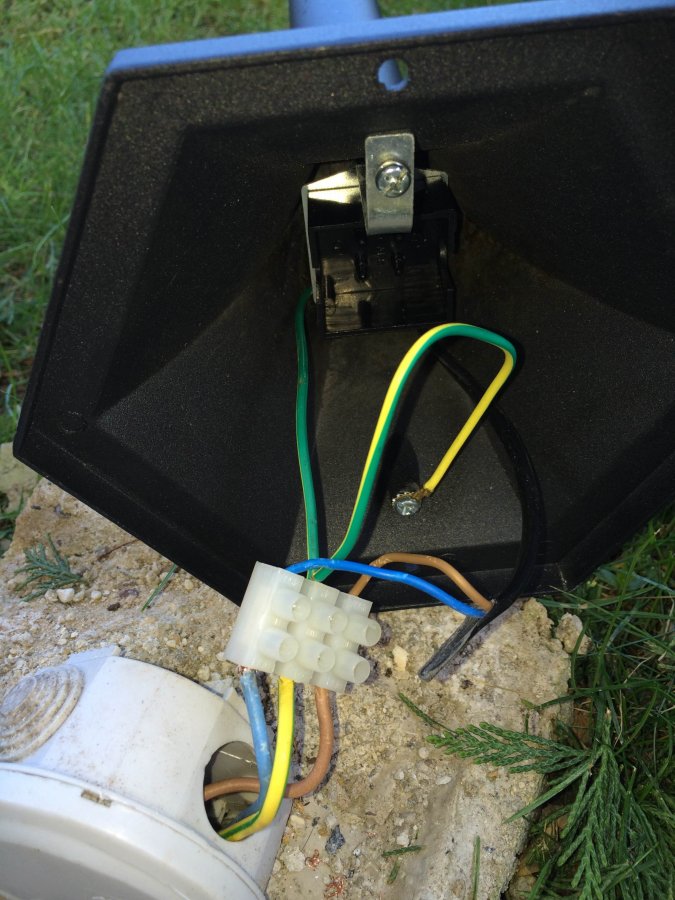

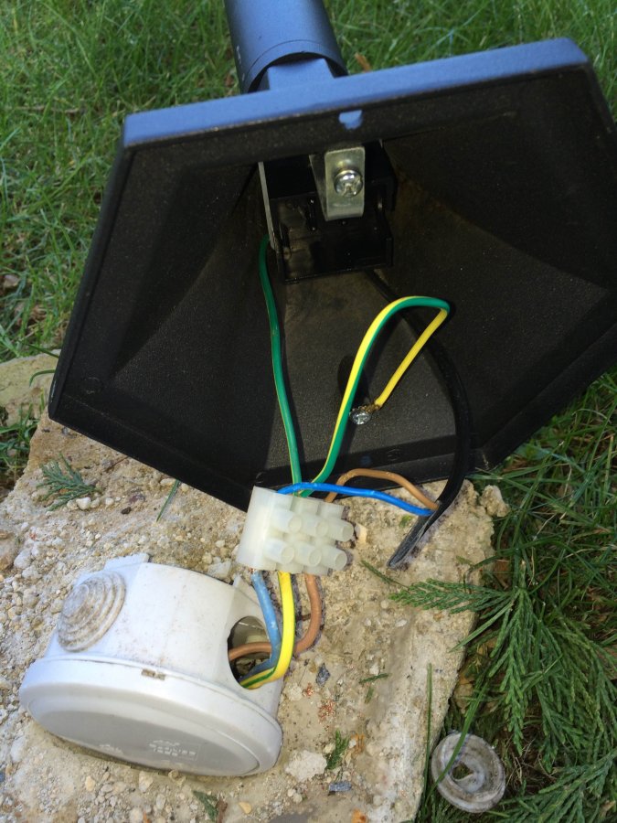

Hi
here are some pictures,if that helps.
I must admit it was bought off Amazon but it is IP44 and CE marked
A and B shows how i connected it,but it trips the fuse.C with the earth wire from the base loose,but it trips as well

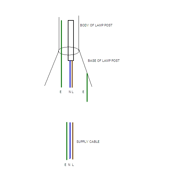

AA is the wiring diagram I made of how wires lay.
Please advice as to how to connect them properly.

Have you removed cover off circular junction box? Maybe something strange happening in there. Turn power off at circuit breaker first as may be a loose wire somewhere.
I have taken out the wires out from the junction box and the ends are now seen outside connected
The light fittings connector block is supposed to be in the black plastic enclosure inside the base of the light, a short length of suitable flexible cable should then have been used to connect into the round junction box with a suitable gland, or that rubber grommet that is now on the floor. The internal wiring on that light fitting looks rather long considering how far up the fitting the lights connector was. Has the lights internal wiring been pulled to try to make it reach the round junction box, possibly disturbing the connections to the lamp holder, or damaging the insulation?
Is it an MCB that is tripping or an RCD?
Maybe it's best to go back to basics and disconnect all wiring from the underground supply so the cable is not attached to the wires in the grey JB anymore. Make the supply safe.
If tripping still occurs, it is a fault with the supply. If not, as Ban says, there is a problem with the fitting (or possibly the grey junction box between the supply cable and the fitting.

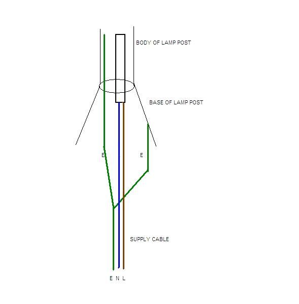

Coming to my initial query-the earth wires from the top of the lamp and the earth wire from the base(body) where do I need to connect them.
Shall I go ahead and re-do connections like this pic??
