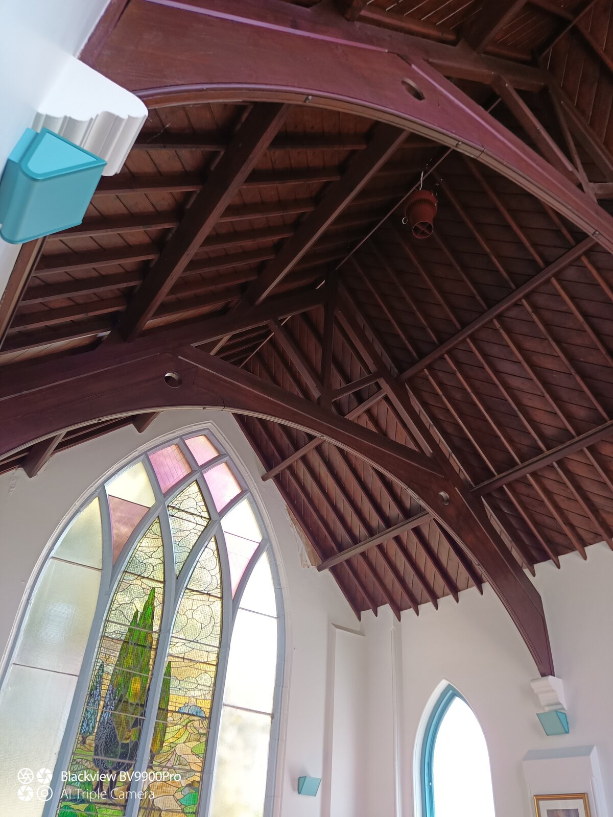

Do you mind me asking if you have an exposed ceiling fan or the type in an enclosed unit and how high your ceilings are?
Exposed, I ordered it in a colour. The height is 8 metres. It runs on speed 2 of 5

Hi - sorry to ask you one more question.! Even though I’ve looked into cooling fans (exposed blades) on reverse - and told by a fan company that 6 m is too high, no one has ever mentioned destratification fans.! You are the only person who’s mentioned them. Even the heating engineer who came to assess our system before we changed it - never mentioned them either. Did you look into destrat open blade fans and Would you recommend any particular company? Thank you and thanks for making me aware of these.
I have used open blades on one job, an assembly unit not even 6 metres and I think they worked, I wasn’t called back (30 plus years ago).
Destrat fans were recommended to me, I did a bit of research and went for it. Not cheap, I think £1500 pounds but I can confirm.
I could have mounted them lower of course but wanted to hide as much as possible. They’re much more forceful and I have a completely uninsulated roof so wanted to move as much heat from the apex as possible.
