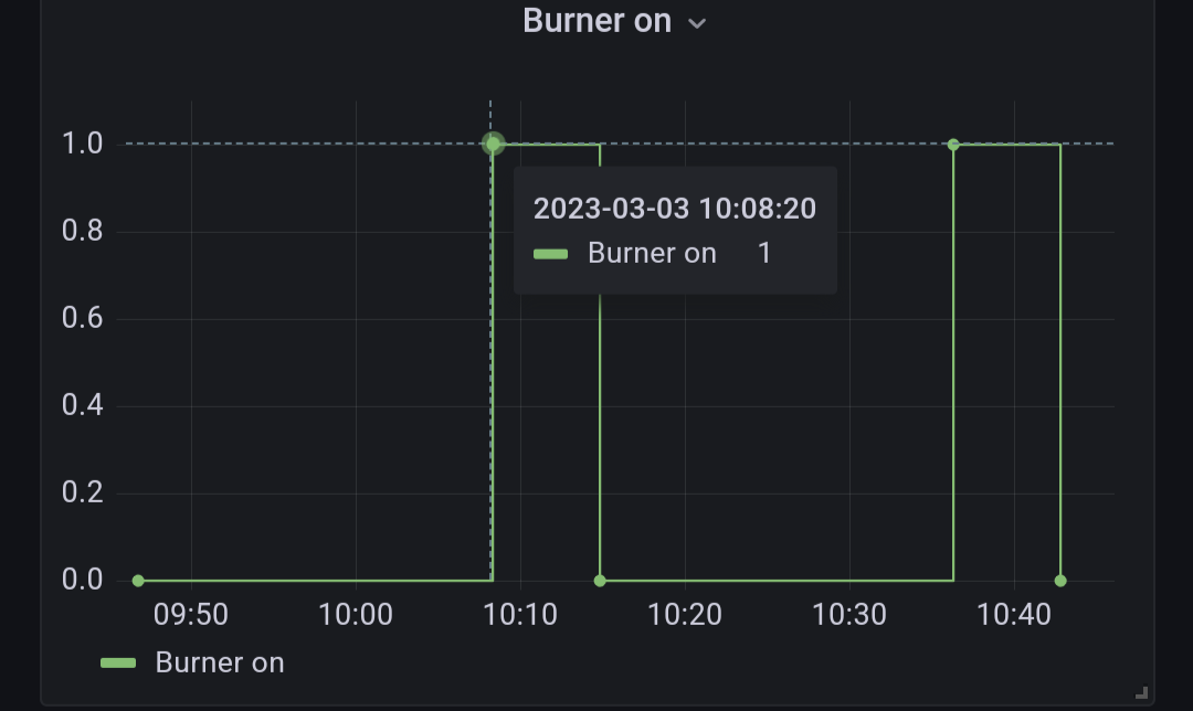

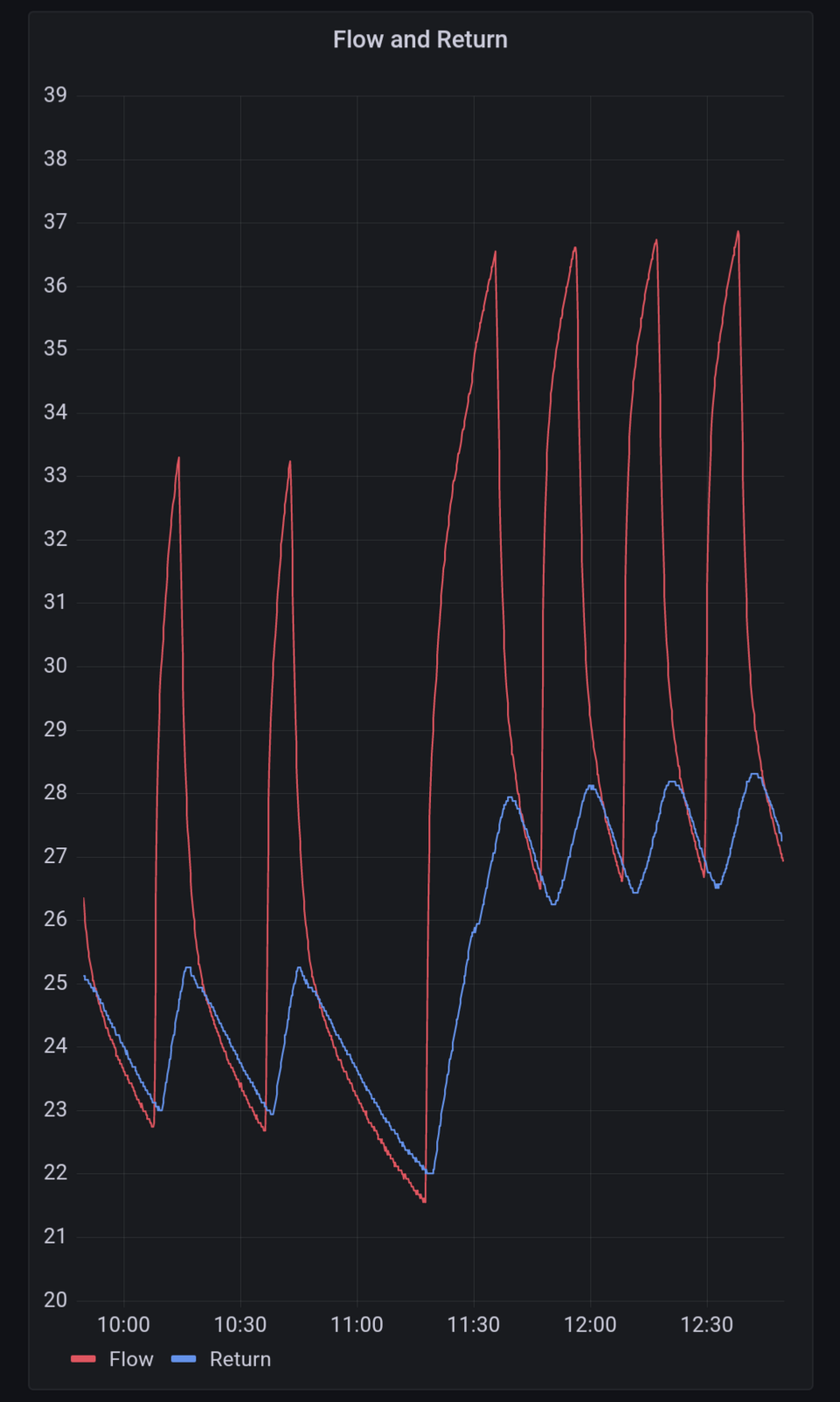

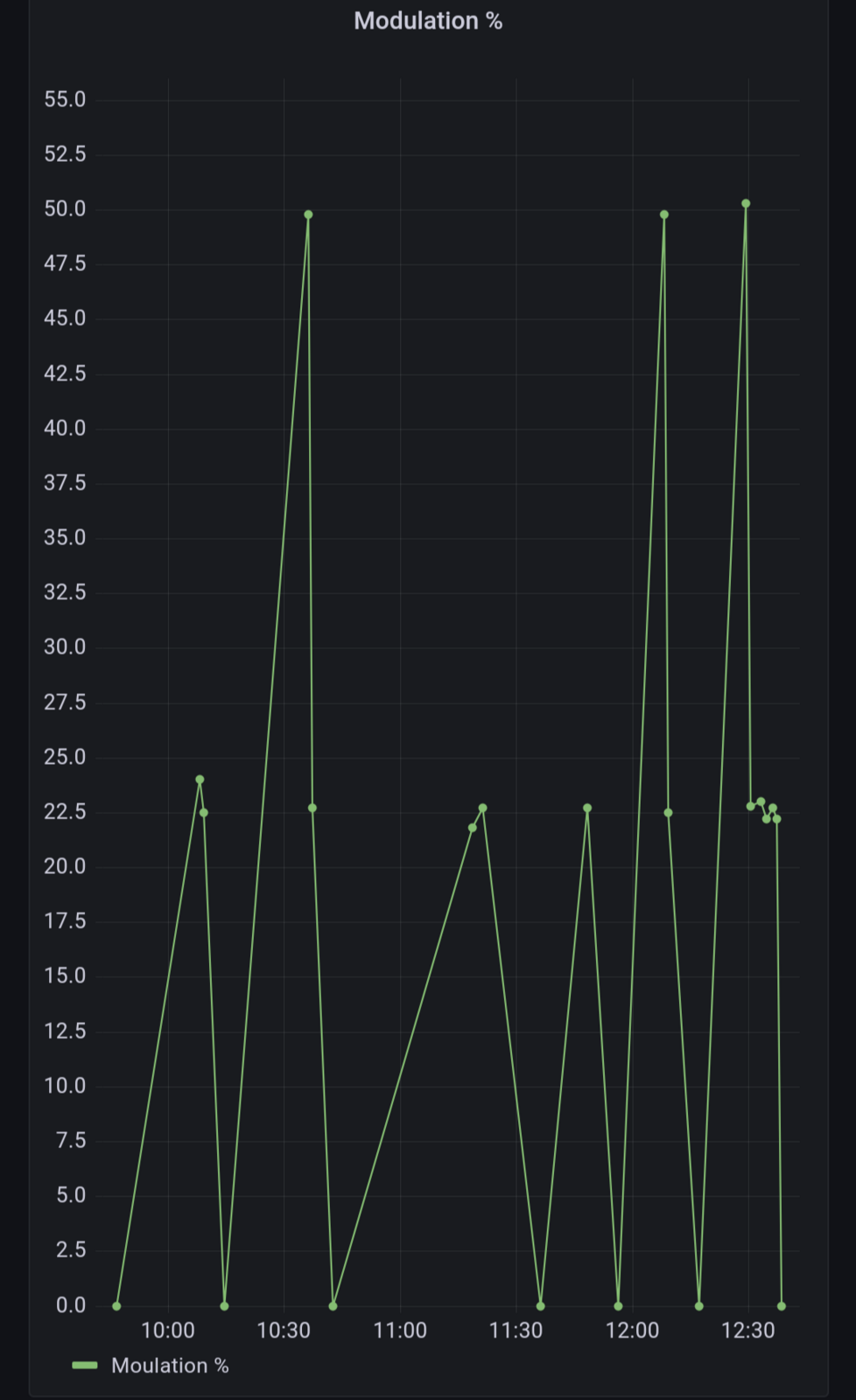

Last 3 hours of modulation attached.
I do think it's getting too hot as looking at my flow (supplied by the boiler rather from my sensors on the pipes also attached)
So what should I do to get it to run longer/modulate more?

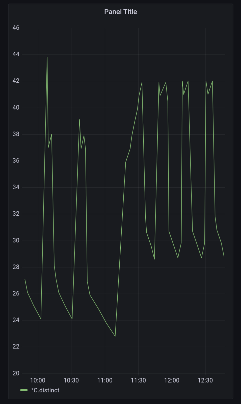

What is the second graph "C.distinct"?
In the OP did you say the boiler is range rated to 23%?
I don't understand the modulation graph. Is this downloaded from the boiler, or is it a plot of your own readings. Are the dots your own readings. This boiler should modulate down to about 6%, but it never seems to go under 23%. Is the modulation level the % of the full boiler output or the % of the range rated output.
C distinct is what the boiler is saying is flow temp
Yes range rated to 23 on basis that I only need less than 7kwh at -3
This modulation is from the boiler I assume it's 23% modulated of 100% so 77% output

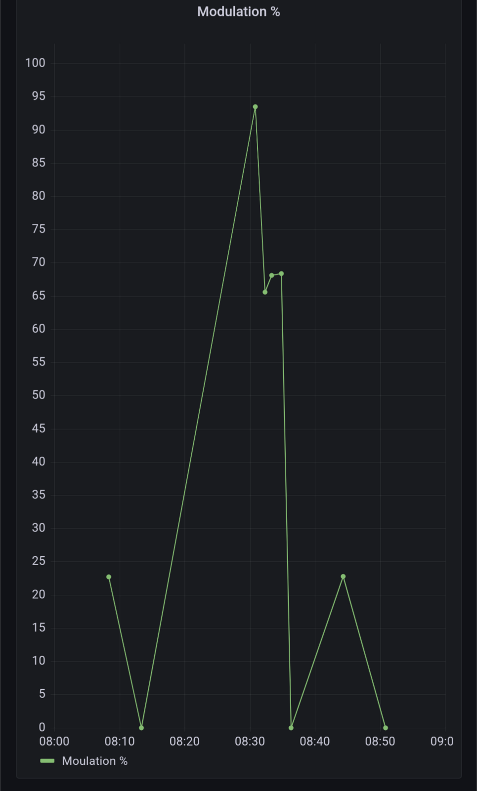

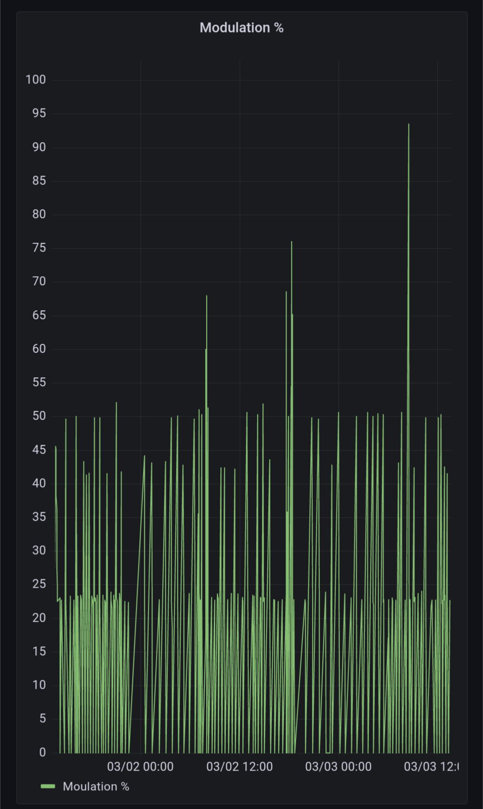

This the last 2 days since it's been actually "working,"
It got to 93.5 this morning
