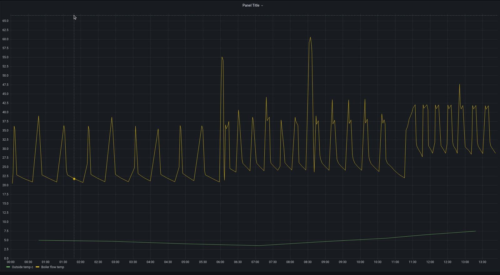

If you can note (or plot) the OT temperature and the flowtemperature at the time the burner trips then you can read the flowtemp SP off the curve and compare it to the trip temperature, if it is the 5C dT thats tripping the burner then maybe open up the rad valve flow contros.
Let me fire up the pc as I cant make graphs on the phone easily :)

there is flow and ot the 2 spikes are showers at 6 and 8:30
all valves set to their max now so lets see what happens ( i had put the set temp up to 19 but now im just too hot so ive had to put it down to 18 again :D
Above trend seems to show a temp overshoot of 1C to 2C when OT was 5C (SP 35C, flowtemps 36/37C) and up to 10C when OT was 7.3C (SP 32C, flowtemp 42C) so a bit inconclusive except monitoring is a bit sluggish, a overshoot of 2C/3C should IMO be quite normal and shouldn't cause burner trip.

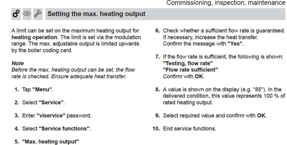

i suppose the biggest issue i have is the modulation why isnt it going really any higher than 23% surly if modulation went up burn time would extend to make up for it i think i have everything back as out of the box now setting wise

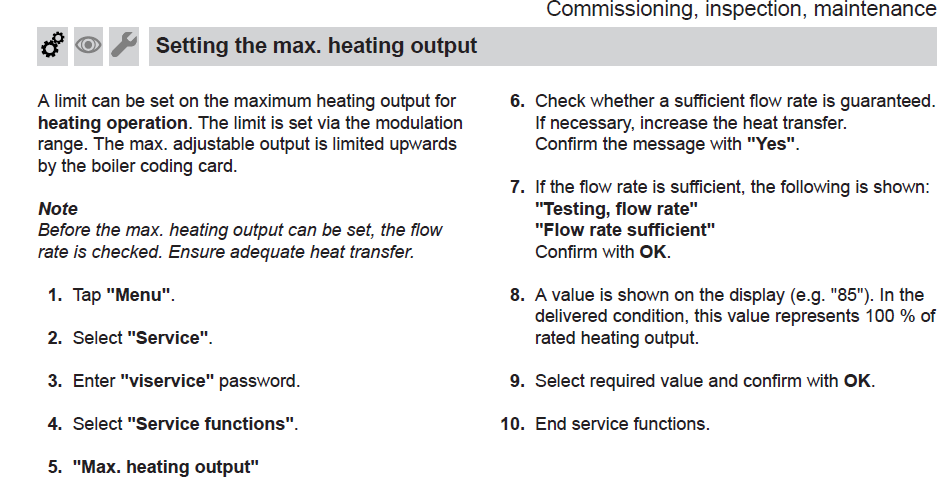

Have you checked this, the delivered condition is "85" which I presume is 27.2kw, (32*85%).
How many rads are on the system, the boiler will only output the rad demand, if only 7kw then it will only output 7kw.
I'm still not sure whether 23% modulation means 77% output or 23% output? You need to be absolutely certain that you have it the right way round.
It seems a bit coincidental that by far the most common modulation is 23%, which is the same value you have range rated the boiler at.

I would think that it's, Modulation, % Output, range rating only applies to CH so the 95% should mean 28.5kw output or 13.6LPM DHW flow at 40C.
