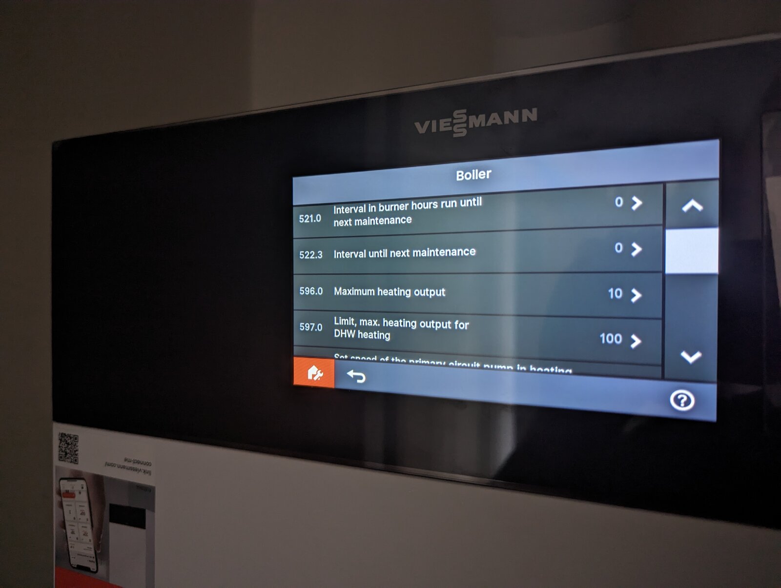

All I can see is set Max output as a %

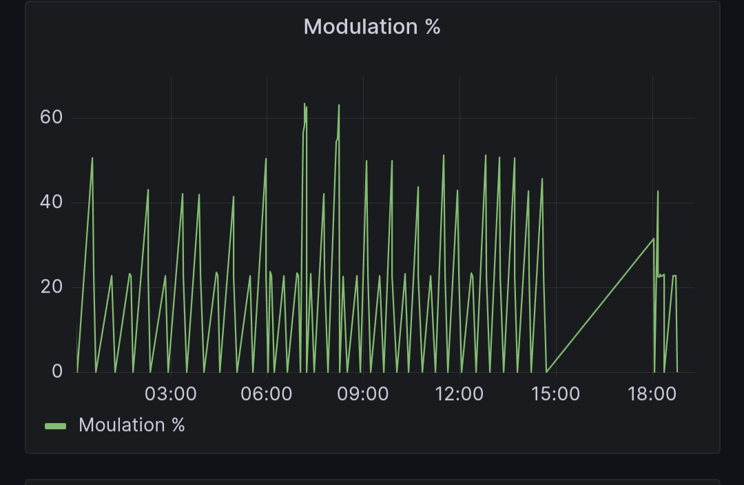

As far as I can tell when I see modulation 100% means no modulation I've seen it when using dhw some times

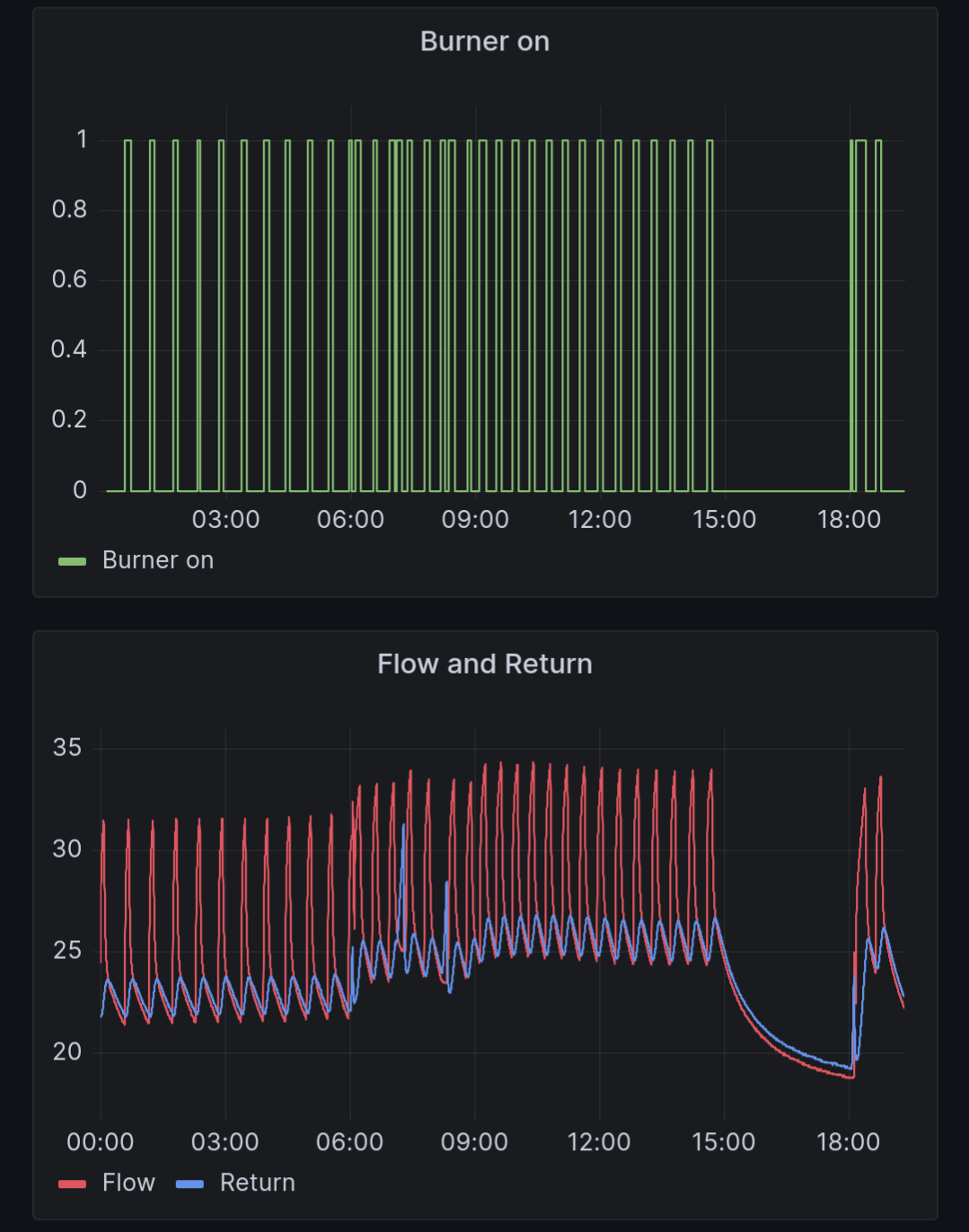

This is today's modulation history so 19 hours and the burn times
What does the Y axis represent on the burner on graph?
There seems a 9⁰C ∆T on F&R which o think is good on a low temp system.

The burner on periods are very low compared to the off periods, looks like the flowtemp shoots up to SP+trip hysteresis and then takes a long time to get the flowtemp down enough to refire the boiler so must be using a very low flowrate (if no anticycle).
Post #41 "There is no anti-cycle delay nor heating after hot water delay, it fires on demand." maybe there is one on CH?.
I might have remembered past post badly. There may be an anti-cycle delay but it is not adjustable as on other boilers.
The timeline is jolly annoying when trying to attribute a time to an occurrence, if I were a Viessmann installer I'd write and ask for a datum pointer at the three hourly period.
Interesting the return spikes when I've assumed a shower is run at 7 and 8 but the flow does not.
If I've read it correctly during the 15 hours or 900 minutes up till 3pm the boiler fired 35 times, the majority of the times at 23% modulation never once out of condensing mode.

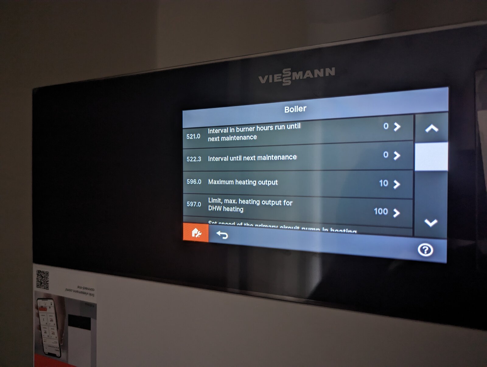

Max output at 10% has made no difference to modulation amount really and burn time is up slightly first one was 10 minutes the next was down to 8
10% output should be either 3.2kw or 2.7kw if the max CH output is 85% of HW output.
I would monitor the gas meter for that 1 minute, you should get between 0.004 and 0.005m3 consumption.

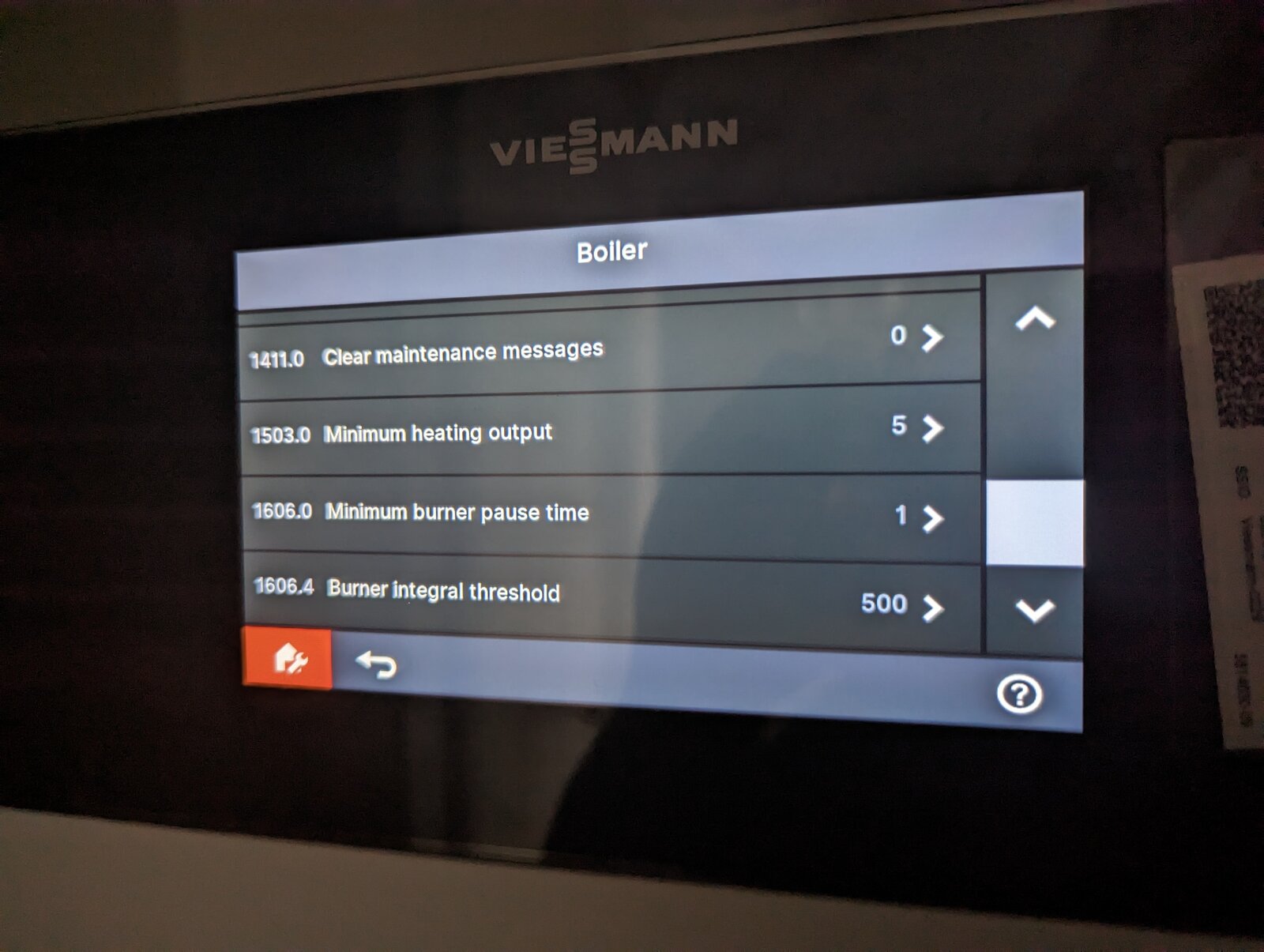

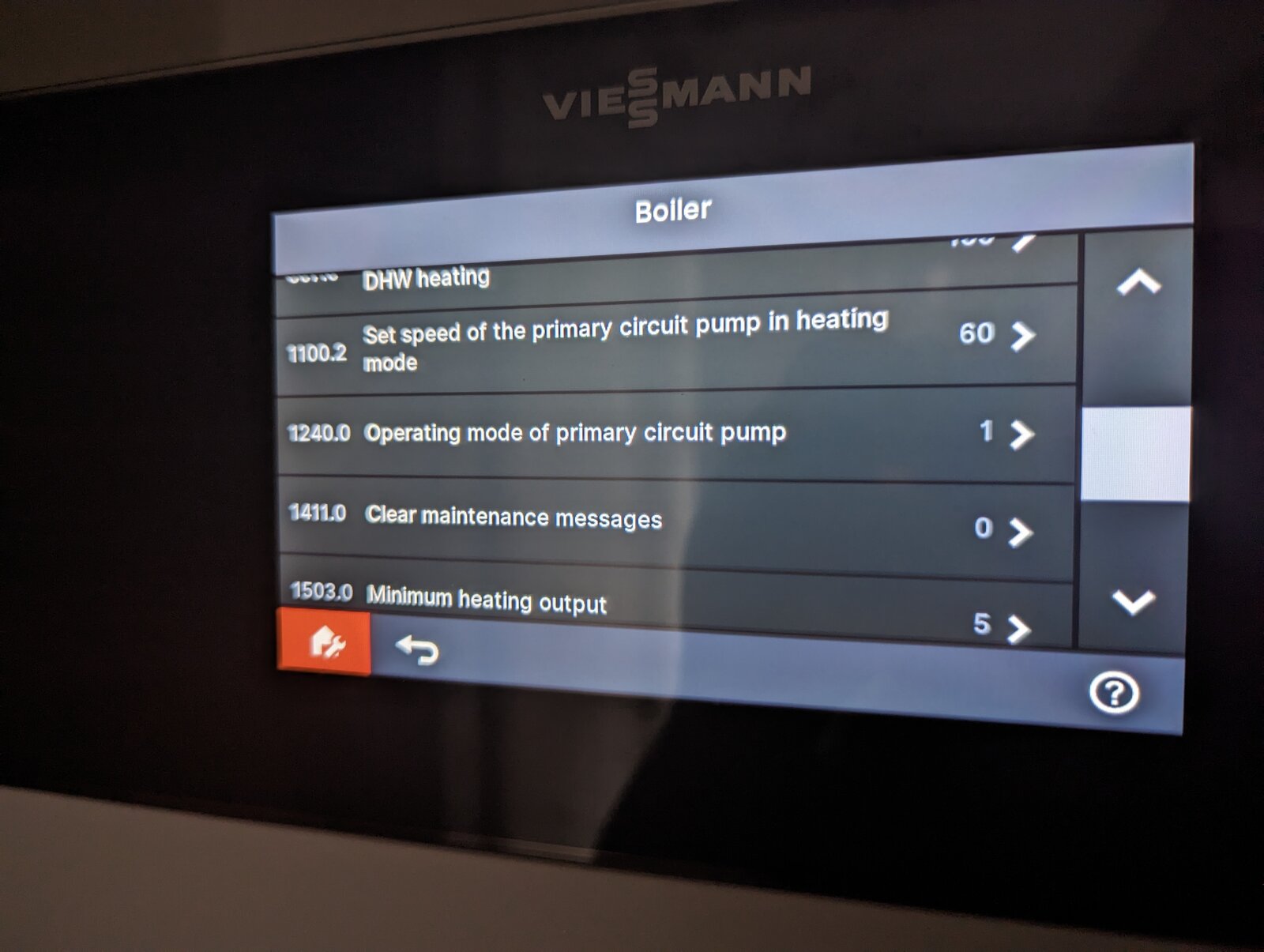

The final throw of the dice is maybe to reduce the modulation to 0% (if settable), this then should give that elusive minimum output of ~ 2.0kw?.

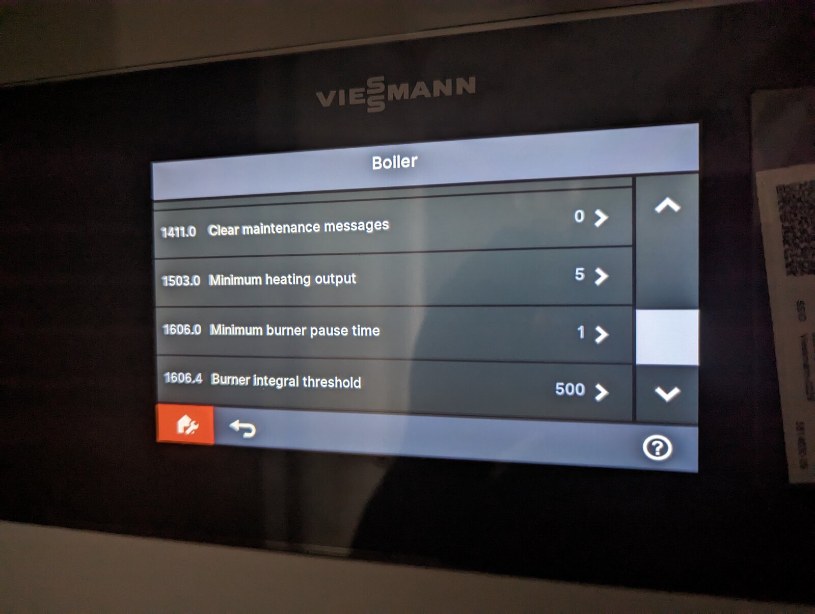

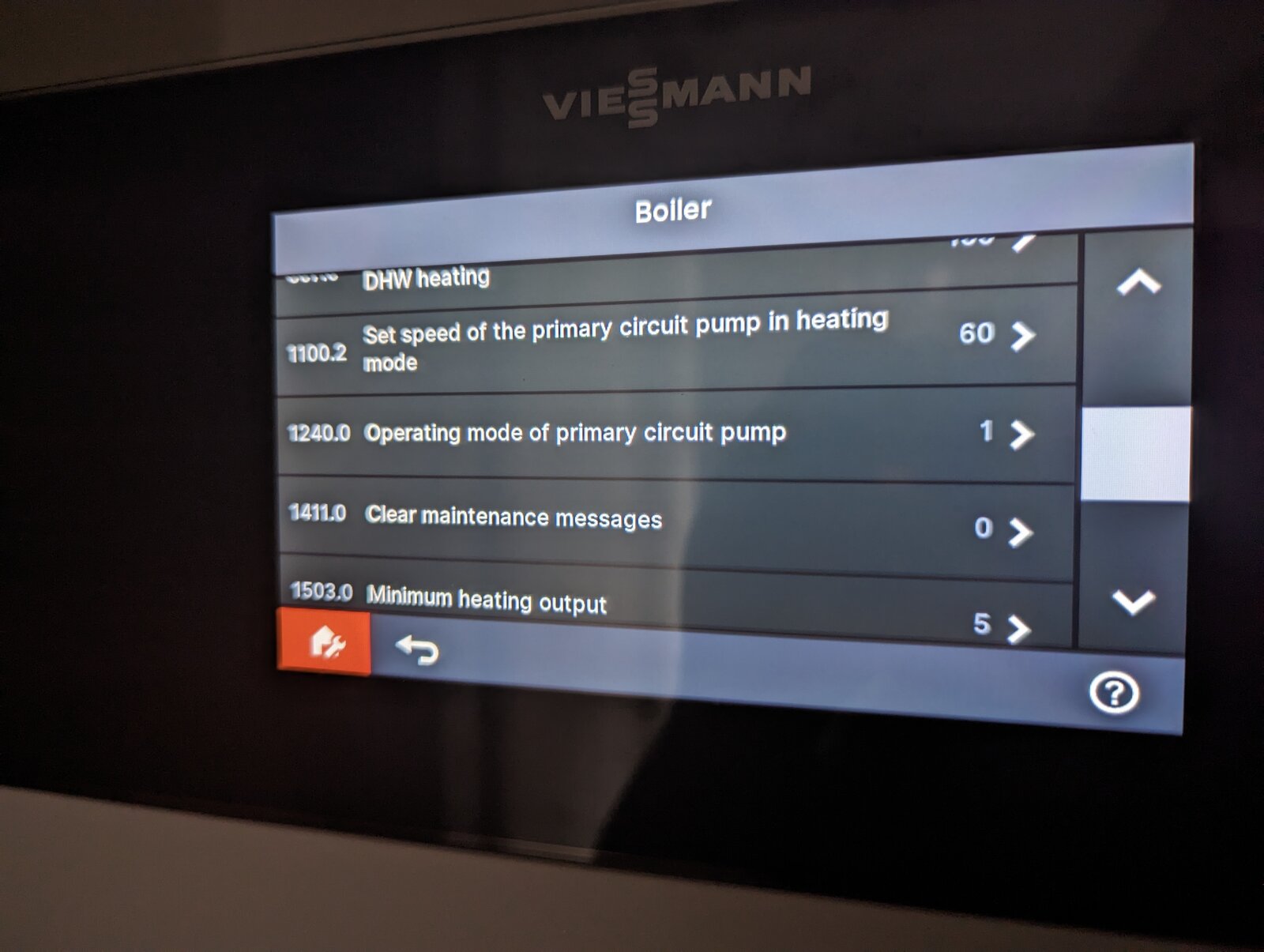

One display above shows Minimum Heating output 5, what does this mean?.
I can't change 5 down only up so I imagine 5% is the fabled 1.8kwh even though 5% of 32 us 1.6
