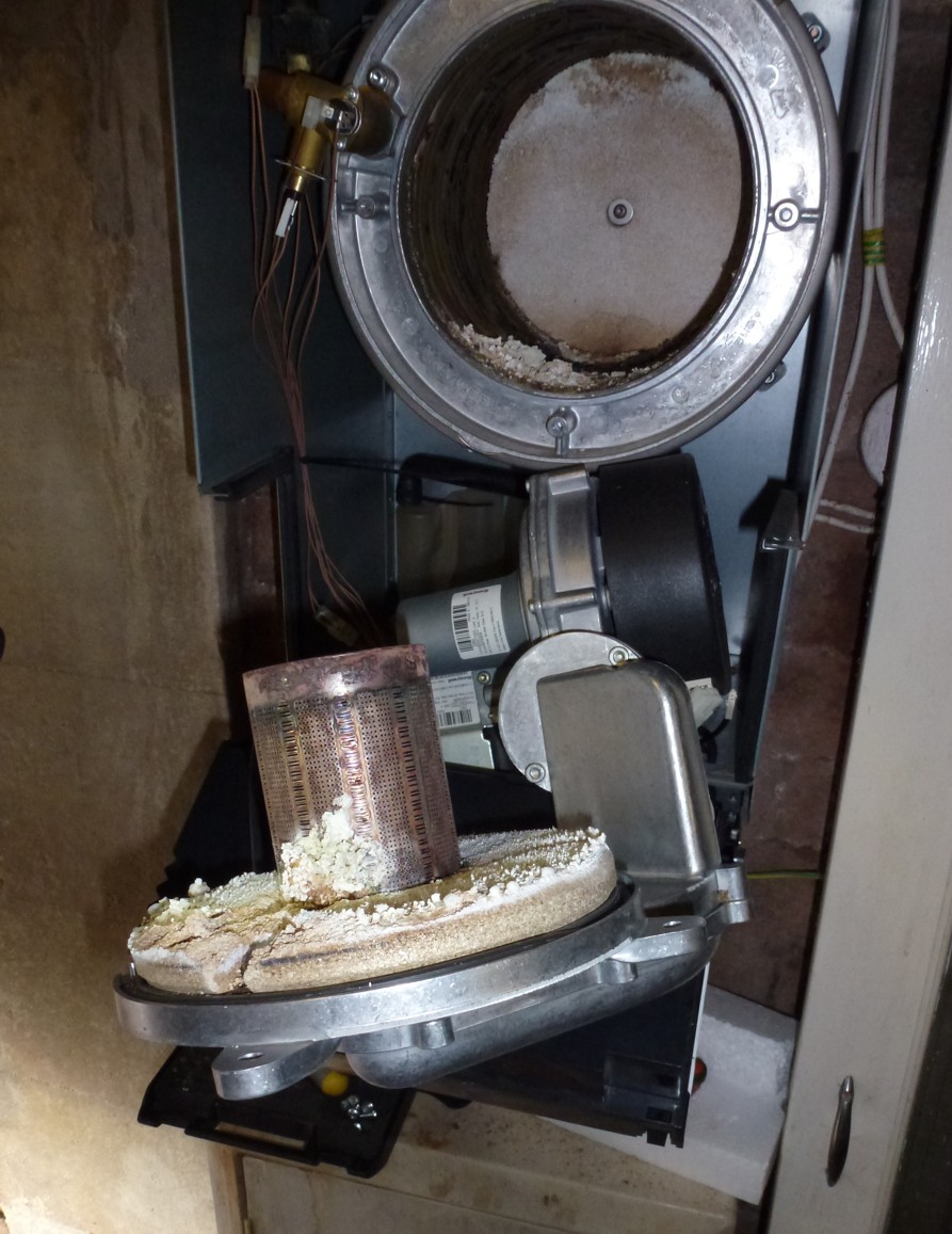

I know there is a fix for this. My boiler is nearly 10 years old and I have seen this perhaps 5 times over this period. Just pressing the reset has always cured it. It happened 2 days ago, and a reset cured it. It happened again today but a reset did not cure it. However, I switched power off and on again, left it trying to start for a few minutes and it is going again.
My question is whether this failure is now likely to get more frequent, needing a call out to get it fixed. If it is likely to settle back to the same failure rate with a simple reset cure, I will not bother.

Today, after having another F5, I called out a Viessmann recommended RGI - a good one! He fixed the flap (referred to as 'mixture damper' in the service manual) in the normal way, being quite familiar with the problem. He took a photo when he opened the burner, because this is what he found:
He thought I should send this picture to the previous guy who serviced it 3 weeks ago and ask for my money back. That guy had told me it was not necessary to open the burner. The new guy said that opening and cleaning the burner - and checking the flap - should be routine servicing for this boiler.

I find it hard to imagine that the gas analysis was within the spec with that amount of dirt inside.

There was some sort of seal on the gas supply that the RGI said he had opened for the first time, indicating that the boiler had not been properly serviced since new (10 years) The boiler would not have been opened for at least 6 years. I don't know the flue gas readings from the other guy's service a few weeks ago. They are probably on his inspection sheet, but I don't have that with me.
The RGI said that the burner and stone (I forget what he called them) parts have not got much life left in them and would need replacing soon. I will ask him to do that at the next service. He did say that the boiler sounded OK without any kettling. I asked him about flushing the HE to remove possible deposits but he thought that was probably not necessary.

I'd have thought you could probably bu99er around with the gas valve enough to bring it back in again Tony. That's probably why the original "service" took 45 minutes - the monkey doing it was adjusting the GV to bring it back into range

The problem with a pile up of dirt like that is that it causes differential heating of the HE coil which is not very good for it.
