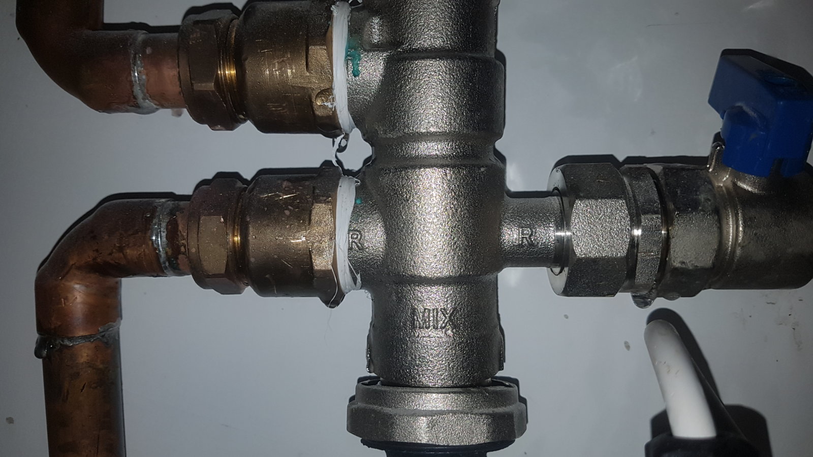

Vitodens 100 boiler - bar 0.6 error

Only one not leaking is the bottom right union. No washer in the top right service valve (out of shot fur those not in the know).

Thanks for all the advice guys, managed to get it up to 1.5 which was good but then 2 days later it dropped to 0!!!
No leaks found or any other issue???
We then upped to it 2.3 and its been fine, is it safe at 2.3 or does it need knocking down to 1.5 again (just afraid it'll drop to 0 again)
No, we were aiming for 1.5 but overshot and decided to leave it expecting it to drop to 0 but it hasn't since so now wondering can we leave it there or we drop it down to 1.5???
