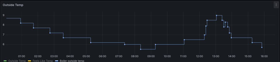

Are there any trends out there showing the "room" temperature plotted against the OT temperature from people who are happy (apart from you?) with WC only control , NO roomstat.
dunno :D
ive just adjusted my curve and throttled my rads to see if i can get a better return temp as last night as event though it got down to 1c with it trying to maintain 13c we still woke to lowest temp being 17.5c
Even though I have a room stat, effectively I am still running on WC only, the only difference being the boiler is off overnight as the temperature in the house is normally warm enough, last night it was 18.5 deg with OT of 1 deg so boiler doesn't kick in. During the day the room stat doesn't do anything as it's set above the highest temp that the room gets to (20 deg).
