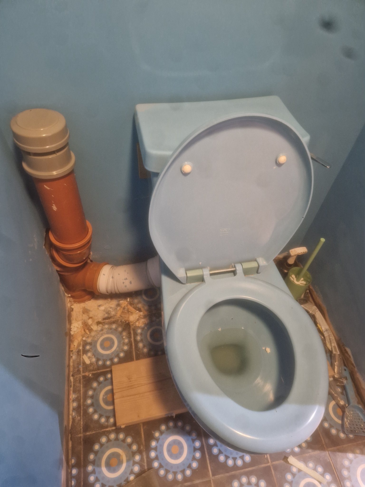

Vintage toilet - not draining quickly
Has the look of a siphonic to me. There were a couple of designs. They're "clever" but more likely to block than a washdown
The bottom T is the right way round.

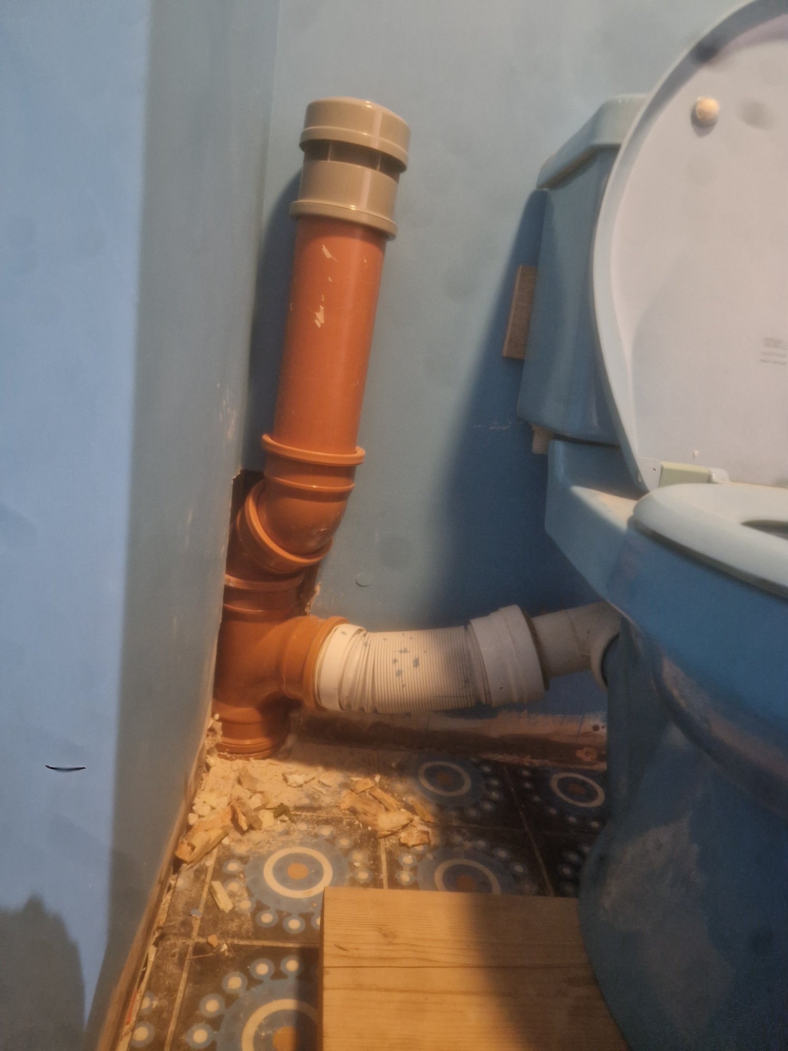

Thanks everyone. I've replaced the section of pipe up to the AAV with a longer pipe and it's still the same. I'll show a picture. It's a single storey property and nothing higher than this. It's the same when I take the durgo cap off completely.
This is a new build property- there's no problem with the pipework, it's all been inspected and all clear as far as I can see.
The toilet was second hand, but bought for the colour and the vintage look my partner was wanting for this room.. so there was no toilet here beforehand to replace it with!

The behaviour you describe is common with a syphonic WC that lacks the special valve. Take some photos of the pan from the side and the shape of the waterway may be visible
But yes, I agree, pull the Durgo off.

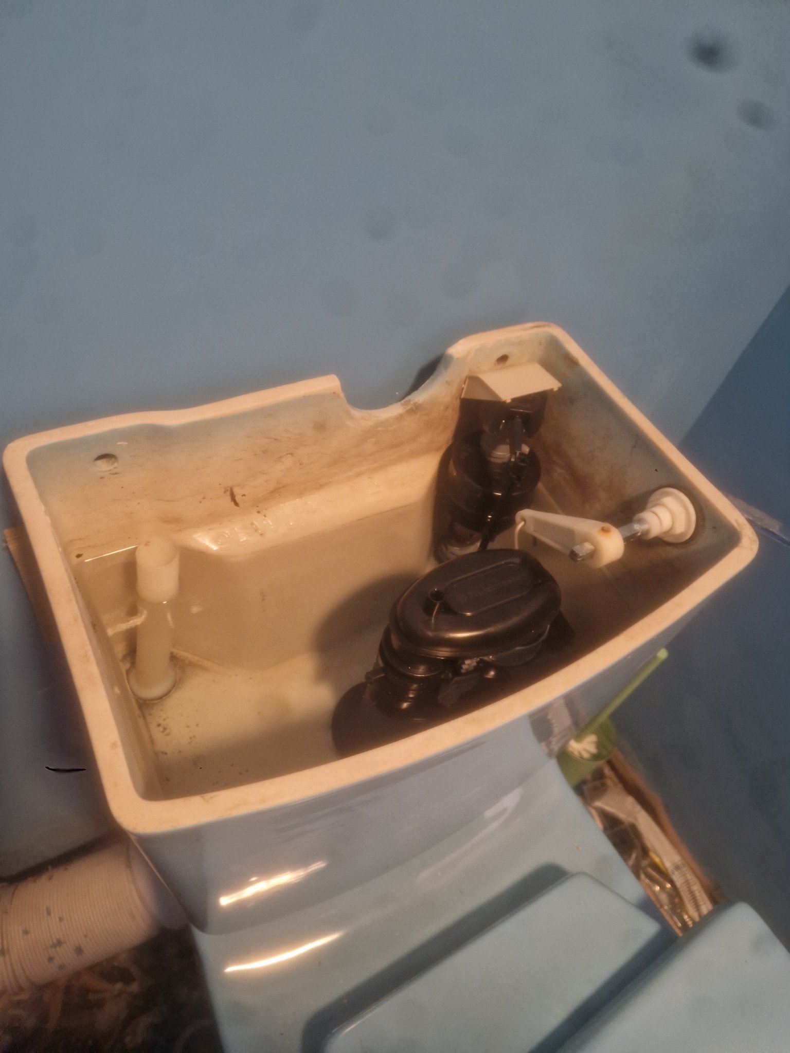

Does this picture help?
Are you talking about the siphon inside the cistern, or the shape of the p/s-trap underneath? I've googled and there's a suggestion that the problem may be the speed with which the water can fill the pan from above. I've put brand new kit inside the cistern so should be all ok, and there's no obvious limescale buildup or blockages in the holes that fill the pan up.

Quick search on google found this with a good pic:
I 'm not sure I can give you a clean link to the top of the thread...
Copy and paste this
Code:
https://www.diynot.com/diy/threads/double-trap-siphonic-pan-help-needed.389820/#post-2997763
The idea was that the lower trap is filled by the flush water, it overflows in a siphon way and that PULLS the stuff out of the top part of the pan.
Or a variant of that.
I don't like them, they leave stuff unwashed-down, and the valve at A gives bother.
