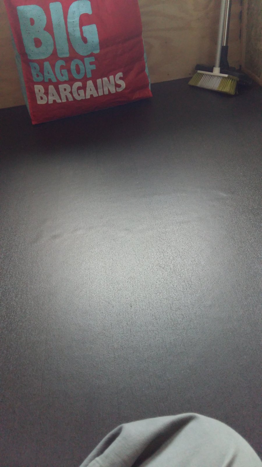

Had polyflor safety flooring laid today. Good job the way it's been finished but it has a lumpy thing going on. To the feel it' subtle but when you loo across it the light catches it. It was finished about 4 hrs ago. Will this go or is it f*ked?
Cheers

All depends on what adhesive they used. Give it 48 hrs and see what’s its like
Would you put a flat board over the ripples and put heavy weight on it or should I just leave it?
Should I tell the shop who fitted it now or leave it your 48hr. Ie if I tell them in 48hr will it be too late and they'll say oh I wish you'd told us sooner so we could have done something about it.
I would go back to the shop NOW and tell them your not happy. As you say leave it 48 hours and they could well, and probably will, say tough.
