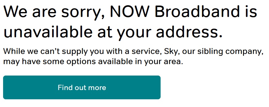

It's £22 on their website. This is the best ongoing price I've seen, but I can't get their service as they only operate from exchanges that have Sky's equipment installed, usually towns...
Switching between ADSL/VDSL ISPs is very easy once you have your own modem, it's a non-task. You don't even need to cancel the old one, it gets done automatically. I got my "Sorry you're leaving" email from the old one about half an hour after applying to the new one, and the switch will be two weeks later.
Which would logically mean that you can't get Sky at your address either, I'd surmise.
I haven't tried applying. But I did look into Vodafone. They do have their own equipment in exchanges, again only covering some areas. But they will still accept customers from other areas, in which case they use BT's equipment, basically re-selling BT's wholesale service.
It's possible that Sky do something similar, so probably charge more than Now to cover this extra cost. Now offer a low priced service so they need to keep their overheads as low as possible.
