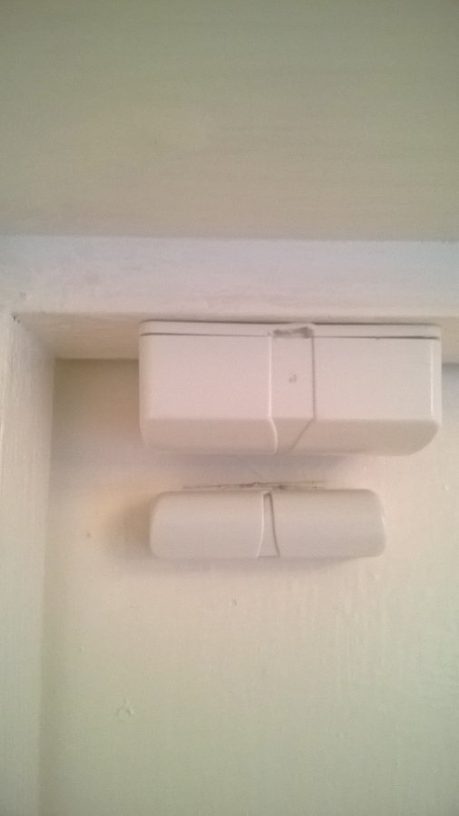

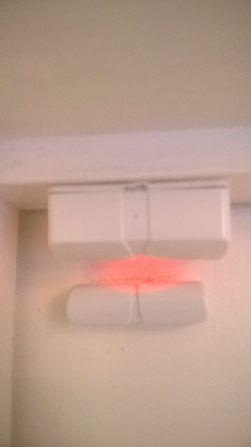

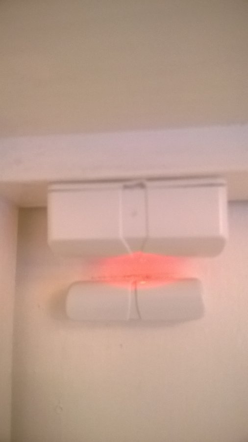

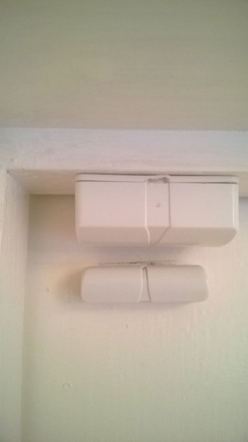

Hi I've managed to uninstall and reinstall a PIR thank you but it doesn't want to recognise the contact sensor! I've tried both opening and closing the door when it says transmit on zone 4 but it doesn't register it. I've posted a couple of pics as requested. Thanks for your help.

Have tried taking contact of frame and put magnet directly next to contact ?
Gap between contact and magnet could be too great ?
Possible faulty contact ?
Yeah thanks, have tried with both off and putting at various closer distances. I wonder if the magnet could be damaged but then I wonder why it flashes when they come together?!
Thank you very much for trying to help.
The magnet will not be damaged,more likely the contact is faulty.
You could look on eBay for a cheap replacement and the try with new contact or get the company back that fitted it to sort out.You would be charged for that.
