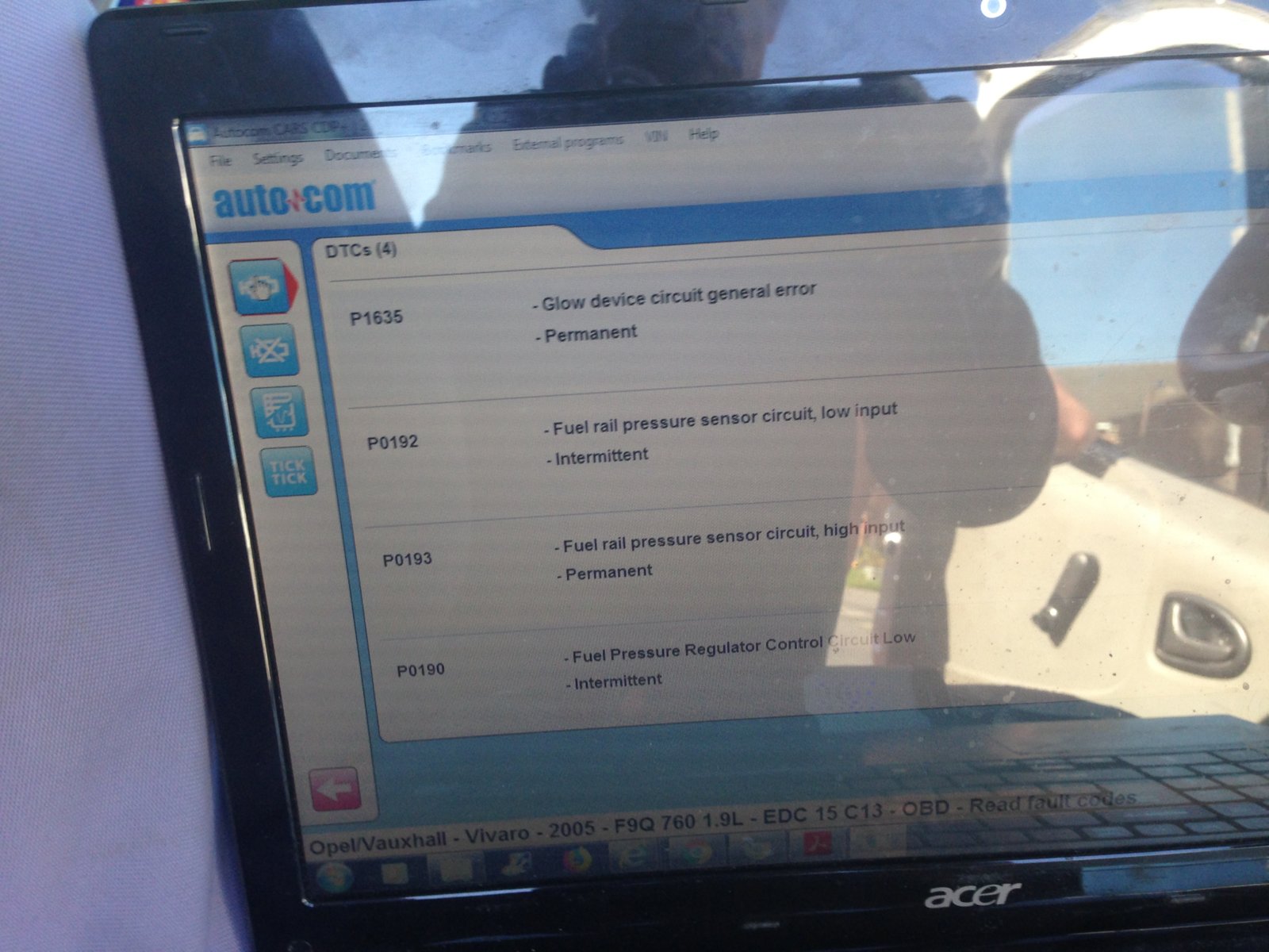

Hi I have a vivaro 2005 1.9 dti which cut out on a few days ago. Have these fault codes any info very welcome.
I would suggest that you have the main fuel injection pump checked, Arthur - it would seem to be unable to continuously deliver the high pressures required.
The first DTC indicates a glowplug problem, but the two may well be related.
F9Q - I think this is a Renault sourced engine.
