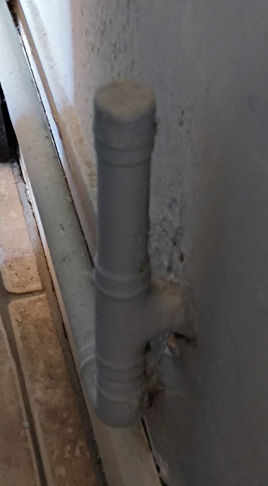

Hi everyone. Having a new kitchen fitted soon where we'll be getting an integrated 50/50 fridge freezer.
Just noticed what I think might be the main gas pipe to the boiler sticking out about 40 mm from the wall, exactly where the fridge freezer will be. If we cut a hole in the cabinet, just a regular 60 deep, 216 tall one, will we be ok? Most fridge freezers seem to be about 545-550 deep, so I think I might be ok. Can anyone offer any advice?
I've attached a picture.
Thanks everyone

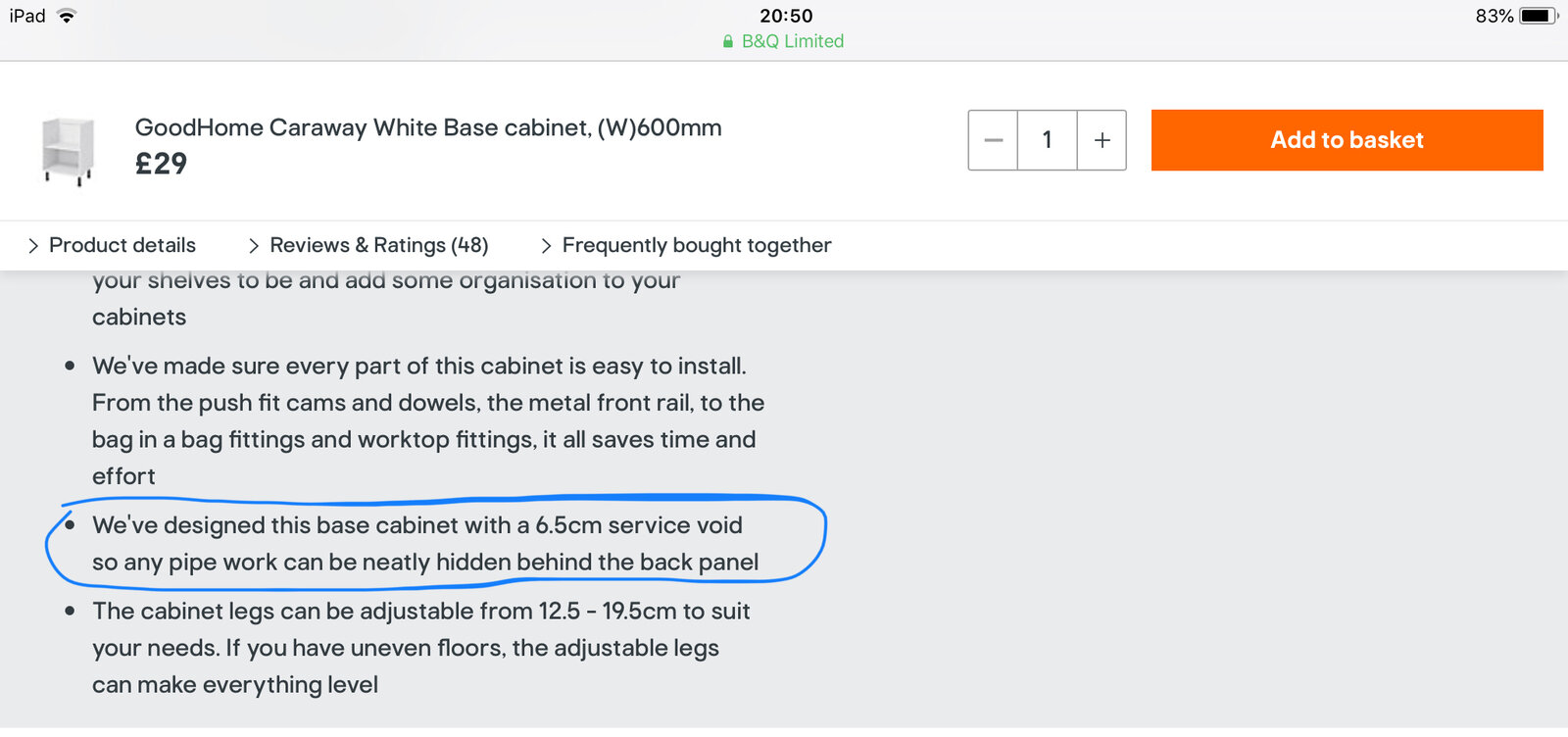

Iirc kitchen units generally have a gap behind anyway, some are 50mm. Probably best finding out that first?

Just measured mine:
Unit depth 570mm
Back panel not fitted for appliances for ventilation.
Otherwise service void of 65mm on all base and tall units.
