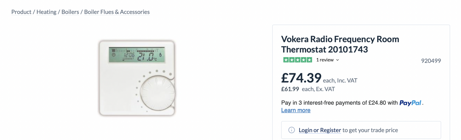

Hi Adrian, I appreciate this was 4yrs ago, but I've bought a Vokera 7 day programmer (Vokera Radio Frequency Room Thermostat 20101743) and it has a plug on the end of the cable, there's nowhere that we can see to fit this. Vokera said the model was compatible. Which RF programmer did you buy/use? And where did you find instructions on fitting? Thanks :)

Hi - as per the forum rules, can I suggest you start a new post rather than resurrecting an old one then just link back to this one as the subject - just avoids confusion when the original post has already been answered. If you also add in what model of boiler (vokera) you have. If it's an easy heat then the plug is usually connected to the analogue clock if it had one, depends on how old an easi heat it is tho.
