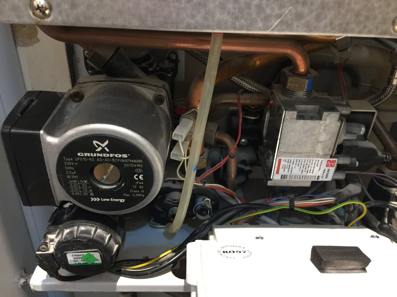

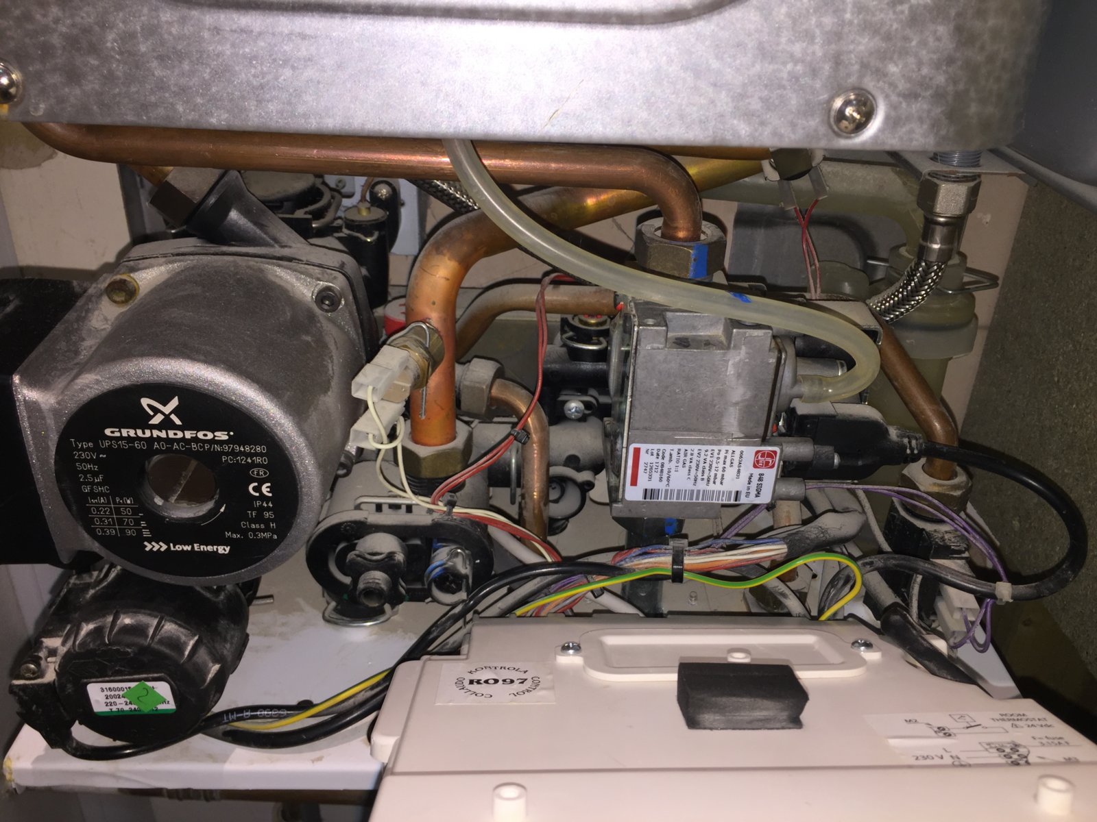

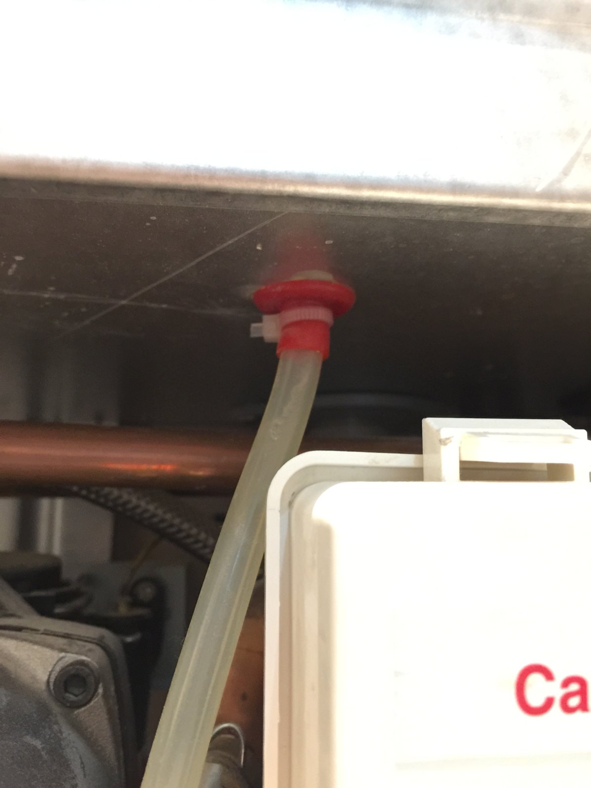

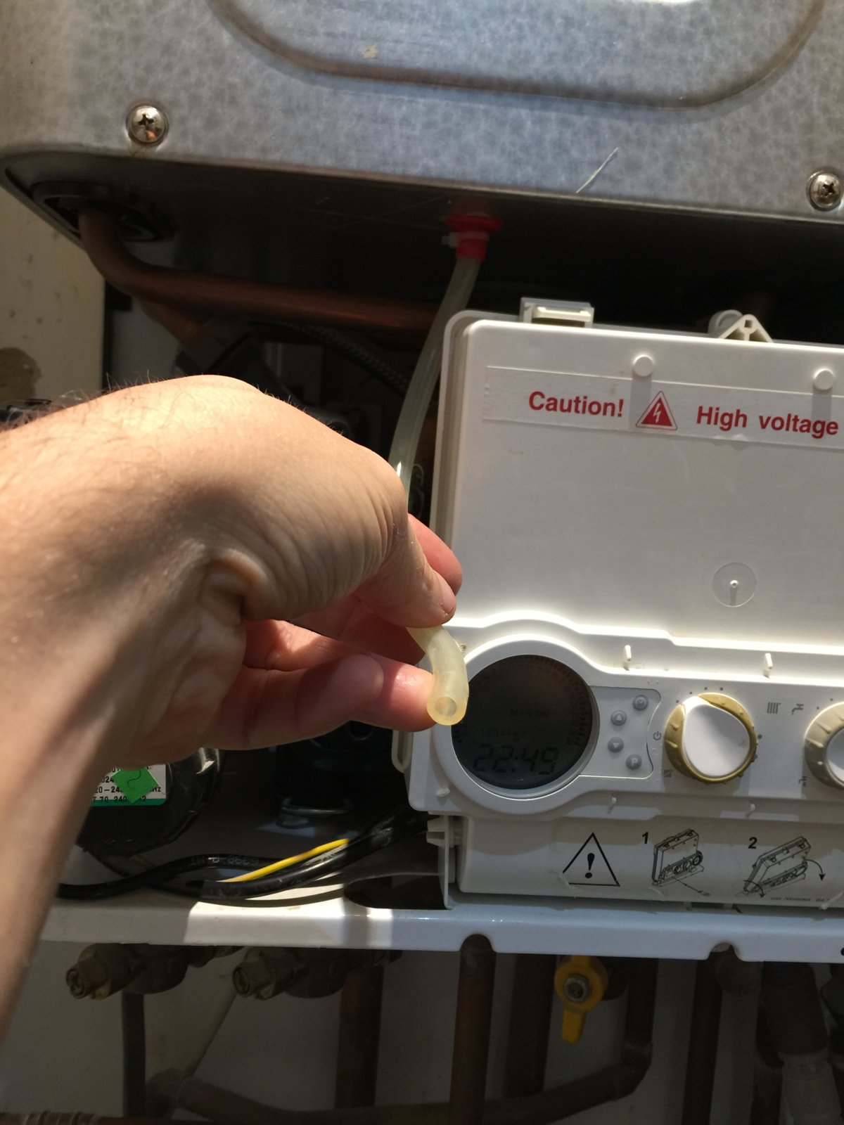

One quick question I took photos upon opening the boiler - before I had touched anything. Whats the rubber tube that appears to be hanging around for (see pictures)?
??? Its bone dry and was there when I opened it. Boiler works fine???
Thanks... What is it? What does it do???
I take it that is the left hole in the photo below? Does it matter that it seems to have been disconnected for ages?
The one on the left here?
no it goes onto the top spigot on the gas valve, the silver thing to the right of where you were talking about, it is the fan pressure compensation tube it tells the gas valve what pressure is in the combustion chamber.
Thanks for that... I've hunted through the instructions and cannot find this.

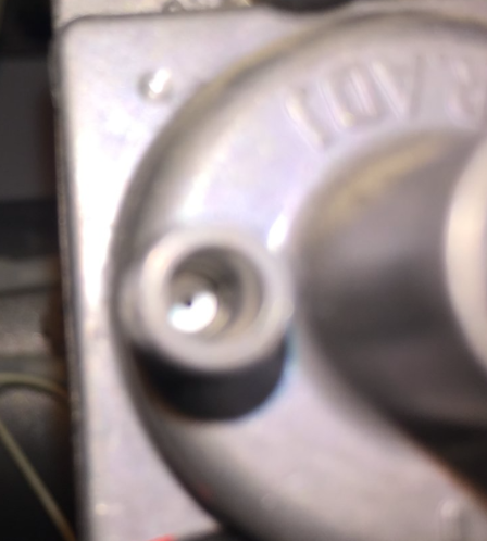

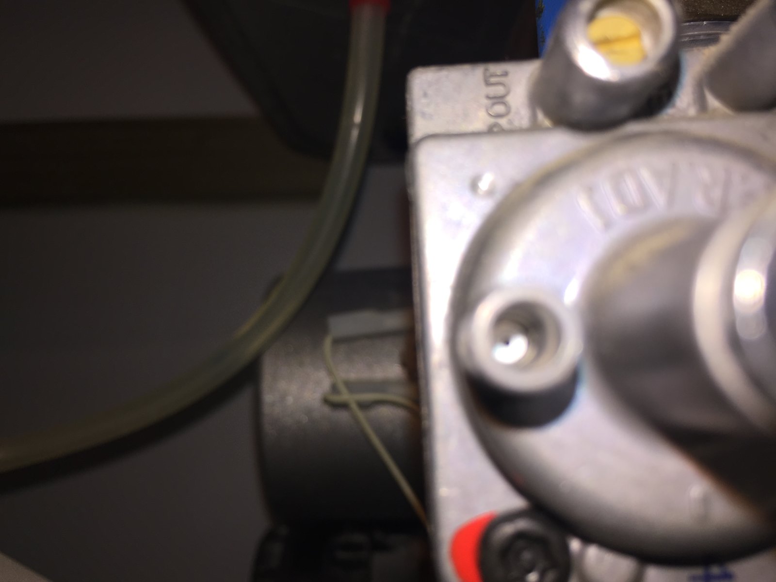

It now looks like the photo below. I have connected it to the only projecting metal that does not house a brass/copper looking screw.
At the base of the projecting metal stalk it is attached too is a metal looking pinhole surrounded by white plastic. Furthermore the tube seemed to seat there nicely.
This look right?
Here is what the inside of the tube - that it is connected too looks like... Still (even with the name) cannot find reference to this in the manual (linked above)...
Thanks Ian, your a legend...
So I now have it connected to the port, with the tiny hole, surrounded by white in the photo below:
That is the correct one, you wont really notice much difference to be honest, but your boiler will work slightly more efficient
