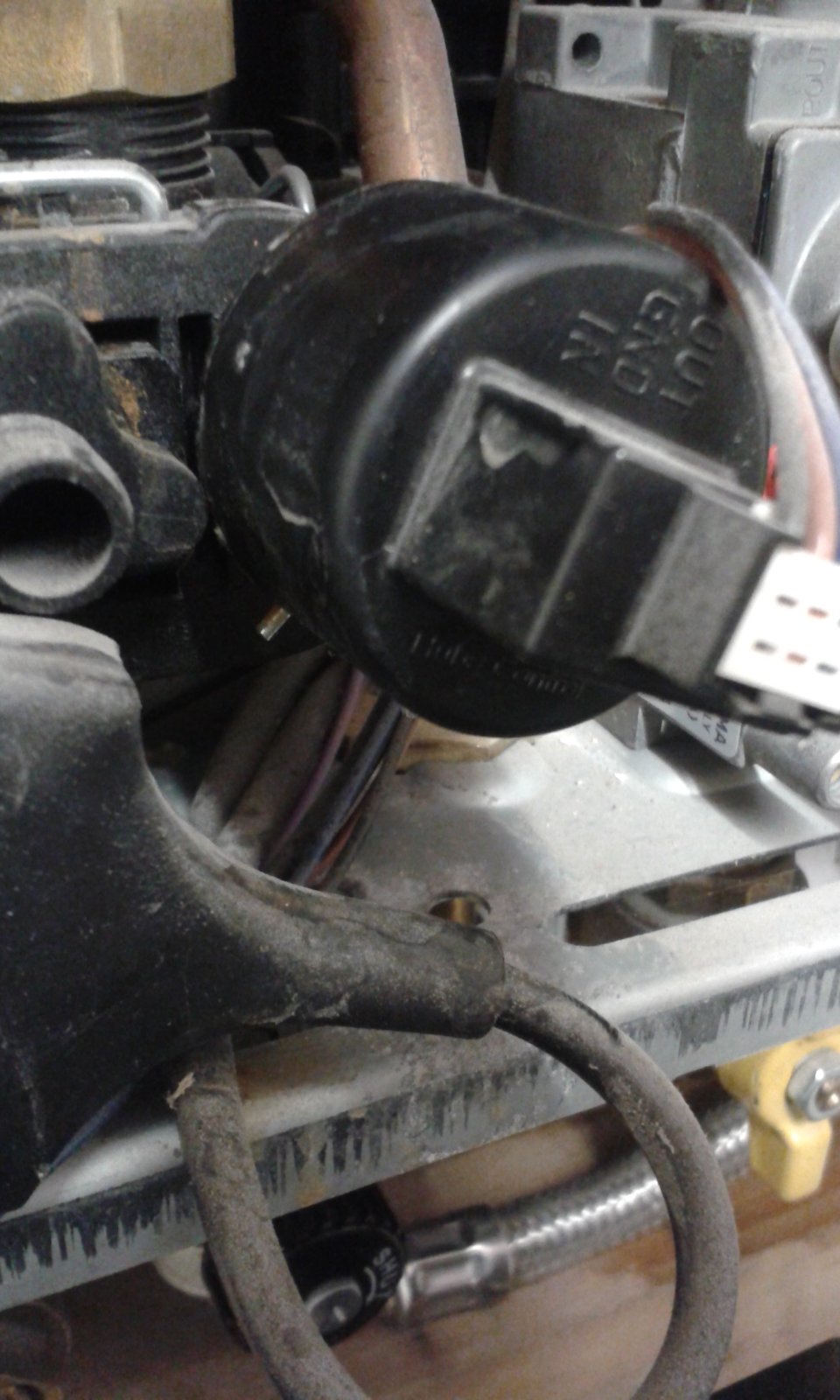

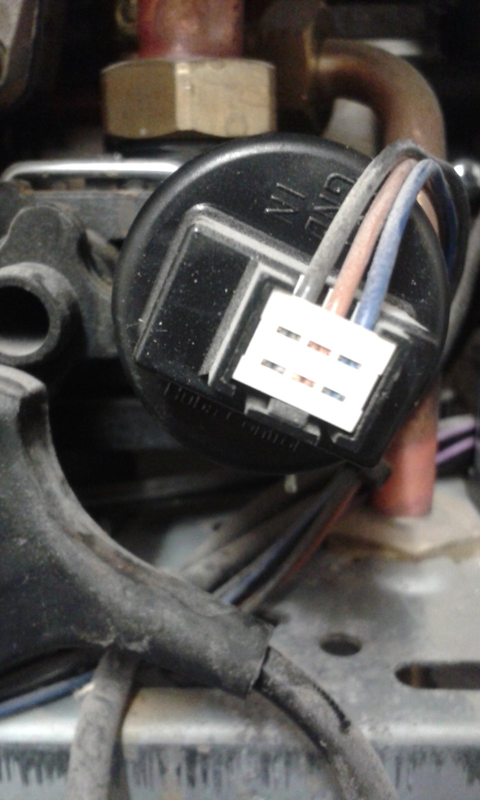

hello,
I am getting an intermittant leak around the pressure sensor from the back of it (i think, i attached pictures). The leak started during recent cold weather. It leaks during the night when no heating is on, but not generally when the heating is on. I also got it to start by setting the water pressure quite high when cold (> 2 bar) (but not to operate the safety valve.
I am presuming that there is a diaphram to operate it (i can't see clearly on the manual how this all works) and this is leaking. How easy is this to change/fix. I can see some springy pins that holds the sensor and a pin on the manifold behind. If i take these out will it come apart easily ?

Difficult to see from the photographs. Always look above the stain as there appears to be a mark on the front housing. If it is the pressure transducer it's an easy swap after draining the water from the boiler. Drain off to the left of the sensor.
it looks like it is leaking around the joint between the sensor and the non-return manifold.
I assume this is an O ring that has failed.

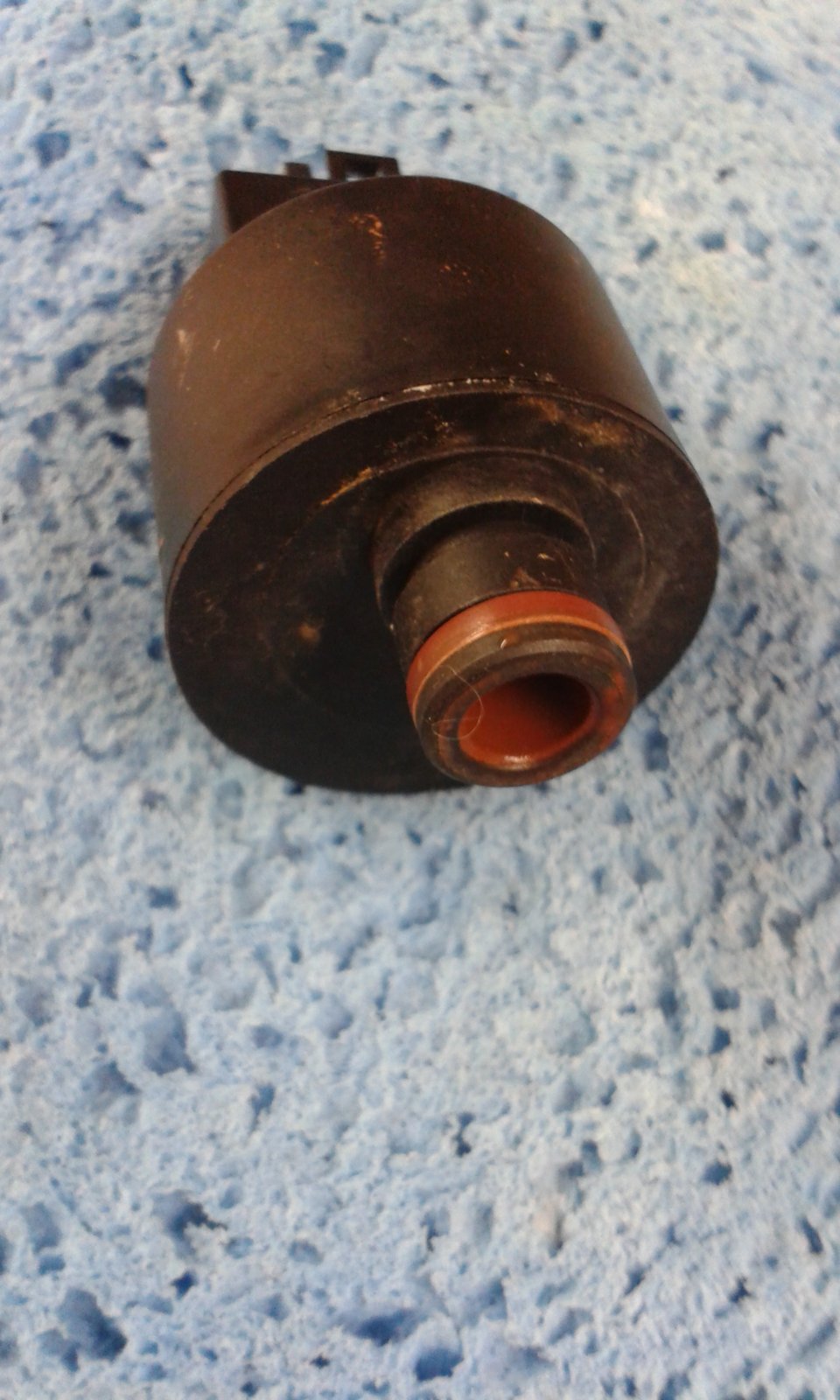

Just a follow up. I tried to locate the o ring part on the sensor - apparently not listed. I was not going to buy a new sensor (£18) for the sake of an o ring. So decided to take pot luck using an assorted O ring selection box.
1) isolated supply, drained boiler.
2) Pulled out the split pin.
3) pulled out the sensor.
4) removed electronics connector.

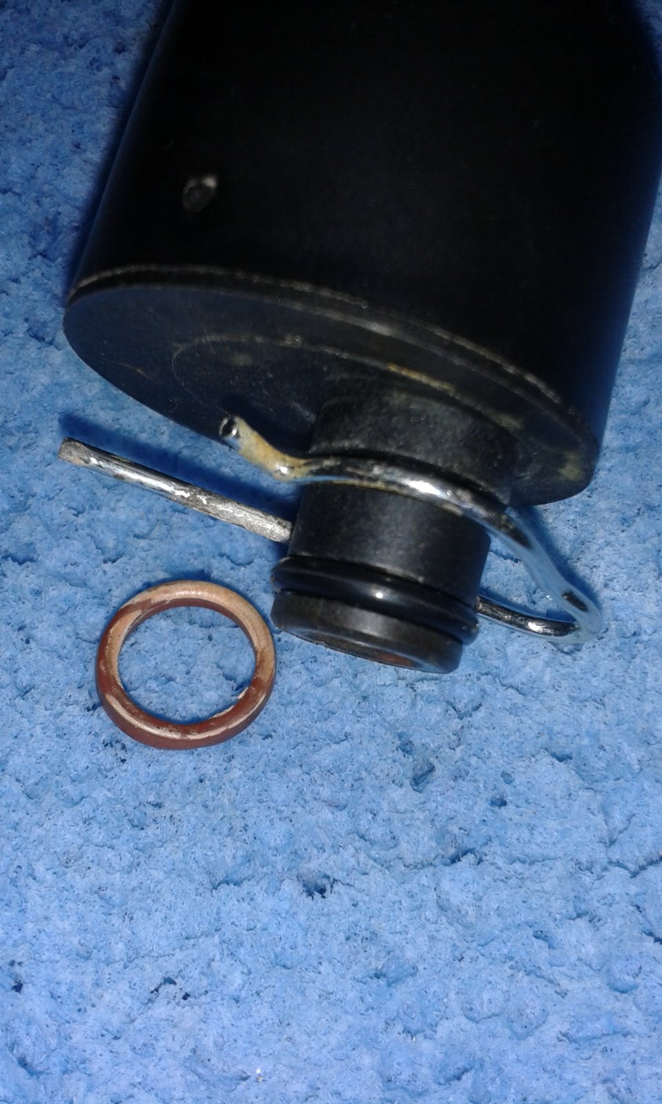

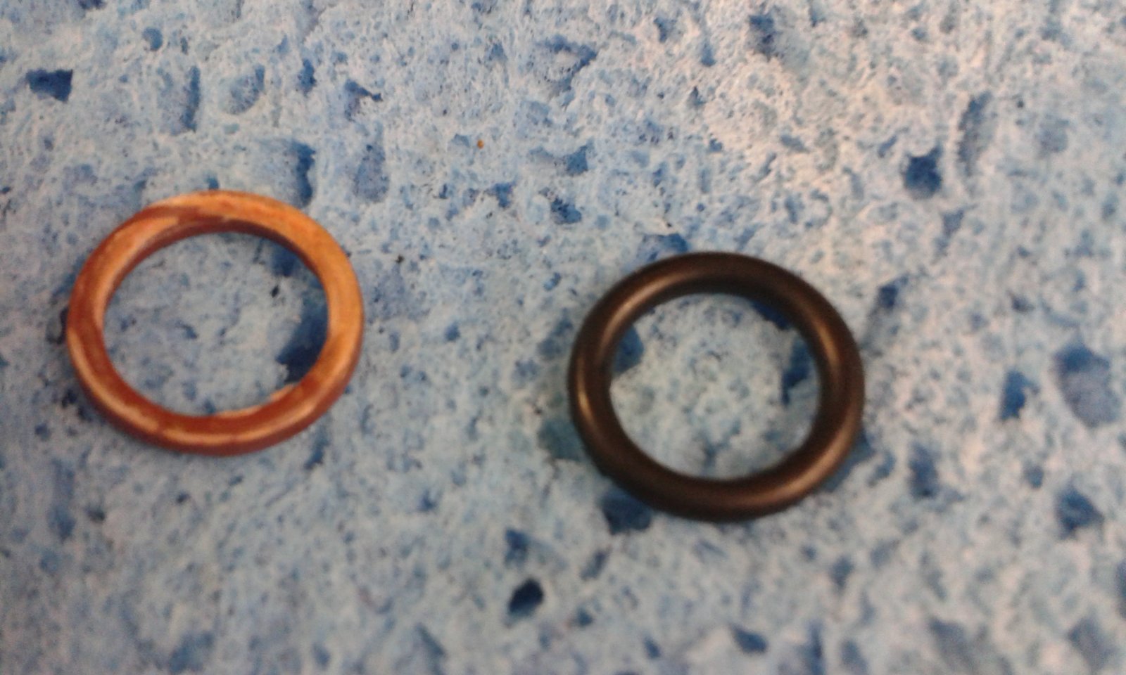

The attached pictures show the state of the o ring. It was not broken but flattened and perished looking.
Found a replacement O ring 8mm x 2mm. The new and old are shown
5) replaced new o ring on sensor, cleaning up gunk.

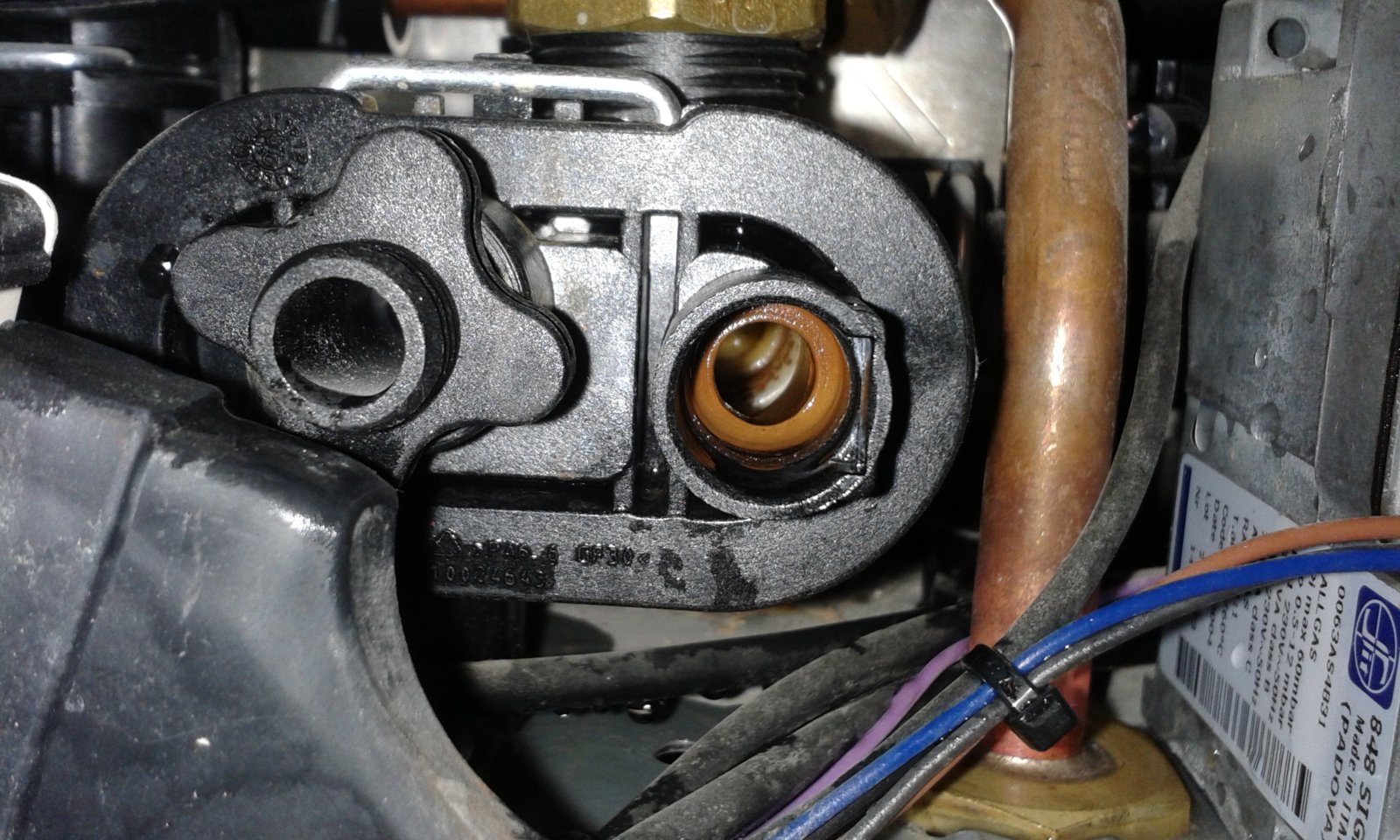

6) cleaned up the boiler end.
7) quick spray of silicone
8) Pushed the part back in with a satisfactory thud as it located. It initially feels loose and a good amount of pressure is required to push it home and allow the split pin to be inserted.
9) Replaced the split pin. Only one side of the clip holds the component in place the other side holds the clip in place.
