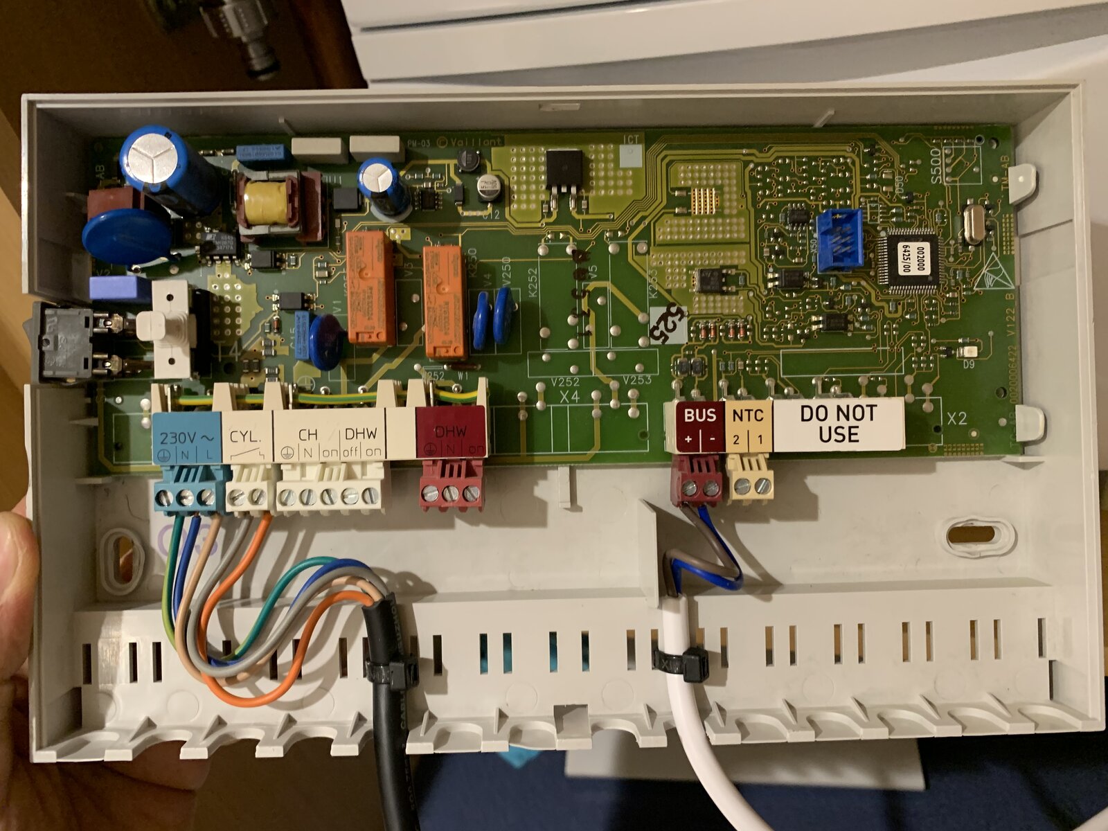

I'm finally getting around to tackling the problem of pairing a non-Vaillant unvented cylinder with a 438 boiler. The goal is to be able to reduce the flow temperature during the summer, but have the cylinder heated at MAX temp (80 degrees being the default, I think).

However, is it the VR65 which instructs the boiler to increase the flow temp to 80 degrees when the 240V cylinder thermostat terminal is closed? And will it do so without the corresponding vaillant controls attached to it.
If so, would it be possible to link the HW zone valve SL to the CYL terminals, which would allow me to use my existing programmer for HW timings and the existing cylinder stat and overheat stat in the Megaflow, and have the VR65 instruct the boiler via ebus to boost the flow temp whenever the CYL terminals are closed?
For anyone else interested in trying this - The zone valve can act as a dry contact relay, using grey and orange to the CYL terminals on the VR65. Just ensure the grey is no longer supplied with mains voltage.
The VR65 will boost the flow temp to 80 degrees, but it's not clear if it will do so unless the rotary dial on the front of the boiler is set to 80 also. This would defeat the purpose of what Im trying to achieve. Previous posters have suggested that the VR65 boosts to 80 on HW demand regardless of any other setting, but others say the boiler control acts as an upper limit, and no ebus command can override it.
So in the absence of another controller to instruct the boiler to lower the flow temp, this probably will not work.

I can confirm that VR65 will work exactly as you originally described.
HW flow temp control via eBus works perfectly with traditional switched live (SL) controls like Nest.
SL controls are not mutually exclusive with eBus controls.
Boiler will satisfy both demand from eBus and from SL terminal 4. Boiler software will work in hot water priority (make sure d.70=0) in case both heating request (via SL) and hot water request (via eBus) are received.
VR65 works as a box that instructs the boiler to increase the flow temp to 80C degrees (to be precise, to the value from d.78) while the cylinder thermostat terminal (CYL) on VR65 is closed. As soon as CYL is open again VR65 will instruct the boiler via eBus to exit the hot water heating mode.
HW temperature knob will work as On/Off switch for hot water control. Off in position zero. On in any non-zero position.
Don’t know how I’ve lived without this feature.
Attached is picture for VR65 wiring.
Notice no valves are connected to VR65.
Very simple.

From your picture, you have grey and orange going to the CYL terminals on the VR65. Where are these taken from? And do they have any voltage on them?
Fezster, -- grey and orange are connected directly to the microswitch of the valve.
VR65 is capable to determine if grey and orange wires are opened or connected together and activates hot water mode if connected together.
No voltage on them! :)
