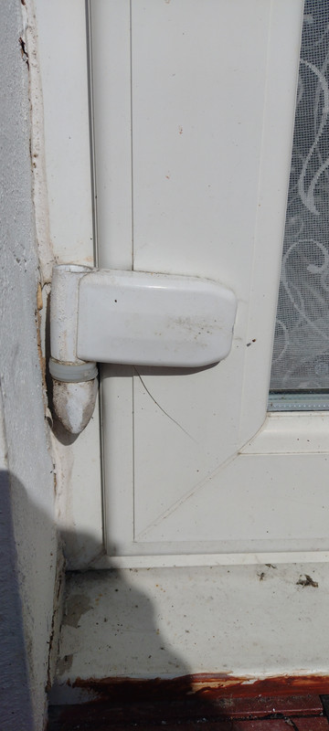

Hi, just moved into a property and am having problems with the French doors. The main door was catching the rollers on the bottom of their slots by a couple of mils and the door wouldn't lock during the hot weather.
As you can see from the photographs somebody has completely mucked the whole thing up with nylon washers. I tried getting an allen key in the bottom of the hinge to adjust it up or down and I couldn't get any size allen key to fit or turn the mechanism. I propped the door up on a brick and tightened the top hinge up as it was a little slack and that seems to have done the trick although maybe it's the weather getting cooler. It isn't catching when closing now and it locks.
The two missing screws in the top hinge were missing when I took the cover off.
I'd like any advice on the best or least worse course of action to permanently fix the door. The landlord (my uncle) is happy for me to get on with it. Many thanks in advance.
Here are the three hinges:
Top hinge:
Middle hinge:
Bottom hinge:

I have had a similar issue with my back door. In my case the frame was buckled but a proper adjustment of the hinges made everything line up.
In your case, those look seriously messed up! :)

I am no expert, but I would buy 3 new hinges and start from there, the existing screw holes might be fine, but at least the new hinges will give a full range of adjustment without possible damage to threads.

I'd be checking that the glass is ' toe and heeled' correctly ...my suspicion is its not and that will cause all sorts of issues. Also be careful, it may actually be the ' slave ' door that's out of alignment originally and not the main door so all the adjustment will not alter it
Love these type of jobs, love getting stuck in. I'd deglaze the door's, lift the doors off the hinges and remove those washers, inspect the hinges to see why they've twisted so much(I know the higher you lift them up the hinge pin the less support they have and they start to sag), may need new or reuse but possibly move them slightly and use virgin PVC, rehang the doors and then reglaze making sure they are toe and heeled correctly

Plenty of videos online showing how to remove the sealed units. Be extra careful if they are laminated glass as can be very heavy!
The doors might need some slight adjustment when the weight of the glass goes back in.
