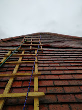

Forget the OSB board and any unwanted ski-ing experience.
Make a roof ladder to suit - cut & screw using 25mm x 38mm tile battens - bend some metal to make hooks.
Similar to this but theses were 25 x 50

Walk on the tail of the tile where it is supported by a tile batten, even better slide every 3rd tile up if you can. Assuming a lean too extension Deffo no ply or osb as it will slide.
