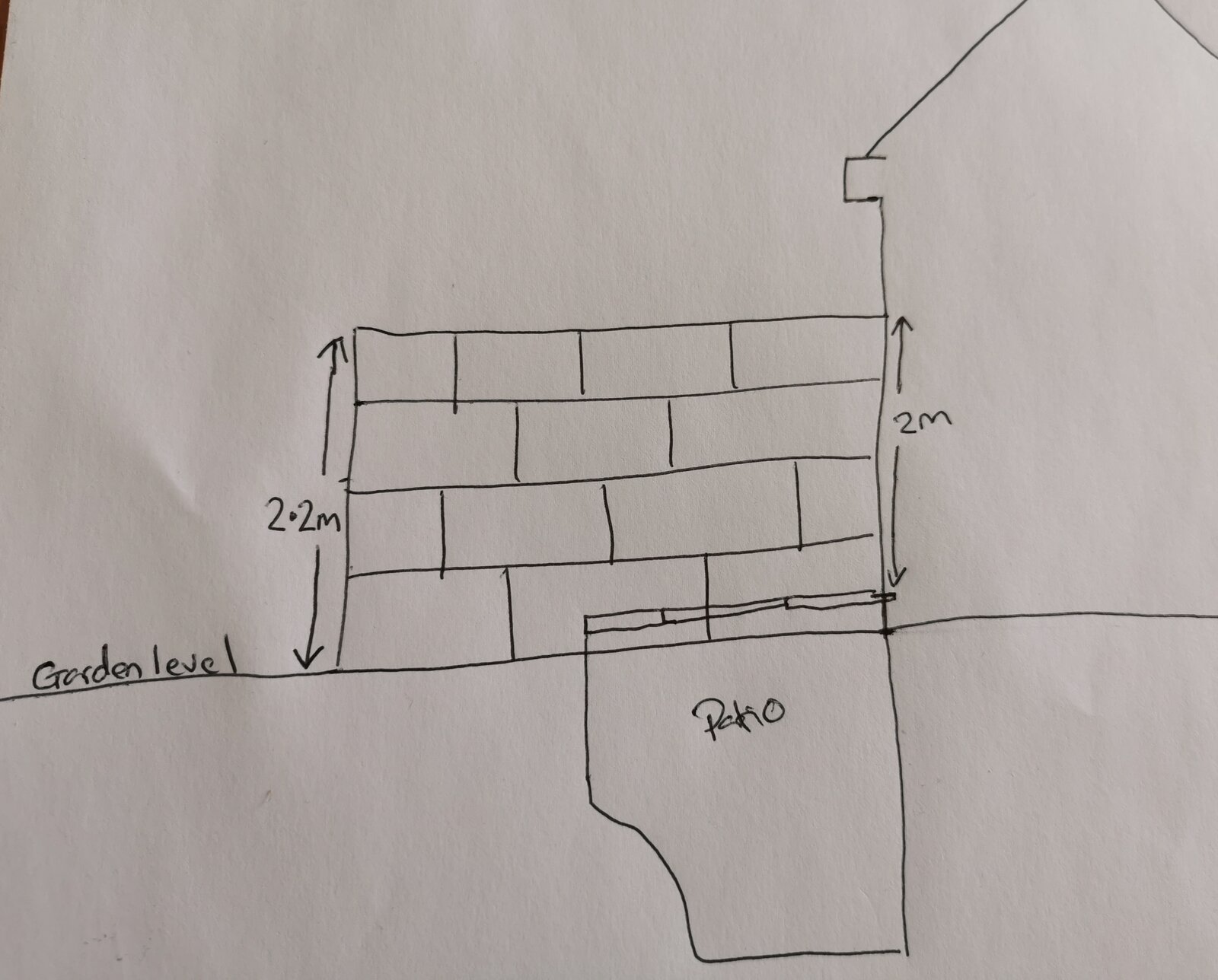

I am looking for some guidance re: building a garden wall and where to measure the ground level from.
I would like to build a wall slightly away from the boundary line on my own land in my garden but it will face my neighbours property. I would like the wall to run from my the end of my house down my patio and into the garden approx 13ft in length and 7ft in height.
My patio which is slightly higher than the rest of the garden where the proposed wall will be built. I would need to remove some of the patio in order to lay the foundations to build the wall so would the wall then become classed as a retaining wall?
As the wall will then come past the end of the patio and down onto the lower land of the garden where do I measure the ground level from? Would it be from where I lay the foundations of the wall which will be below the level of the patio? i.e Do I then measure the height of the wall from the base of first course of bricks I lay or from the higher level of the patio which it will adjoin?

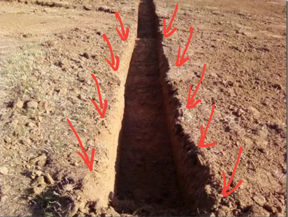

The ground level, of the ground around the wall.
Not your built up patio level or any other ground built up especially for the purpose of measuring off just to build a higher wall.

So am I right in saying that if I build the wall higher than 2 meters let's say 2.5 meters if I then after building the wall lay my patio next to it and measure from the patio level and the wall is then 2 meters from patio level that's not ok is it??

Forgive me but I'm still none the wiser on this matter. I have attached an image for clarification on where I am supposed to measure from when building a wall in regulation with the 2m height restrictions.
Am I measuring from patio level or garden level please as I'm getting conflicting advice from planning who say 'if you take up the patio build the wall then lay the patio back you measure from where the patio hardcore is to get the correct height'..
All very confusing and planning appear to be unsure themselves??!

2 metres from existing ground level...not the hardcore! which would be made up ground, and certainly not from the top of the patio.

So for argument sake I put the footings in level with the ground/garden level I'm measuring from the bottom of the first block I lay then correct??

Why are you thinking like that? Just measure from the ground level o_O
