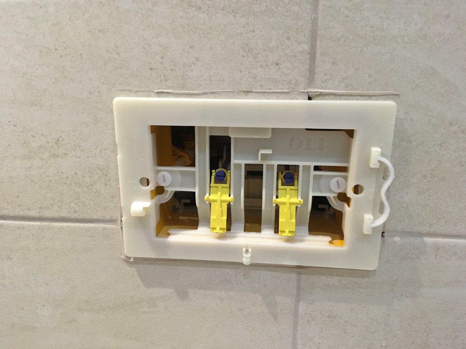

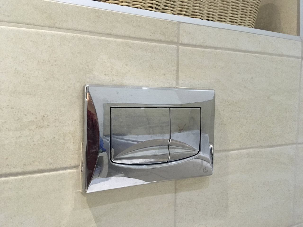

I need to take the cover plate (see photo) off to get to the parts behind, but don't know how to do it. There's no sign of screws so I think it must be held by a spring - can anyone tell me the 'secret'?
It's an Ideal Standard suite, installed about 2013.
Cheers Dan! Perfect! (just for completeness sake, it slides to the left, against the plastic spring (see 2nd photo) :-)
