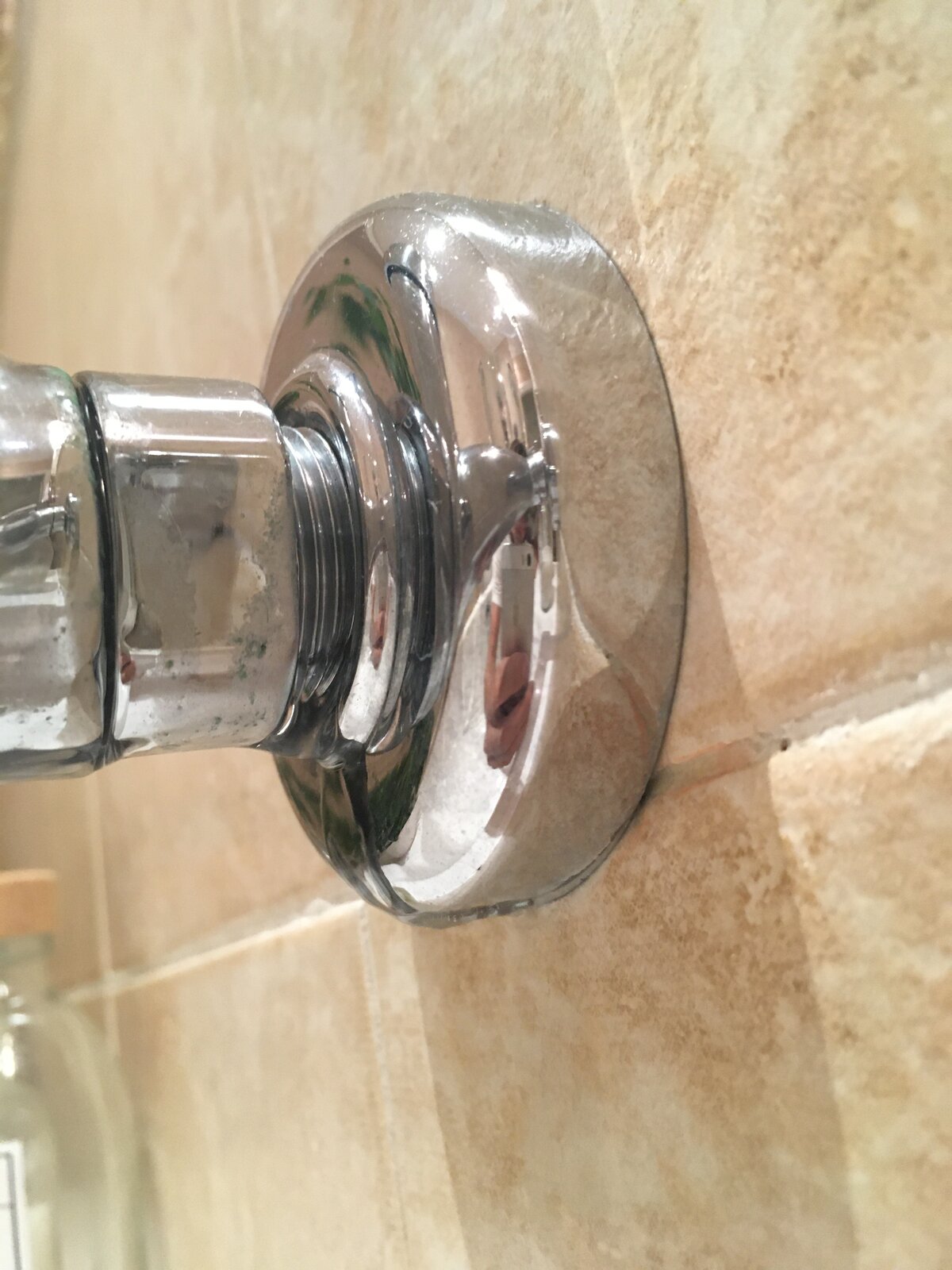

Hello all. My wall mounted bath tap is leaking at a joint beneath the large chrome nut on the left side. The dripping has gotten worse over the last month or so. I think what happened is the large circular disc came unscrewed from the wall and my Dad leant on the spout by mistake which pushed the tap down a bit. I’m a competent DIYer but have no idea how to fix this. I know I can do it. I just need some guidance.
Turn off the water supplies to the valve. Undo both chrome nuts and remove the valve from the wall fittings. There are washers between the valve and the wall fittings. Replace the washers ,usually 3/4 inch. Clean both mating surfaces before fitting the new washers.

Yes valve is the whole thing.
Turn nuts anti clockwise. Should come off very easily ,undo each nut half a turn , repeatedly. ( Don't unscrew one nut fully in other words) hold the valve firmly ,as when nuts are released fully it may fall off under its own weight !!
3/4 inch washers are widely available in both rubber and fibre versions. Get both types . Yours will be one or the other ,but usually either will do.

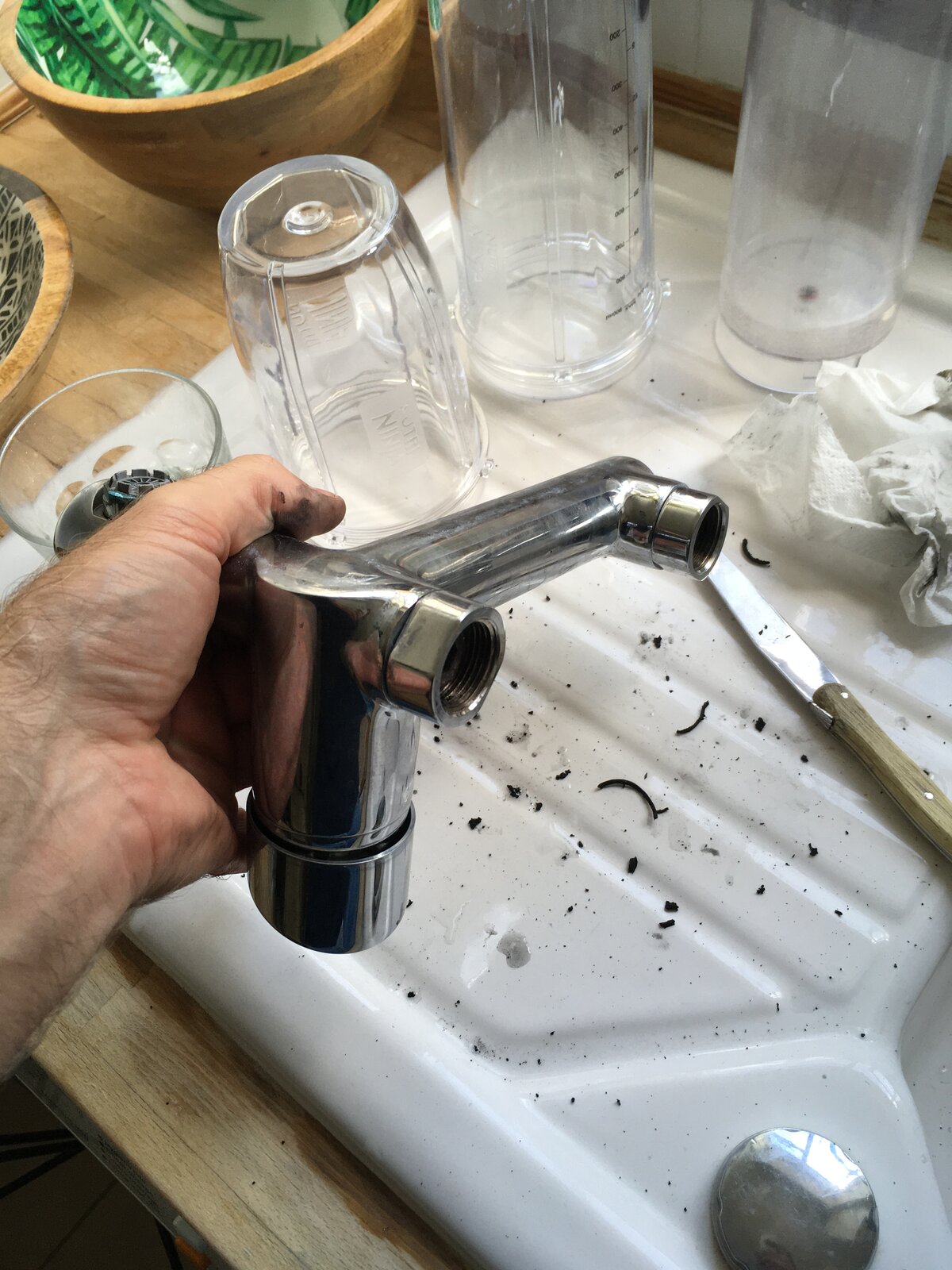

Hi Terryplumb. I just wanted say thank you so much for your advice. I did the job successfully yesterday. I used fibre washers. Removing the tap was easy. One old rubber washer looked OK on the side that wasn’t leaking. On the leaking side the washer was knackered. It took me an hour to scrape the rubber from the threads as bits of it were stuck. I used tweezers to get into the threads and then toothbrush. Unbelievable effort. Then I cleaned it with vinegar. Putting it back was a nightmare because the threaded outlets from the wall did not line up with the tap outlets. The wall outlets had some play in them and with one only just on it’s thread I miraculously managed to get the other one lined up to screw on. I had to pull the tap whilst pushing on the wall outlet as hard as i could and whilst screwing in. I needed 3 hands. I didn’t think it was going to be possible. Obviously the fitter didn’t do a very good job. Done up equally on each side it leaked still but ai was able to do it up a bit more to stop that. I had to do them up very tight. Phew.
