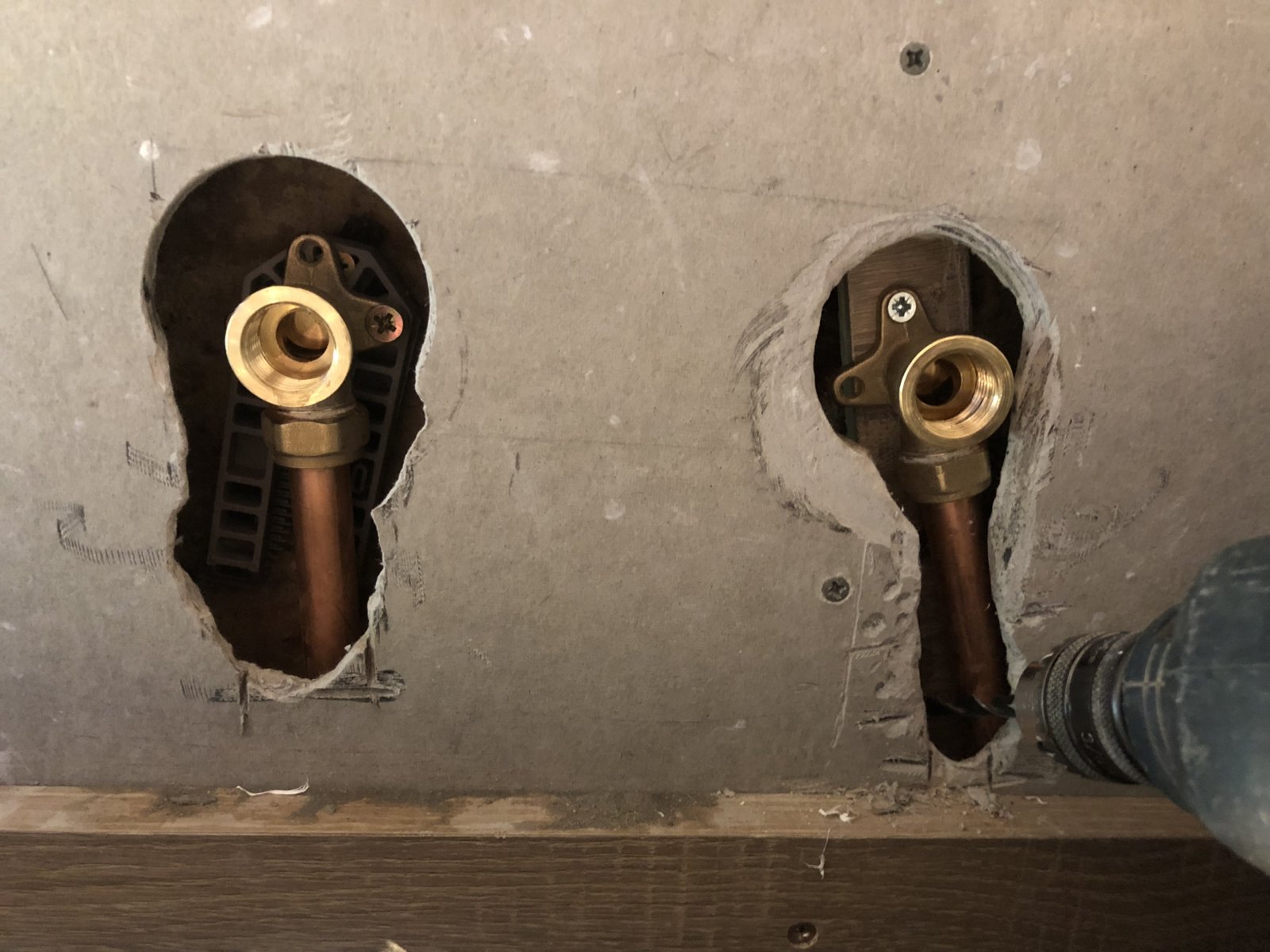

Wall mounted tap compression nuts
5 Jun 2019
54
I am installing a wall mounted tap and the mounts have compression fittings. Are these okay in this hidden position? Any chance of bursting?
Cant find other types of joints on the market at first glance.
They won't burst. They might leak if they aren't done up properly, but pressure testing prior to tiling will confirm whether they are ok or not. Could probably do with more than one screw holding each in place though
