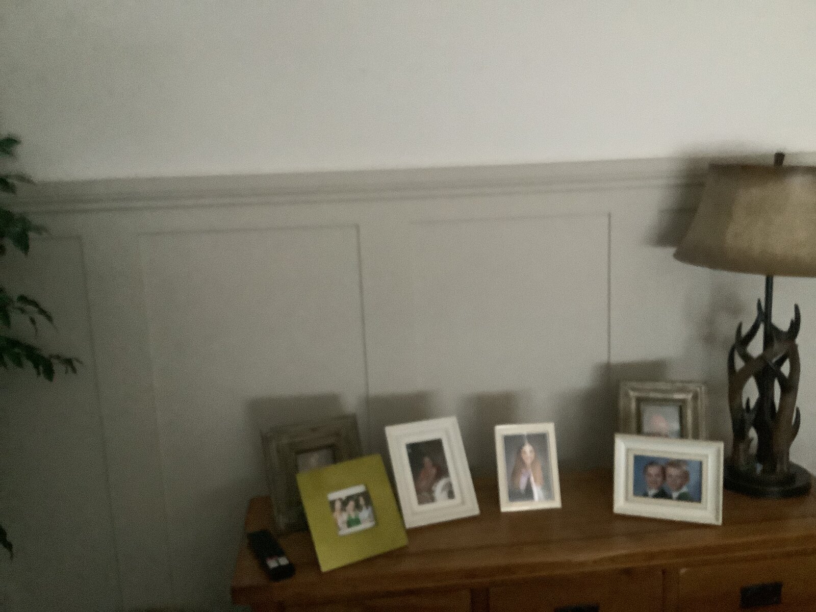

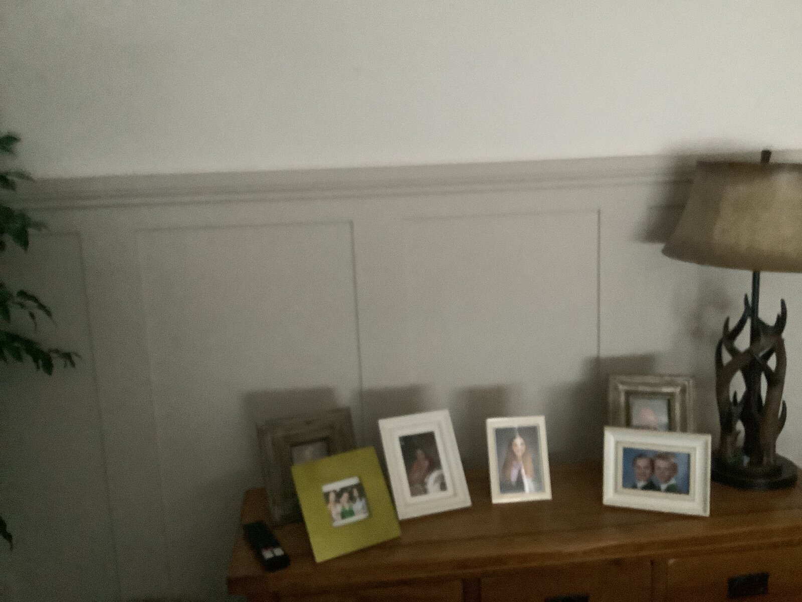

I just glued and pinned strips of MDF to plasterboard, cheap and cheerful.
