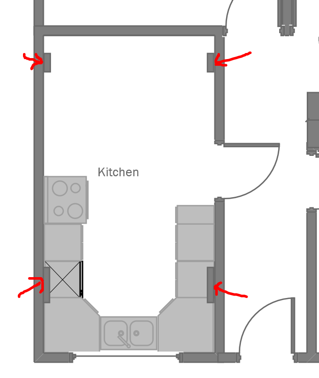

We're moving into a house that has had its garage converted into a kitchen. The room has 4 "notches" that I assume to be breezeblock (hitting them suggests they're solid), that I am unsure of their purpose. Again, I assume supporting, but are they still required after the conversion? Why does a garage need these supports but no other room does?...
At present, the high level shelves (not shown in the diagram below) are pretty much "half depth" because of these supporting walls.
What is the purpose of these supports, and more importantly, can they be removed/knocked back to the normal wall?
I'm guessing the answer will be leave well alone, but I am keen to understand their purpose, and I'm sure it wont be the first time many of you have seen this. What clever things could be done to maximise kitchen space because of these supports?
I guess this is what I'm seeing, question is, what purpose do they serve and can they be shaved back?
A quick Google suggests they may be called Wall Pier's and removal/touching them is not recommended, which is what I presumed to be fair.
They are indeed piers, and are intended to stiffen the wall, which is only 100mm thick; remove them at your peril.

I'd be interested to see how a builder has damp-proofed and insulated a single-skin garage and managed to leave the piers as they were.
The value of a survey is in picking up things that affect your purchase - which are exactly the same things that a future buyer may pick up and will affect you selling it in the future.
It was pretty common until prolly a decade ago or something that BC (down here at any rate) would expect the walls to be insulated but let you leave the piers uninsulated. :eek:

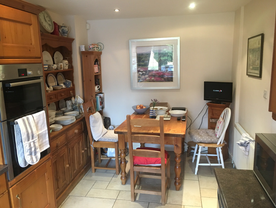

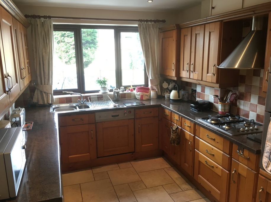

As you can see from the pictures, that external wall is pretty much covered from start to finish, so who knows whats behind the fixtures and fittings.
Useful or not, that external wall, is actually protected somewhat from direct rain fall, due to the property to the side. Equally, it is also a foot or so higher than the ground level to the side.
