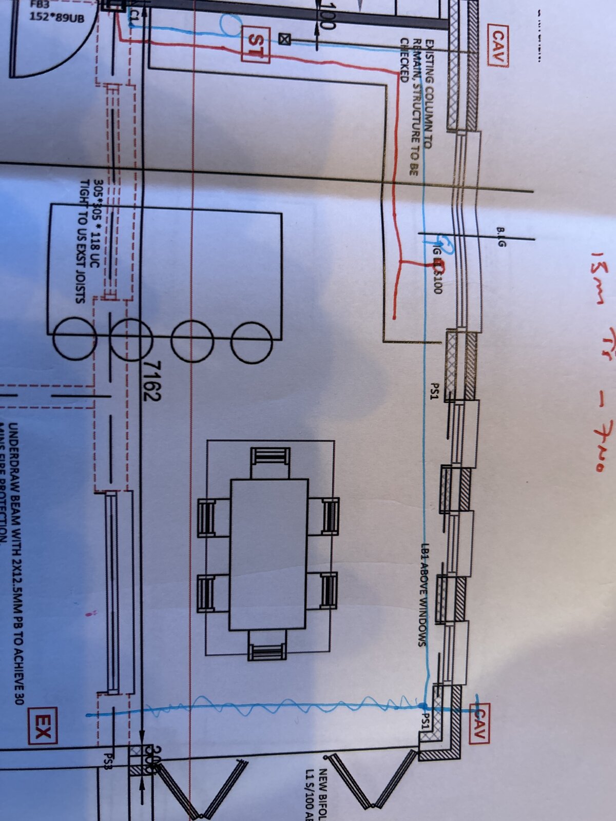

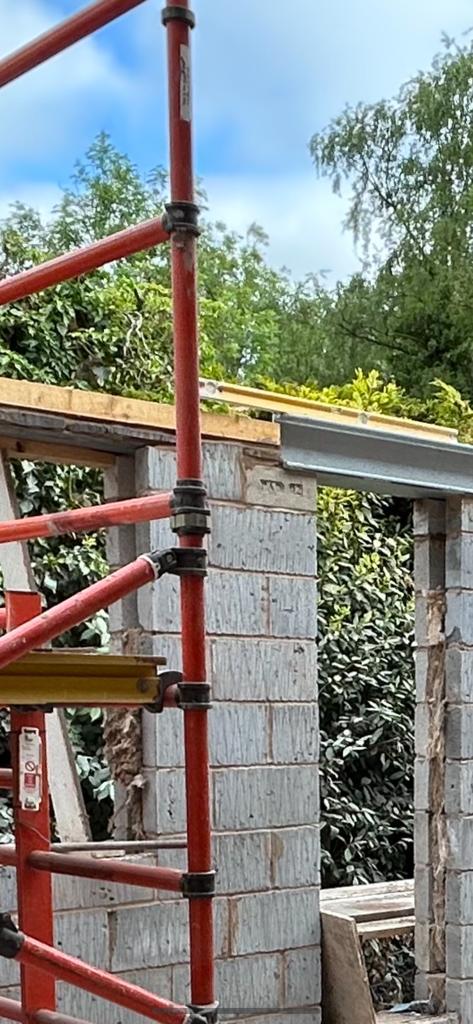

Currently ongoing with my extension and got a slight problem with the wall plate height and lintel height.
The wall plate is about 30mm lower than the top of the lintel... I cant raise the wall plate anymore as it affects the soil stack on the back wall.
Will it be ok to notch the joists to sit on the lintel? The roof joists are 175x47
Picture:
