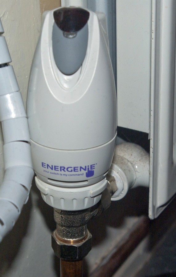

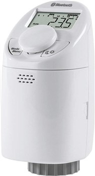

My wireless thermostats IMGP8035.jpg EQ-3 Bluetooth Smart Radiator Thermostat.jpg do work well, but I do not move them from room to room. It seems the Drayton Wiser TRV has algorithms built in that works out how long it takes to heat the room, my IMGP8035.jpg is rather OTT with the anti-hysteresis software, to the extent I cheat and set to 22°C for an hour then back to 20°C.
But as to how each make works, no one is likely to have a mixture so no one is likely to be able to say this one is better than that one. In hind sight paying £38 each for these IMGP8035.jpg compared to £15 for these EQ-3 Bluetooth Smart Radiator Thermostat.jpg I would go for the cheap bluetooth head rather than the expensive wifi one, yes the expensive one will geofence, but I tend to turn off whole system when I leave house, so does not matter what the TRV does if boiler not running.
