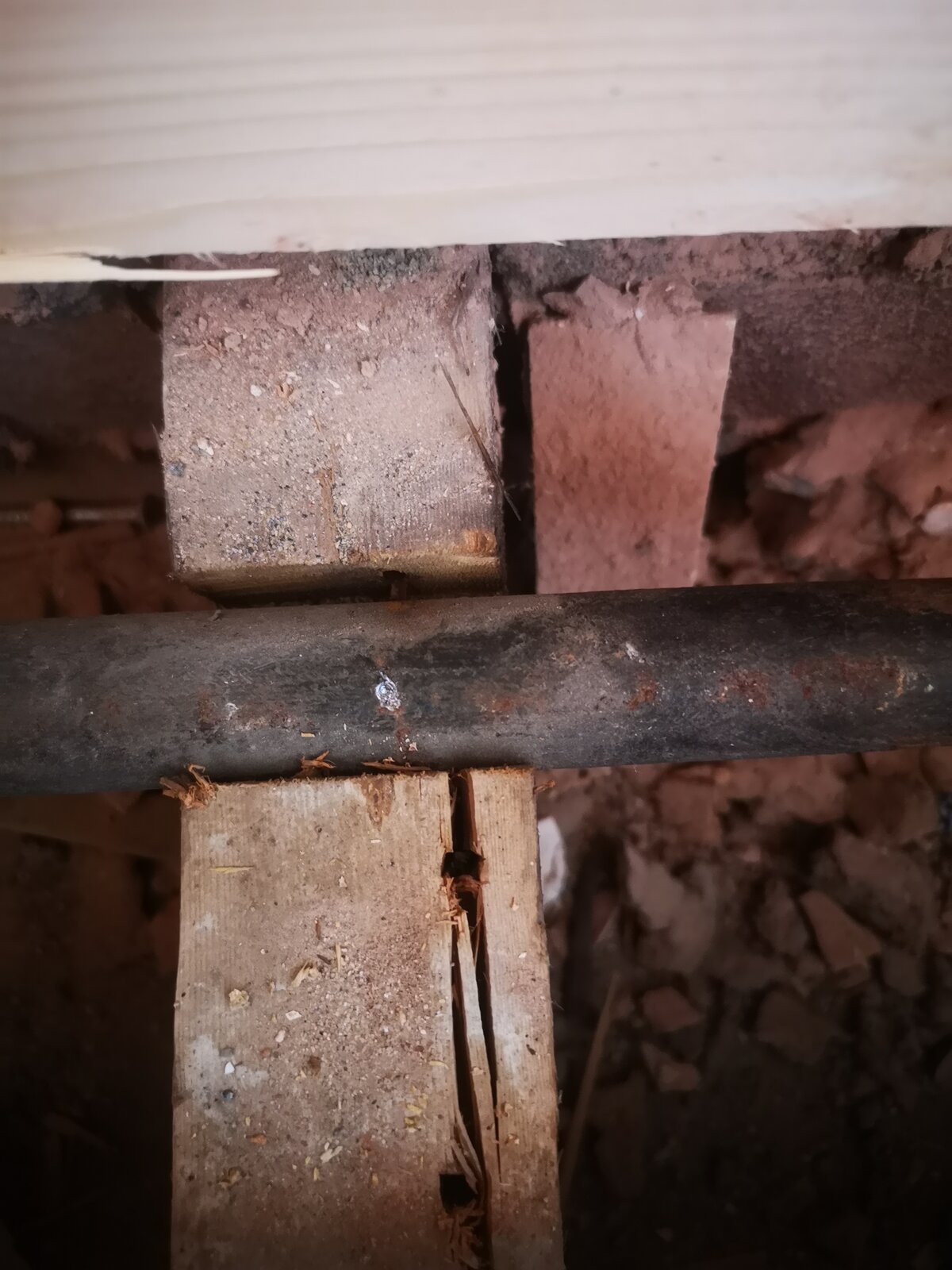

Does anyone know how thick the wall of 30mm (approx) steel water pipe is? The house was built in the early 1950s.

That is helpful and a relief to hear. I nicked the pipe with a screw. I have put a dimple in it and was unsure whether I might have weakened it. The dimple is very shallow and I cannot see it having done so.

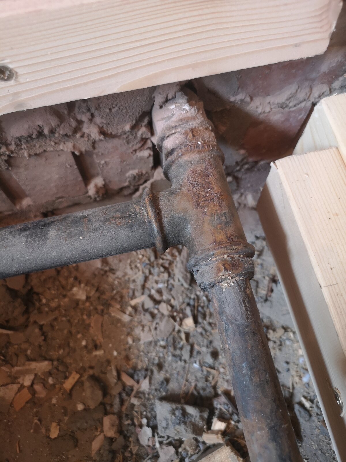

I should have added that the pipe is under the floorboards in the bathroom and is the rising main coming up from the stop cock in the kitchen.
Are you sure it's steel?
Denting a galve water pipe with a modem screw sounds unlikely.
Try scratching pipe with sharp knife
Clear picture would be useful.
It is definitely metal, but it is not galvanised. It is black.

Odd! steel tube for cold water should be galvanised plus I doubt you could dent it so much with a screw
Pic of said screwed joint?
The joints.
The front of some of these houses is made from rendered wire mesh with just a plasterboard inner wall with no insulation at all, so odd is pretty common in the property.
