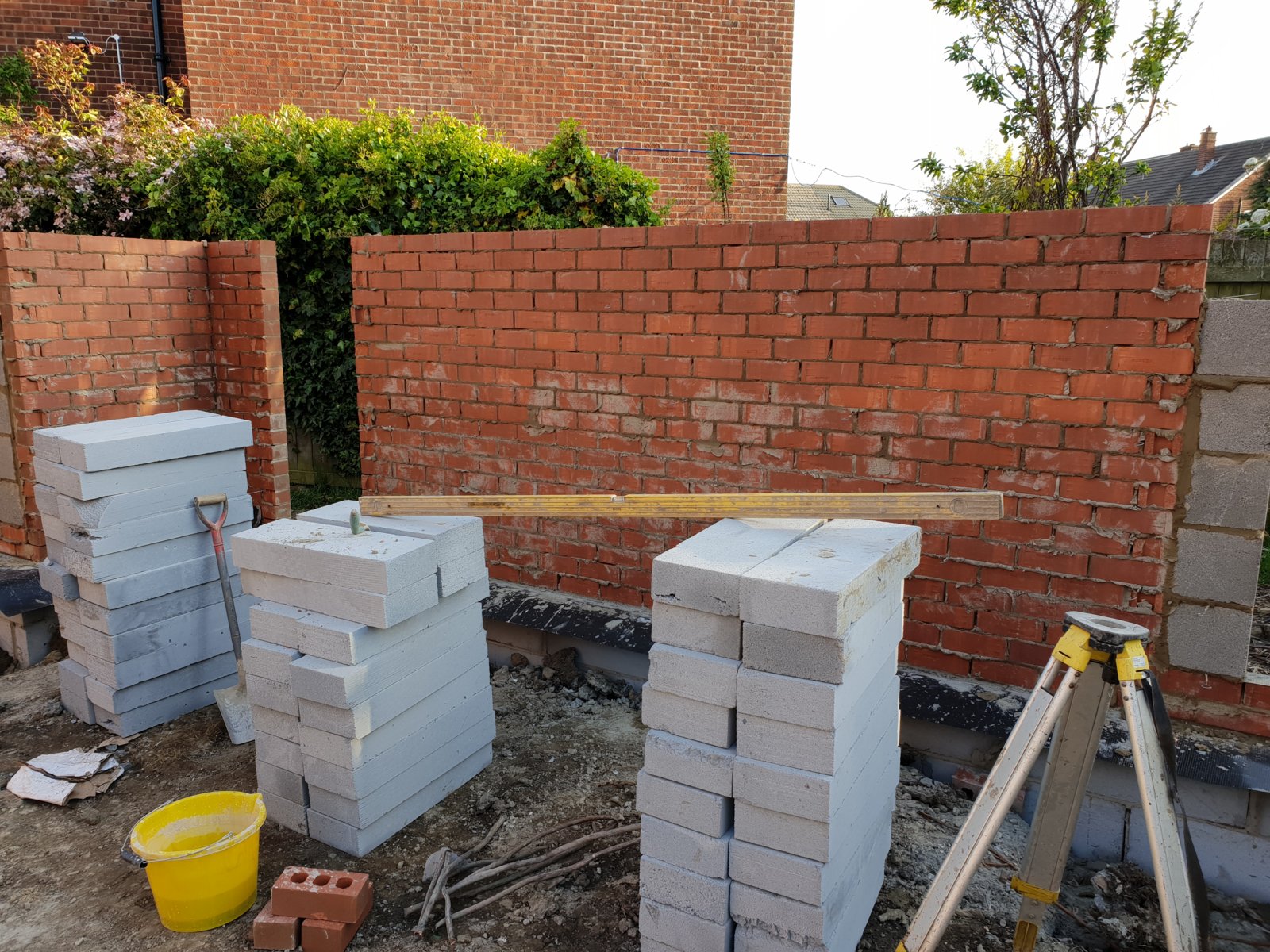

Hi,
I'm currently getting an extension built and noticed that the section of wall that if currently going up is only outer leaf and no wall ties are being set for when the inner blockwork is also added. Is this normal procedure?...

It's going to be solid concrete floor. I'm just wondering why they have gone so high without starting ties. Surely these can't be put in once the outer leaf is laid, as the mortar would have set by the time the inner leaf starts.

There's a few around the openings.
Ask them about it before they do the inside, they could always screw some in.

I wondered because it looks like soil on the floor, usually blockwork would go up inside to say 1 block below dpc and then concrete oversite would be laid.
I cant think why a builder would want to put up the walls and then struggle getting the dirt out and type 1, concrete etc in....
Usually wall ties are put in as the walls go up, either both courses go up in stages together or, 1 is done first and ties put in as required an then the other course is done along with the insulation.
Its normal for cavity insulation to be 450mm high as that is the wall tie spacings for straight runs of ties -some more are put in around openings

Ties are built in as the wall is built not shoved in afterwards - that way they are loose.
If they had built the inner leaf first they might be able to retro fit screw in ties. I suppose they could use helical or expanding ties fixed in to the mortar joints of the outer leaf but it is such a fundamental balls up I wouldn't want them within a hundred miles of any of my jobs.
The floor is currently down about 450 below inner FFL so assume plenty of space for the sub base, concrete, installation and screed, hence why you see soil at that level.
The foundations are trench filled 1+m.
There is then a line of block laid flat to increase the found height, then 4 brick height of brick with a DPC and then another 2 brick height then another DPC. Not sure why 2 DPC's, assume it's to do with the concrete floor.
They have ties around the openings but not within that large length/width of wall, which is why I was confused. I've asked the building control officer for his view on it.

Can't understand why they have put some but not enough ties in. Hope they have not been using that level to plumb up with.
Actually panic over! If I zoom in really close I can see the ties. They are really thin so didn't notice them on the photo!
