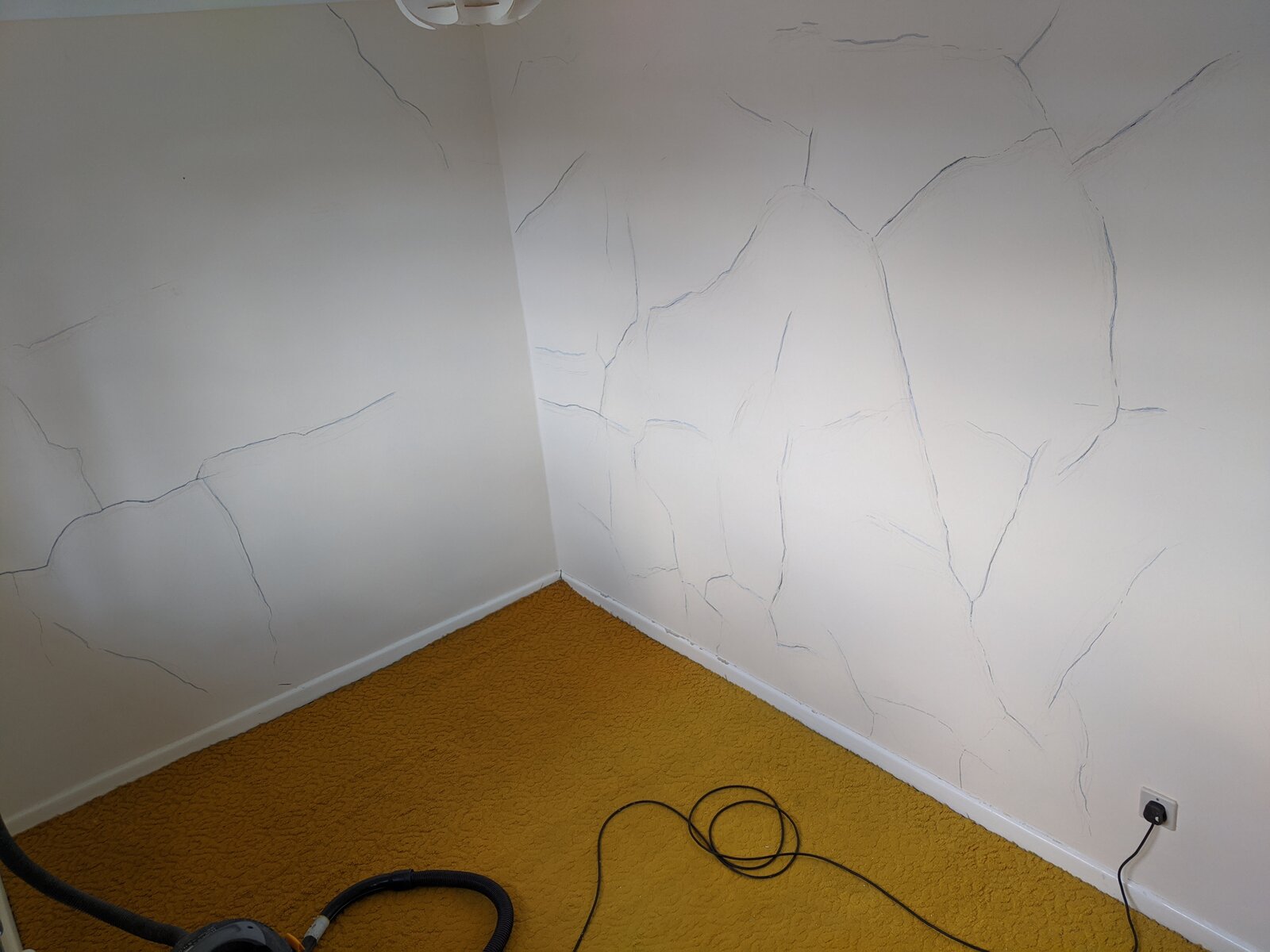

Just moved in to a new house and within 3 weeks of moving in, I've noticed that most walls look like that porcelain with cracks in it. It wasn't immediately obvious, but the more we live in it, the more obvious it is becoming. Some walls have it really badly too. I initially got quite worried about this and checked all the exterior walls, which are brick, but they seem absolutely fine.
The house was built in the 1950's or 60's. I doubt it's had any major work done to it since then and it's certainly not been plastered recently.
Any ideas as to what is causing this? Will skimming over it solve the problem, or will this just return?
For scale, the image below is approx. 1200mm by 700mm of wall. Interestingly, I tapped the walls all over and none of the plaster seems to be blown.

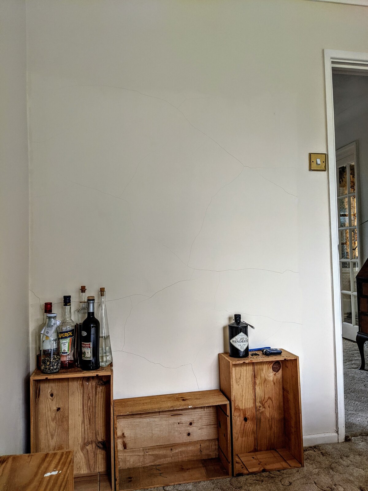

Stand back and take a pic of the whole wall please.
include something in the pic to show scale.

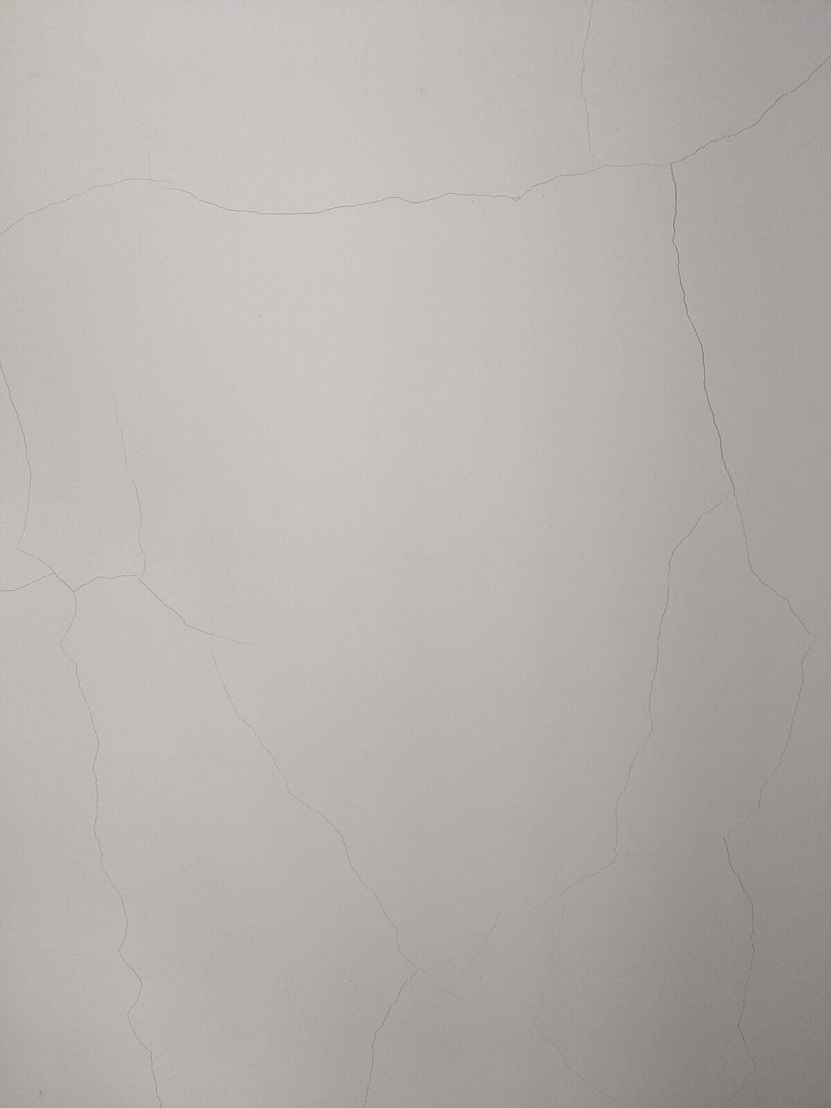

Different wall, as it's very difficult to take a decent picture. I tried editing it a bit, but you might need to zoom/look very closely. None of the cracks are very large, the problem is they are everywhere. Almost every single wall seems to have them to some degree, with the internal walls being a little worse.

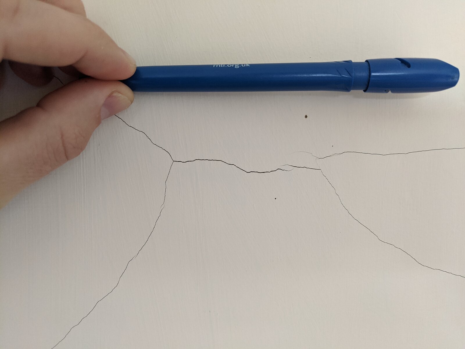

A more detailed picture:
built in 1950s or 60's suggests the walls will be built in brick or block. They aren't hollow plasterboard, are they?
I don't thnk I can see a pattern of blockwork joints in your cracks.
Have you drilled any holes? What colour is the dust?
have there been structural alterations, such as knocking down or adding walls, loft conversion, chimney removal?
Plasterboard would show the straight lines of the edges of the plasterboard. Nor are the lines following any brick or block joints.
Might it simply be due to the house having central heating fitted and the humidity is much lower than previously?
I would be inclined to decorate next time with lining paper and paint over that to hide the cracks.

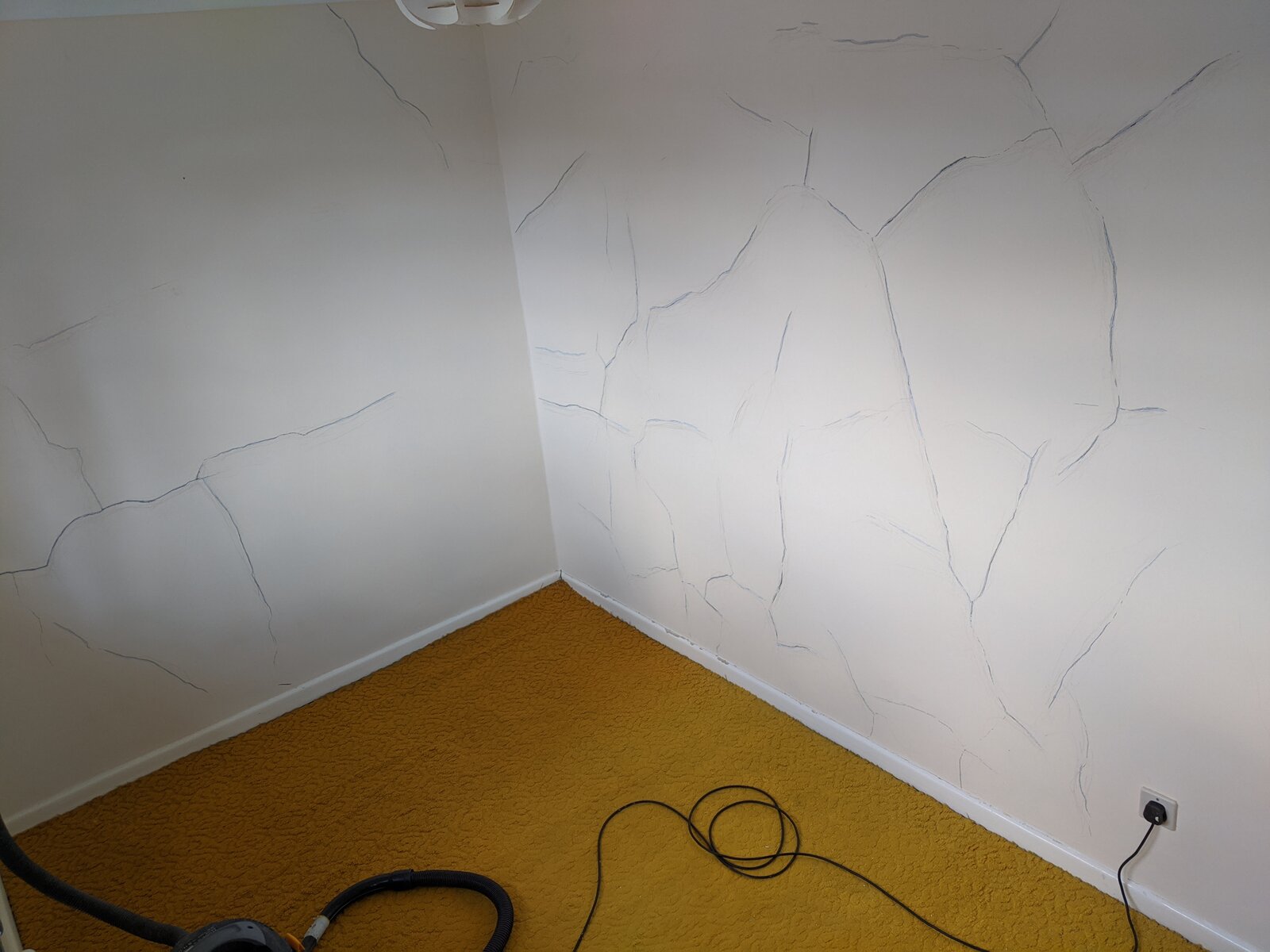

I really dislike lining paper, but I've spent the last 3 days opening up every single crack in the smallest room in the house with a triangular tool, rubbing some PVA in there and filling it with fine filler and I can't see myself doing that in every room in the house. :(
Note, this is a picture where I have opened up the cracks. These were not the original cracks, they were far thinner.
I think paper may be your best bet.
I'm wondering if the walls have been thinly reskimmed and there was shrinkage, but I don't recognise the pattern you have.
Had a bit similar in our dining room. Think it was still the original plaster from the house built in 70s. quite a few thin cracks like that. Plaster still sounded ok when tapped.
I scrimmed over most of them (Certainly the bigger ones) and reskimmed. Sorted some but a lot have come back still.
it may be lining paper is your best option, rather than a big job to hack off and start again.
I didn't like the idea of lining paper and my walls were generally crack free, but once on and painted, the lining paper is all but invisible. It is a very cheap, quick solution for your cracks.
