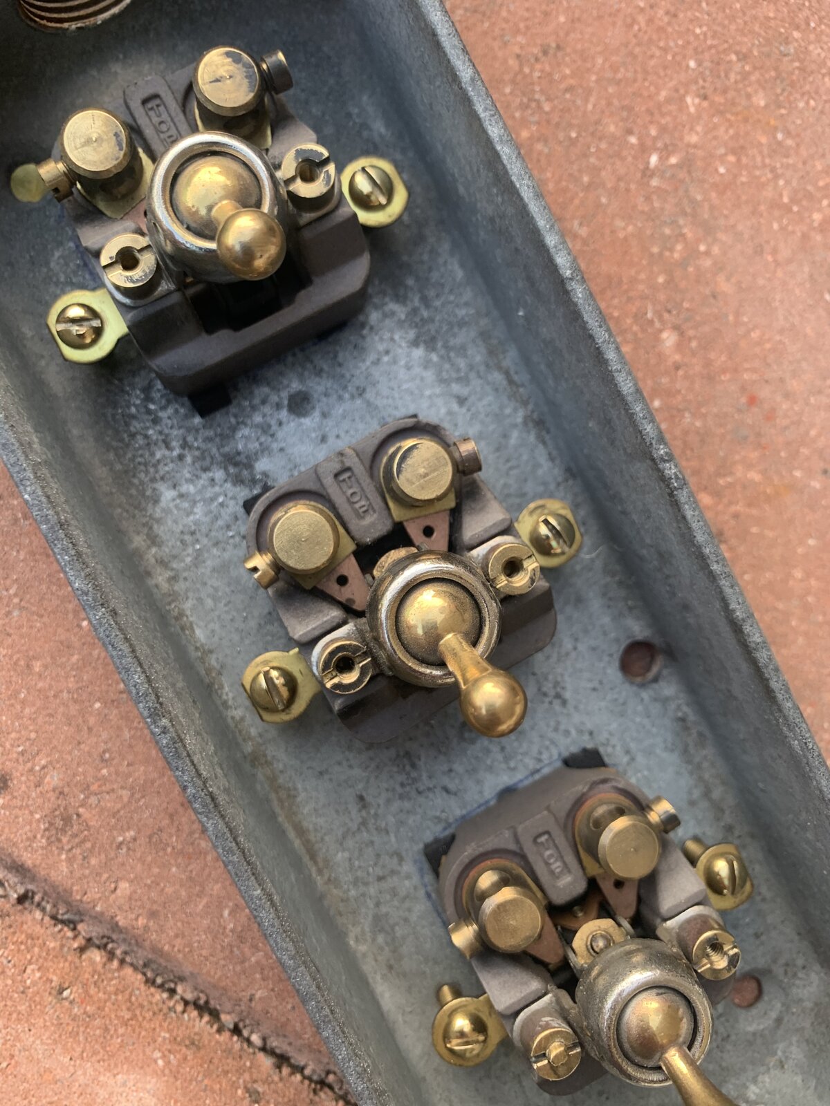

Does anyone know if those old industrial Wandsworth switches came with two way modules?
To answer your original question..... of course they did. We've pretty much had 2 & 3 way switching since the day after we invented 'lectric :)
Some of the switching regimes of old were very clever... over-ride switches using the other contact of a 2 way switch to 'force' a lamp ON and using a switch across the 'strappers' of a two way switch circuit to prevent the lamp being turned OFF to name a couple.
