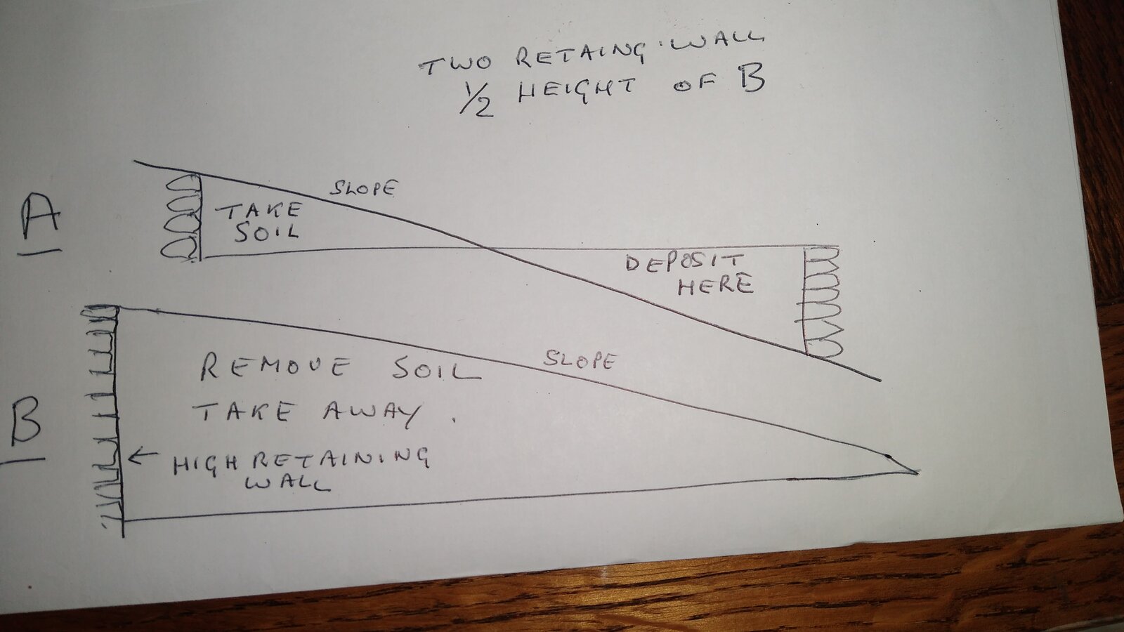

A couple of ways to level.
I generally use A as no soil to dispose of and maybe grade out top and bottom instead of retaining structures.
I once constructed a doubles tennis grass court into a hillside with A method
