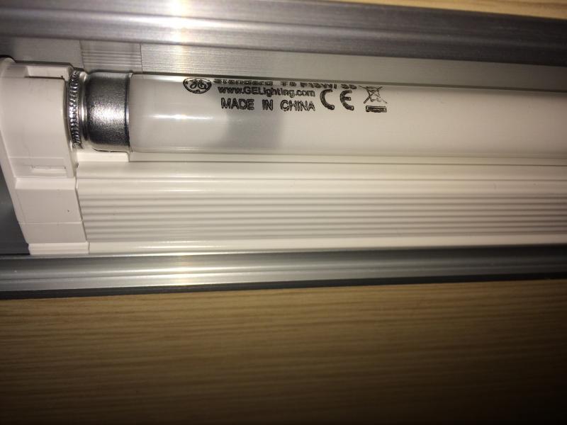

Hi everyone,
Hopefully this isn't a silly question but forgive me if it is. A light has blown In my wardrobe, I'm not sure how to remove the light fitting to replace it.
The plastic surrounding the light looks cracked in places and I don't want to damage it further, it's part of a rental so I'm responsible for changing light bulbs buy land lord is for everything else.
Any idea how I can remove it and also what I need to buy to replace?
In theory, (obviously with the power switched off) you just have to rotate the tube through 90 degrees, after which it should be possible to simply lift it out, it's pins coming through those slots in the top of the plastic surround - a little bit of gentle 'wiggling' might be required. I can't really see any damage in the photos, so can't really comment on whether the fitting is still viable. You then need to purchase the same as you have removed.

Power off first.
Turn the tube until the pins line up with the two slots at either end.
Take it to Screwfix, B&Q or one of the sheds and get a similar tube,
However, if there are cracks in the plastic then it might be worthwhile replacing the whole unit.
Do take this advice, there are a number of 13W tubes around, but different makers have varying lengths. And it will not work if it is the wrong length.

Thanks for the swift replies everyone.
It doesn't appear to want to rotate, I've given it a few attempts but it's also hard to get much purchase on due to its position. However from what I can tell either it's stuck or doesn't rotate, should it be relatively easy to rotate?
I did intitally contact the agent whom manages for the land lord but they said they couldn't provide any aid in case it breaks. There are definite cracks to the plastic casing on both sides, we are moving out which is possibly why the agent isn't being quite as helpful as normal.
They can sometimes get rather stuck, such that rotating them can be quite frightening! There's no doubt that it should rotate.
