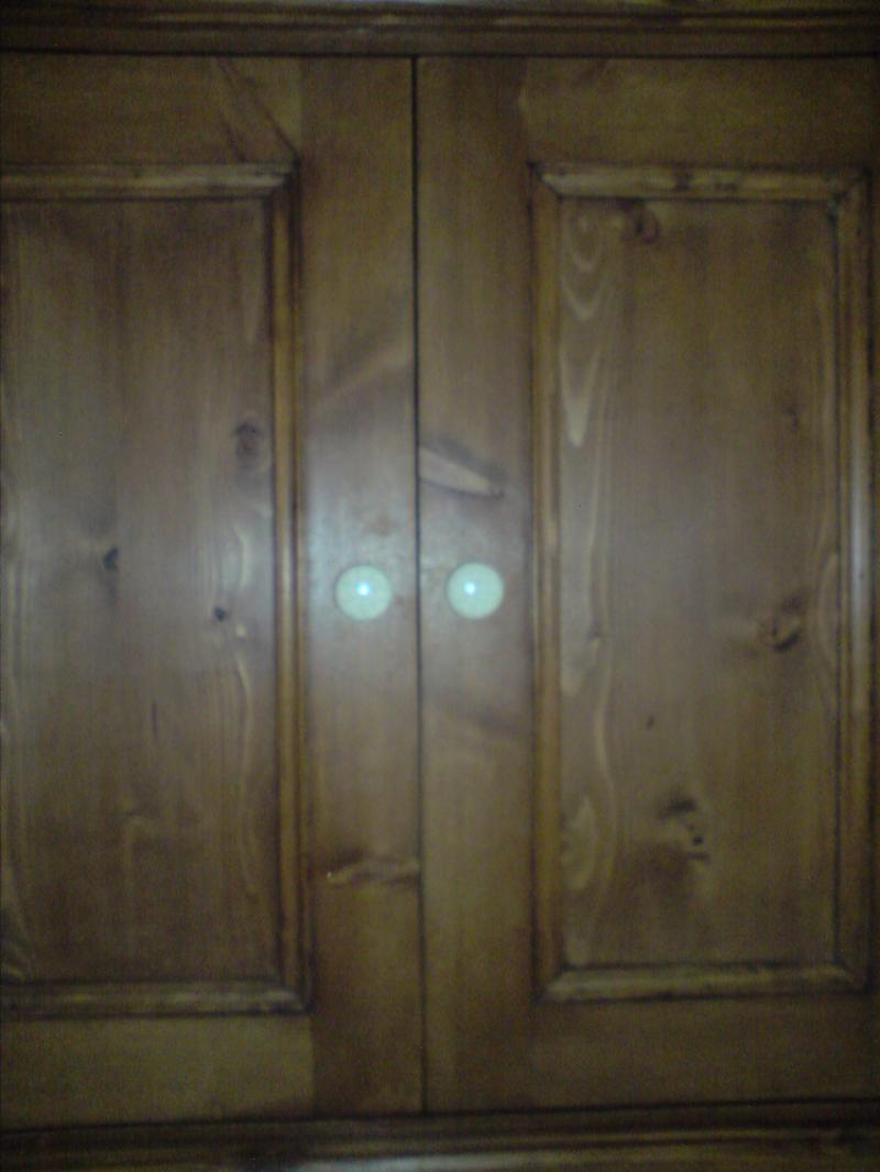

show us some pics
how humid is your kitchen?
Hi John, I'll take a few pictures and post them.
I don't think our kitchen is any more humid that other kitchens.
It has solid floors. We have had a new extension, hence the new kitchen. Size is 5mt x 5 mt. It has a door to the hall, lounge and utility.
I don't think I can see a warp there (click the pic)
is it just the gap between the doors that tapers? it can be adjusted at the hinge. what about the hinge side gap?
assuming they have normal kitchen type hinges they are easily adjusted and is not a fault just maintainance that they arnt responcible for

The doors appear to have swelled! and closed the gap at the bottom.

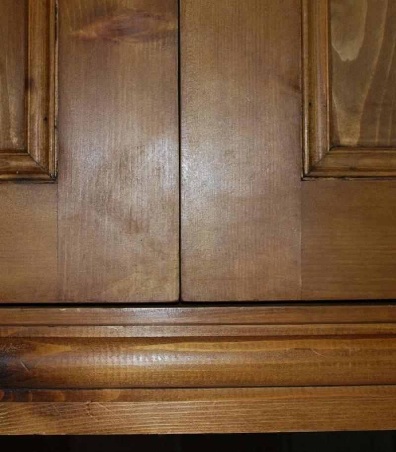

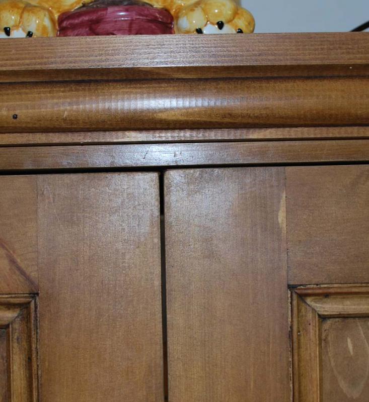

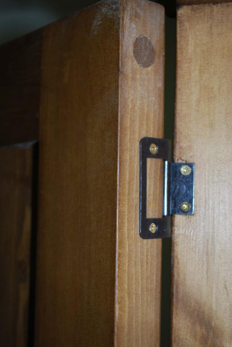

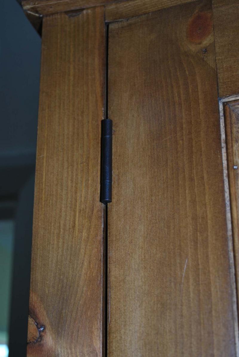

Here are a two pictures of the hinges and two pictures of door gaps.
The pictures don't seem to show the gaps that well, trust me though they are there!
Hopefully the hinge pictures will help with adjustment advice.

I do not know what response you will get from other "contributors" BUT, I for one am singularly un-Impressed by the quality of hinges used.
These hinges are [in My opinion - - everyone is entitled to My Opinion? ? ?] are not what I would expect to see on a piece of "Bespoke" "furniture" whether it be a cabinet, or a kitchen base unit.
The hinges used are "skeleton" type and B&Q sell them at just over a £1.25 for a pair. this in my [tiny] mind sets the alarm bells clanging
It is my opinion that the hinges used are , and I apologize for this in advance, cheap and nasty.

i wouldnt expect those hinges on a cabinet off more than £100
you can adjust them if they are on the face by filling the screw hole/holes with a match stick/slither off wood
the doors are screwed and pluged so no real craft involved
a lot off time and money seems to have been wasted by using stick on mouldings rather than using a router/ spindle moulder
the only way you can adjust those hinges is with 0.5-1mm plastic slithers on the opposit bottom hinges on the door to be least obviouse
