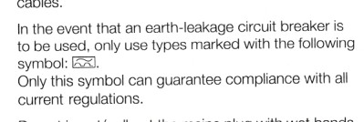

We have just switched on the washing machine for the first time after a CU change. Needless to say, it trips the RCD.
We then discover this in the machine instructions:
wash-jpg.103039
I know there are different ways of fault detection but I can't find any reference to this symbol. What is this type and is there a simple solution to the problem?

Earth-leakage circuit breakers were superseded by RCD's about 20 or more years ago, so if your washing machine is really that old (as opposed to just the text in the instructions) then it's probably time to change it. Otherwise there is a leakage of current to earth somewhere inside your washing machine, there could be lots of causes from a faulty component to a water leak causing a short circuit somewhere, a good domestic appliance engineer with the correct testing equipment should be able to diagnose it for you. If you know that it trips at a certain point in the cycle such as when the pump or motor starts, this can help diagnosis.

I believe that is the symbol for a "Type A" RCD - i.e. one that will react to pulsating DC currents as well as AC currents.
OK, found it now. So it appears it should more sensitive than the one in the CU, it's not that the CU is detecting something a type A would not.
No. So you will still have the problem.
However it does show that the use of Type AC RCDs is often inappropriate. I believe the use of Type A RCDs is very common on the continent, but not here or in Britain. (There are also Type B RCDs.)
