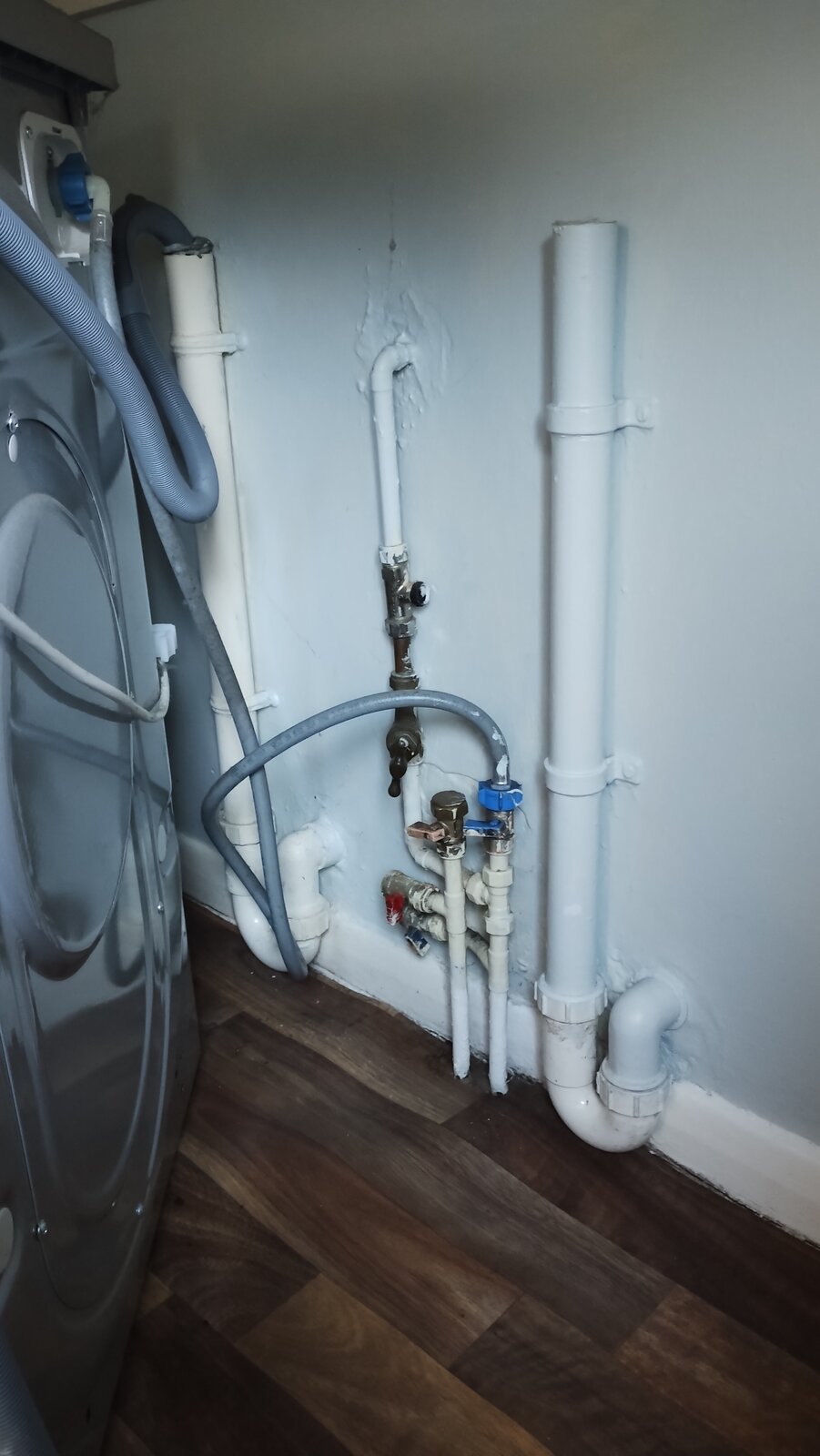

Post a picture of the waste water hose where it joins to under your sink, I suspect that the water is from your sink flowing back into the machine.

this is the plumbing isolation valve under the sink, the blue hose screws onto it. The electric inlet valve inside the machine is quite different.
Thank-you for the replies.
The washer/dryer waste pipe is not connected to the kitchen sink.
It is in a small utility room.

Your waste standpipe cannot be the source, so the smart money is on the electric inlet valve.
Apart from Bosch, the valves are a standard fit. One of the reputable appliance spares suppliers will mail you one.
Until it arrives, just turn off the plumbing tap when the machine is not in use. No point in taking it apart until you have the new one.
Incidentally, the incorrectly-positioned waste hose syphoning water from the kitchen sink is a very common problem in dishwashers and washing machines, but not what you have got.

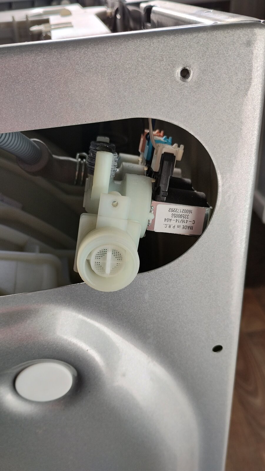

Fred, the coarse filter is in tact and not broken, please see picture.
Wayners, there are no flashing lights of error codes. I did a wash yesterday and it worked as it should.
I then turned the blue water isolator tap off.

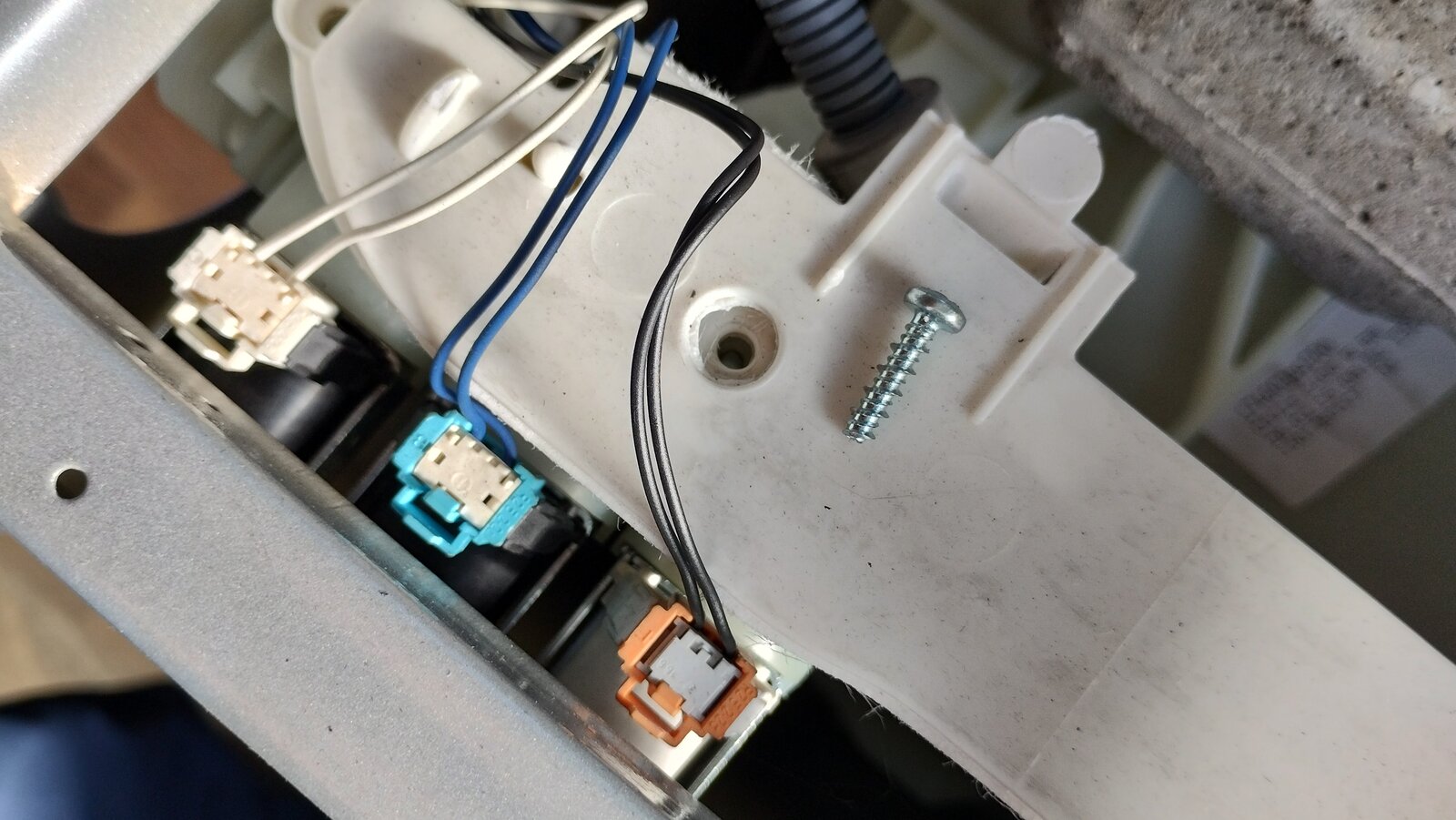

John, I had to go out this morning and took the top off the washer/dryer before I went to get a look at the electrical/water inlet valve.
Please see pictures.

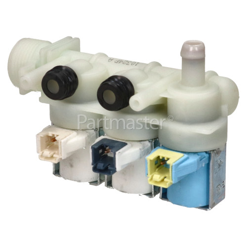

I found one that looks like mine for £42
and on the same website an alternative manufacturer for £24 but the colours on the 3 terminals are a different colour so I may be better off buying the original part.

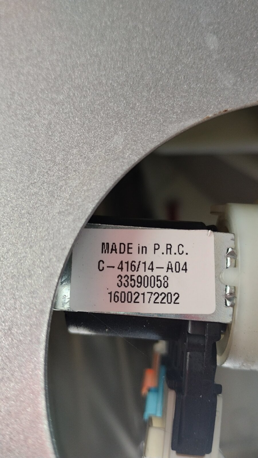

When mine failed, I bought the original part. The local repairman fits non-original unless the customer requests branded and is willing to pay the difference. From a reputable supplier I suspect they are the same. Probably made by the thousand in China.
Inlet valve passing - turn that blue CW inlet valve off, when you are not using the machine - if that fixes it, fit a new inlet solenoid valve.

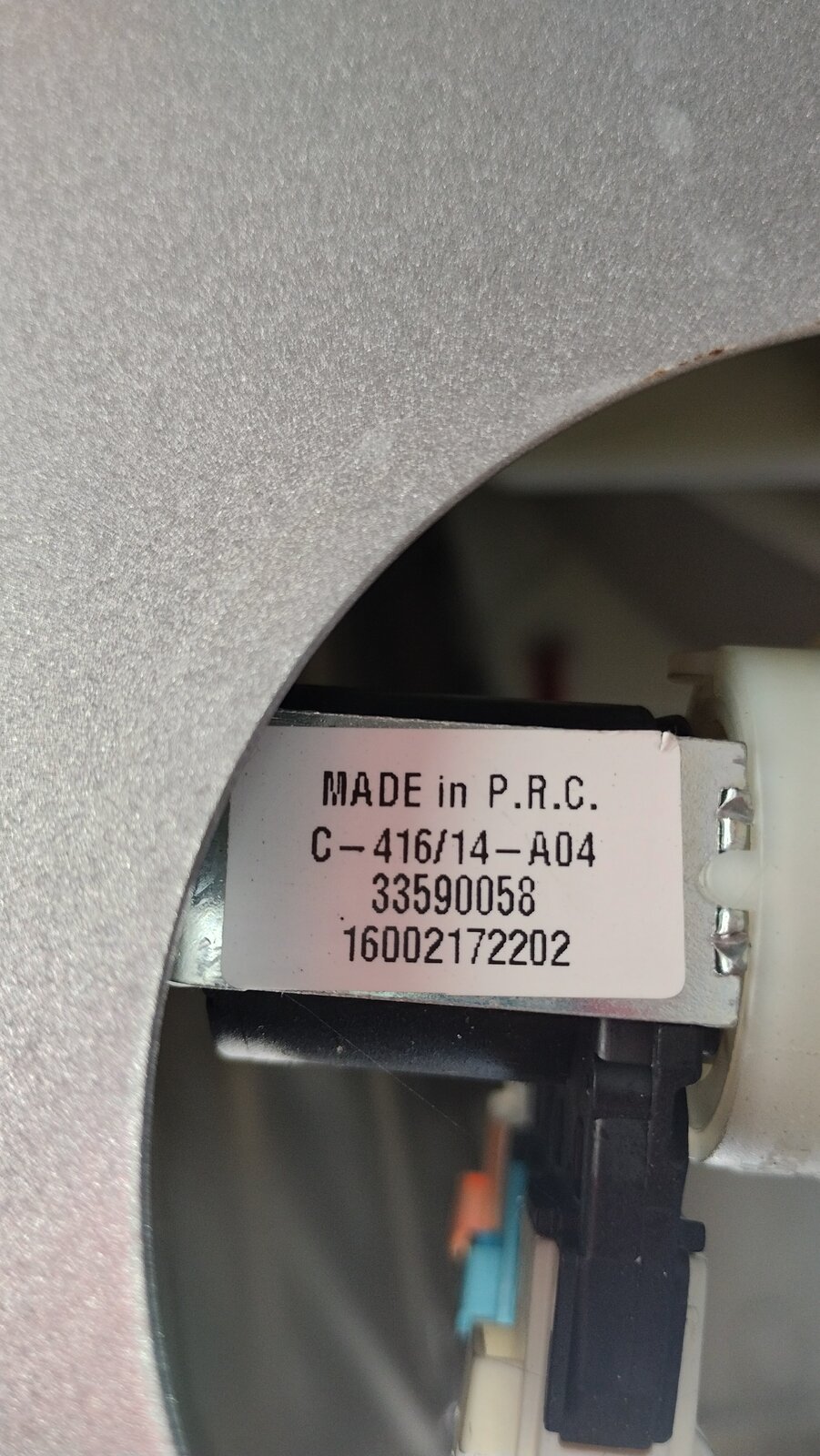

Funny thing is, the original part in my washer/dryer has a sticker with "Made in PRC".
I wonder if that is the peoples republic of China?
