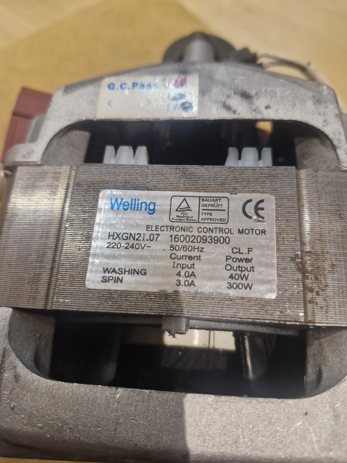

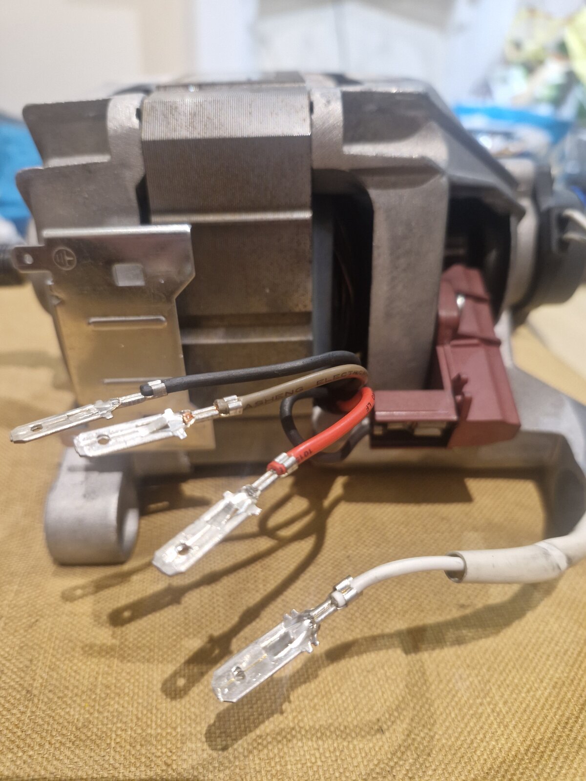

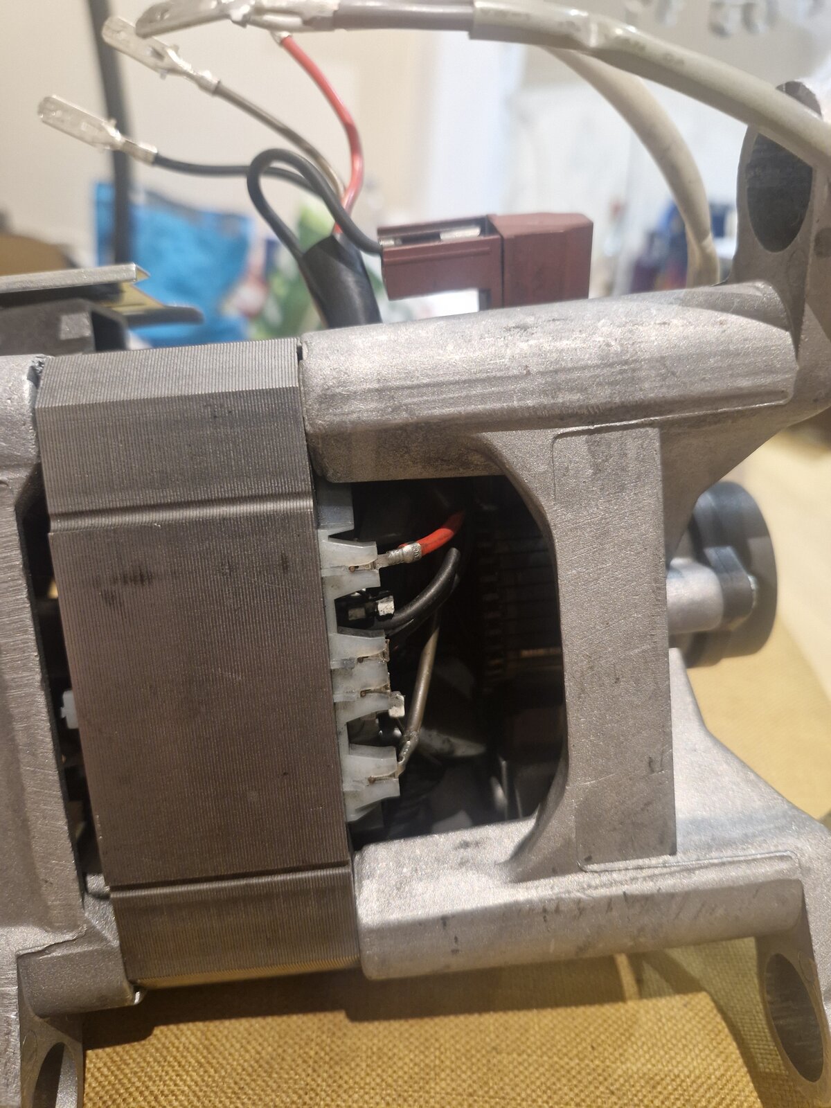

I need to wire a Welling Washing machine motor into a speed controller and I'm having a few issues..
I've followed a few videos to try and identify the wires on my motor and connect them to the controller, but the wires coming out of my motor don't seem to match exactly with any examples online.
I'm fairly certain that the brown and red wires coming from inside the motor are the coil wires, and as far as I understand it I need the coil wires and brush wires to get it connected to speed control. The brush wires are confusing me as one side of the brush has a wire running into the motor, where the examples online all seem to have wires running outwards from both sides of the brush.
Following a YouTube video, I tried wiring this into a US-52 speed controller but no arrangement of connections has worked. Interestingly, the controller sparked and smoked when plugged into the mains, despite being turned off and supposedly rated for 220v. The indicator light still turns on so I'm hoping it hasn't fully burned out, but without any other motors to test it with I can't be sure!
I've attached images of my motor, if anyone can offer any help here it would be greatly appreciated!

In series connect one brush wire to one field coil wire
then connect the remaining field coil wire and the remaining brush wire to the controller output.
If you don't know which wire is what, confirm with a multimeter, the two lowest values will be for the brushes and the other two (around 15 ohms off my head) should be for the field winding.
