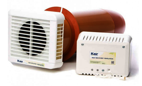

I would say a heat recovery unit works far better than an extractor fan, but not even convinced we need extractor fans, in a shower the problem is the chimney effect, cool air enters bottom of shower enclosure, and leaves top distributing the moist air throughout the room. Remove the shower cubical, (as with a wet room) or seal it at the bottom, and the room does not get anywhere near as wet.
Be it smells or moisture, we want the fan to activate on leaving the room, not entering. And to do it with as little noise as possible specially at night, the heat recovery unit is likely a good compromise.
The heat recovery unit 1671277795809.pngcan use the pipe through the wall as the heat exchanger, and can run for much longer without pumping all the expensively heated air outside, but I have found a shower which seals on the bottom of cubical does not fill room with steam, so no fan required.
