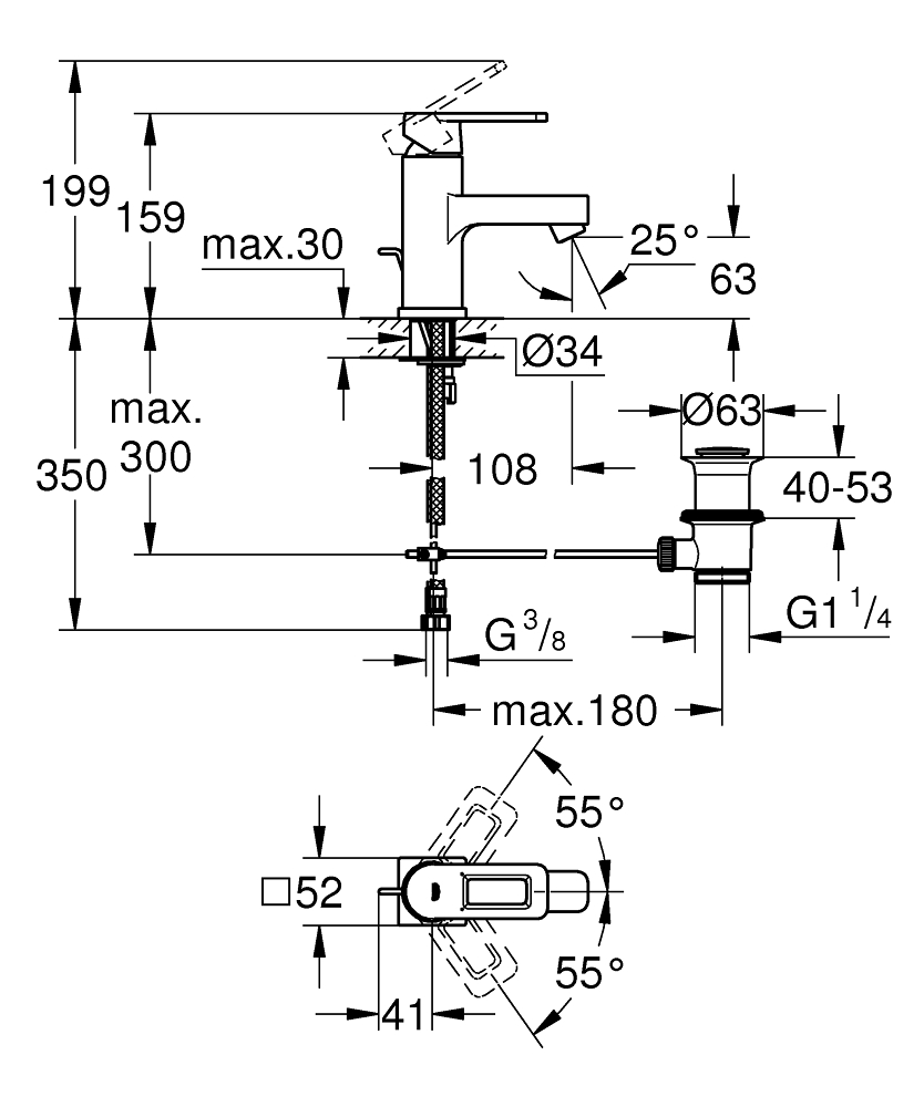

The Grohe tap on my bathroom basin corroded(!) at the base. (Grohe Quadra tap) This tap had an integrated linkage to open the waste. The new tap came with a slotted waste and a pop up plug. The basin does not have an integrated overflow and so I think I need a different waste. The old system had a mechanism for the linkage and a plastic piece that has an inlet to accommodate the flexible pipe from the overflow. The basin itself is an Atlanta Breeze.

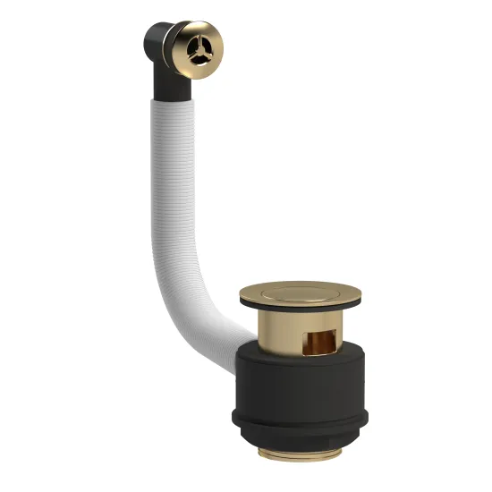

I do remember that Mcalpine did a 1.25" basin waste with an external overflow and so did Wirquin but they tended to be the old type waste with a chained plug, just search about and you'll find them

Can I just check, your issue is that the basin has an external overflow which means there is a plastic piece that is connected to the overflow and then a flexi tube from that runs down to a connector on the waste below, something like this?
Looking at the tap though - it is a pop up waste basin mixer tap but that doesn't have an integrated overflow as part of the waste, it just has the hole for the rod for the pop up mechanism

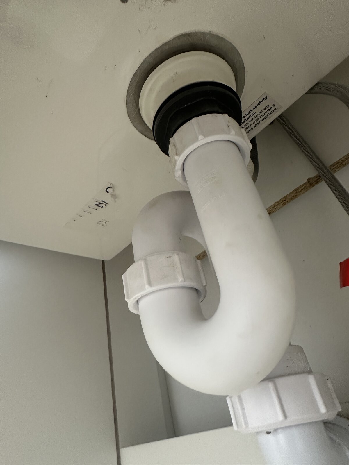

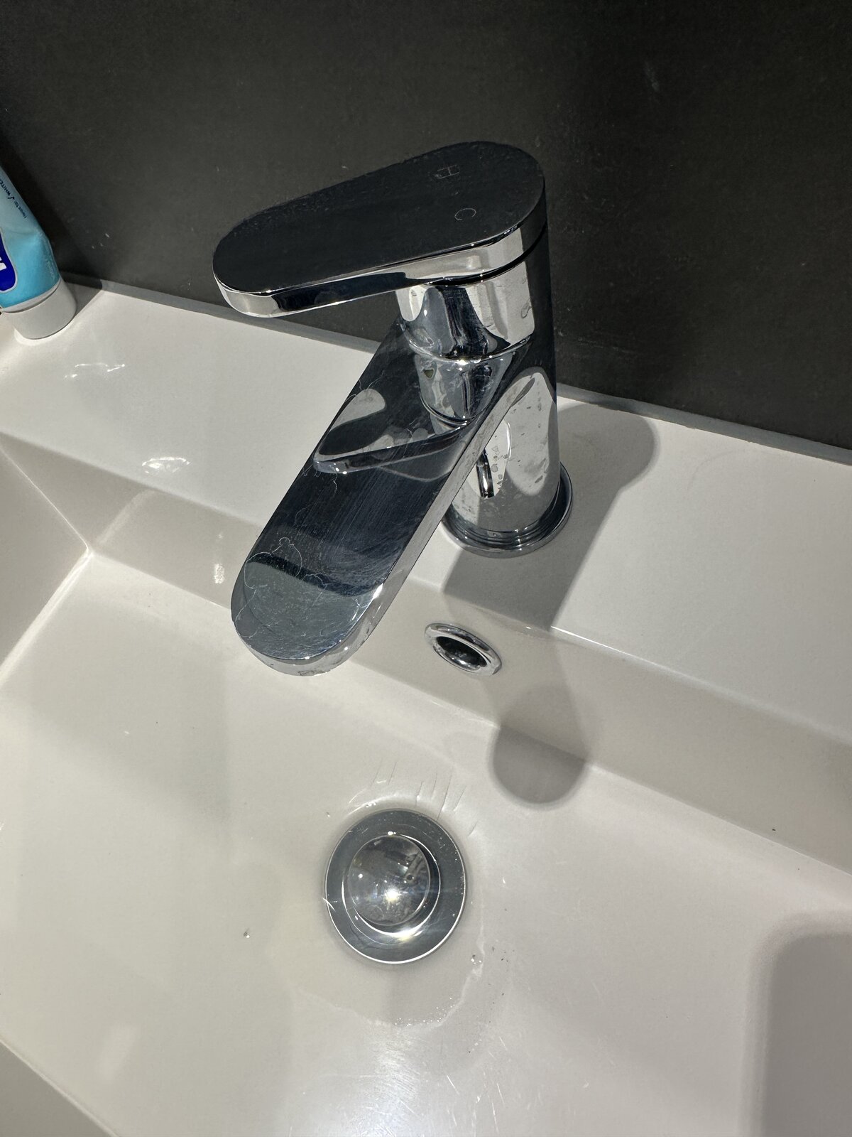

Here is the current setup. I have a slotted waste that came with the tap and, it turns out, should be a non slotted one. The white bit under the tap is part of the old Grohe setup and is a bodge to allow me to use the basin. It could be that putting a non slotted waste in will fix the minor leak but I am not happy about doing that. I could block the overflow but I have small grandchildren and that seems to me like a major risk.

OK - that basin looks like it does have an integrated overflow. So a slotted waste is what should be used. The current waste below the basin has the standard waste with the added pop up rod section at the back of it, would have originally come with the tap.
What would be needed is to take all that out and simply replace it with a new slotted, click clak, captive or other type of waste and a new standard monobloc mixer tap.

Also, it definitely does not have an integrated overflow as well as not being a kitchen sink but is actually a bathroom basin as in OP.
