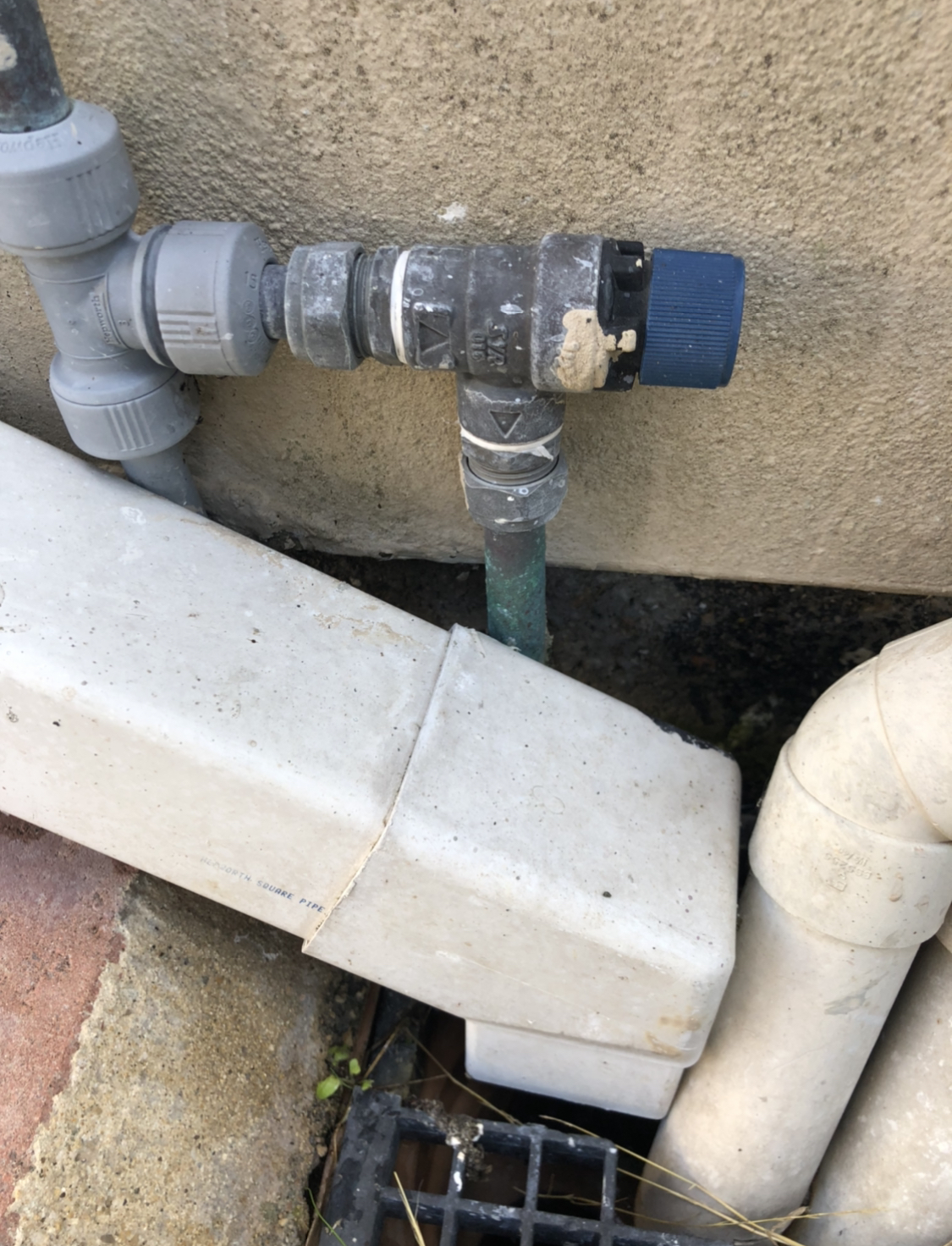

I’ve got this pipe outside which is always making a sort of hissing noise so I’ve had a look & water is constantly coming out of the copper pipe. I’ve tried turning that blue fitting but all it does is make the water come out faster & then if I turn it back to how it was it’s still coming out just not as fast.
3D647C16-AEF2-40D0-B758-7E6A482A2C0D.jpeg91733B24-822E-4984-9A55-72B19435E385.jpegC63B4A4F-0008-44BC-90C0-76301674EFEB.jpeg
Looks like a pressure relief valve. What type of hot water and heating system do you have?
Looks like a pressure relief valve that's open / passing. Odd place to put it !!
PRV passing. Either the pressure is too high, or the PRV is leaking/failing to seal.

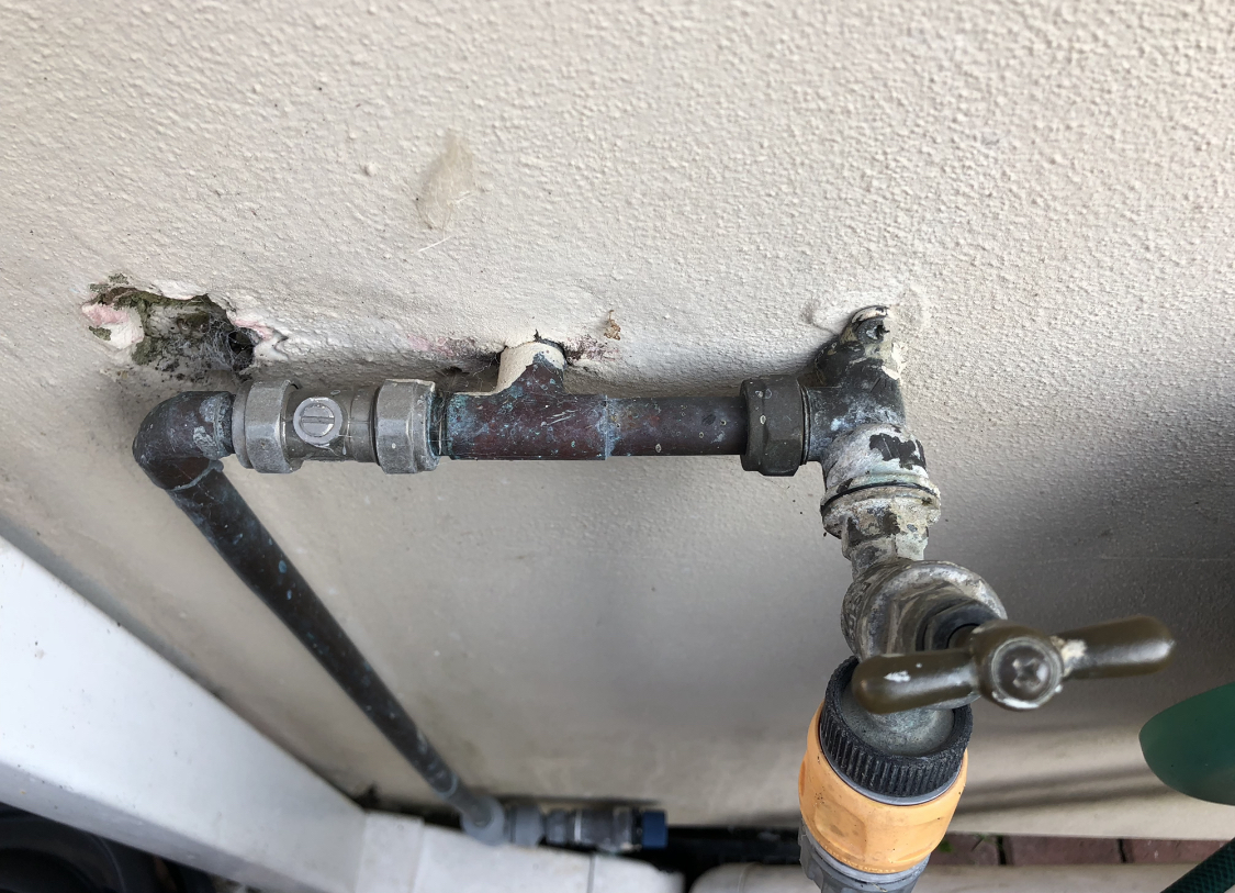

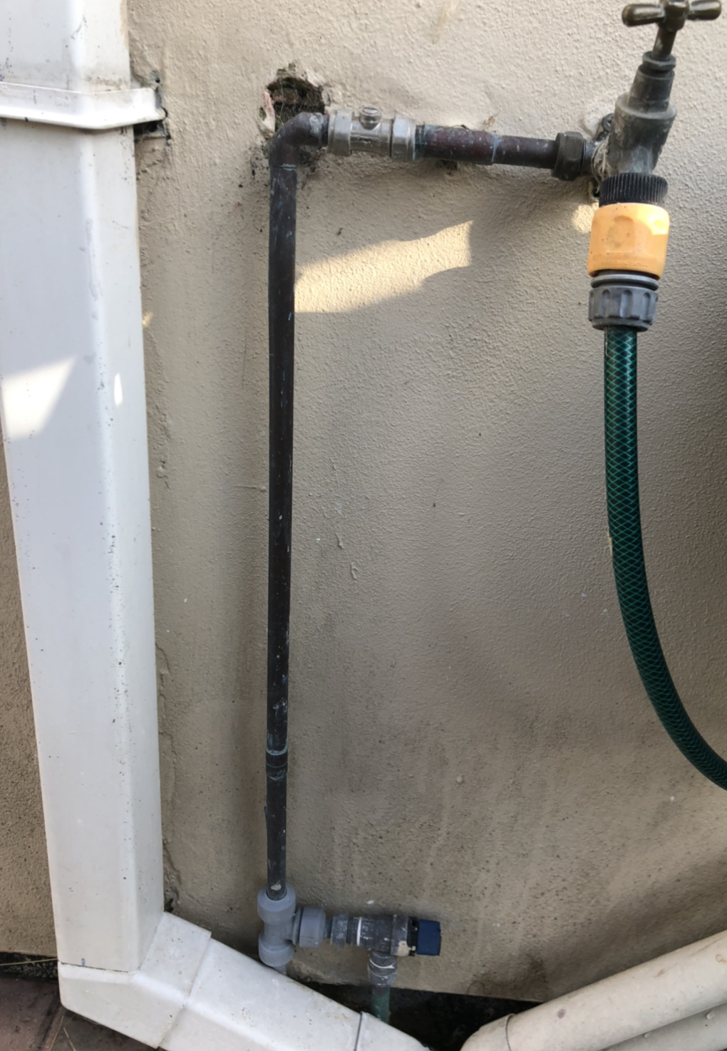

The garden tap appears to have no connection with the PRV. There are two copper pipes emerging through the wall, the supply to the tap and the other to the PRV.
In image number 3, the copper pipe looks like it runs down to the T junction where the "PRV" is I cannot see any copper pipes coming out of the wall. The only pipe I can see coming out of the wall is the plastic one in image 2. What am I missing?
Looking again at #3 you might be right. Where I thought the two pipes emerged looks as if it may be just an elbow, with some sort of hole in the wall behind it.
Tbh, looking at photo 3 that could be a copper Tee near the tap?
Looking at the image on a super high def laptop, the join to the left of the garden tap looks like an elbow- the other odd thing is that the copper pipe coming out of the ball/screw fixing valve (RHS) has a flared join, rather than a single 15mm copper pipe.
