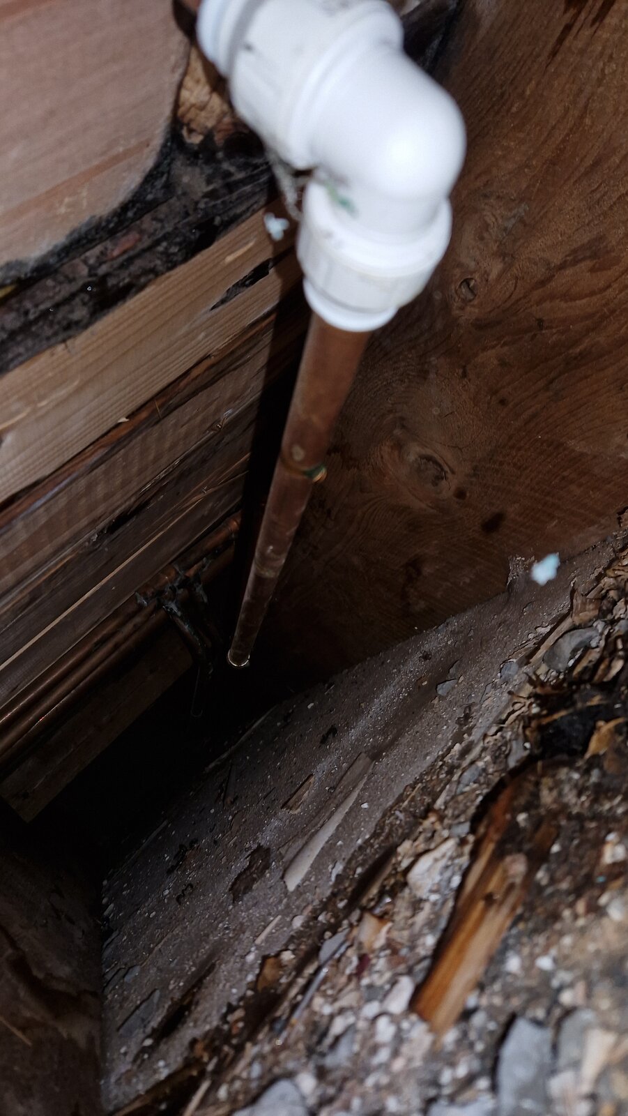

Some photos from under the floor. The drips were wiped and didn't return so weren't from the pipe joints.
If it's under the tiles, the source must be above the floorboards.

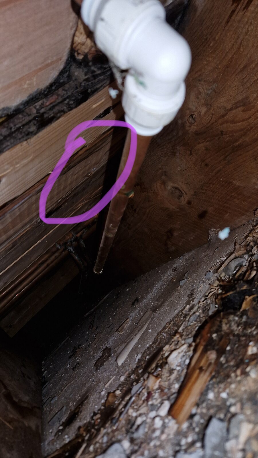

Some screws have gone through the floorboard and could have punctured a pipe. Also a noticeable drip on the copper pipe near the push fit elbow
Which screws? The drip was wiped and nothing returned on this. I imagine it's just run through from the tiling above and gathered.

These screws, although only short, still gone through, so where the pipes are touching the floorboard underneath further back could have punctured the pipe.
Good spot. These are radiator pipes and I'm losing no bar pressure though?
