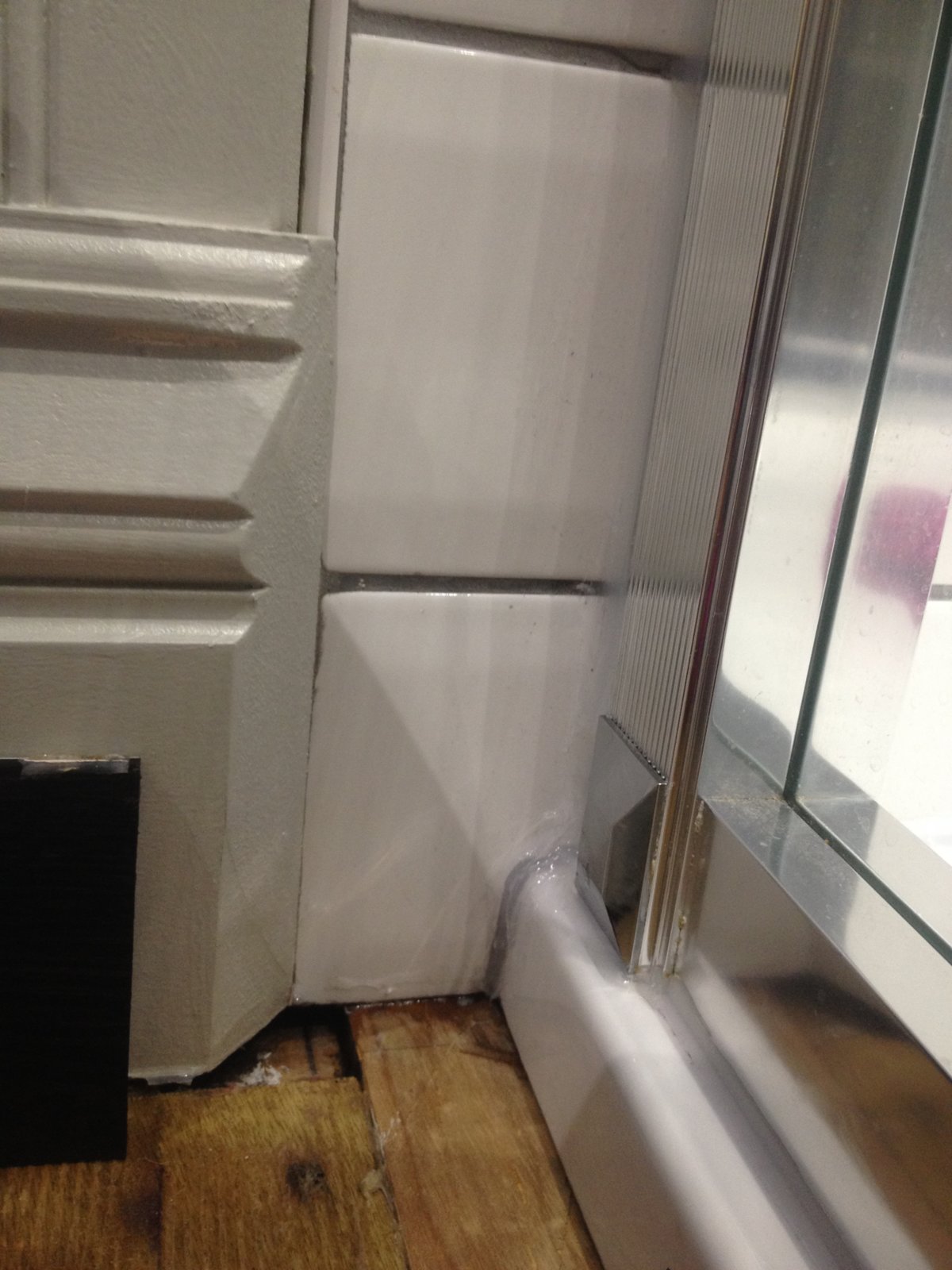

Short time later water is seeping up in-between the [Karndean] tiles, tracked this back to corner where one glass panel meets the wall. Dried out for >3 days using a hair dryer. Some grout appeared darker than the rest, but upon inspection of the sealant it appeared there was a small gap. Pouring a cup of water on the area meant more water leaking. (No water marks on the downstairs ceiling).

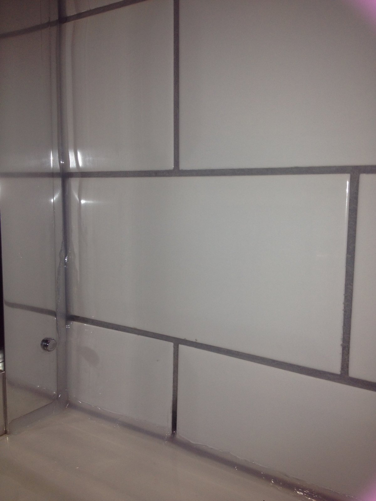

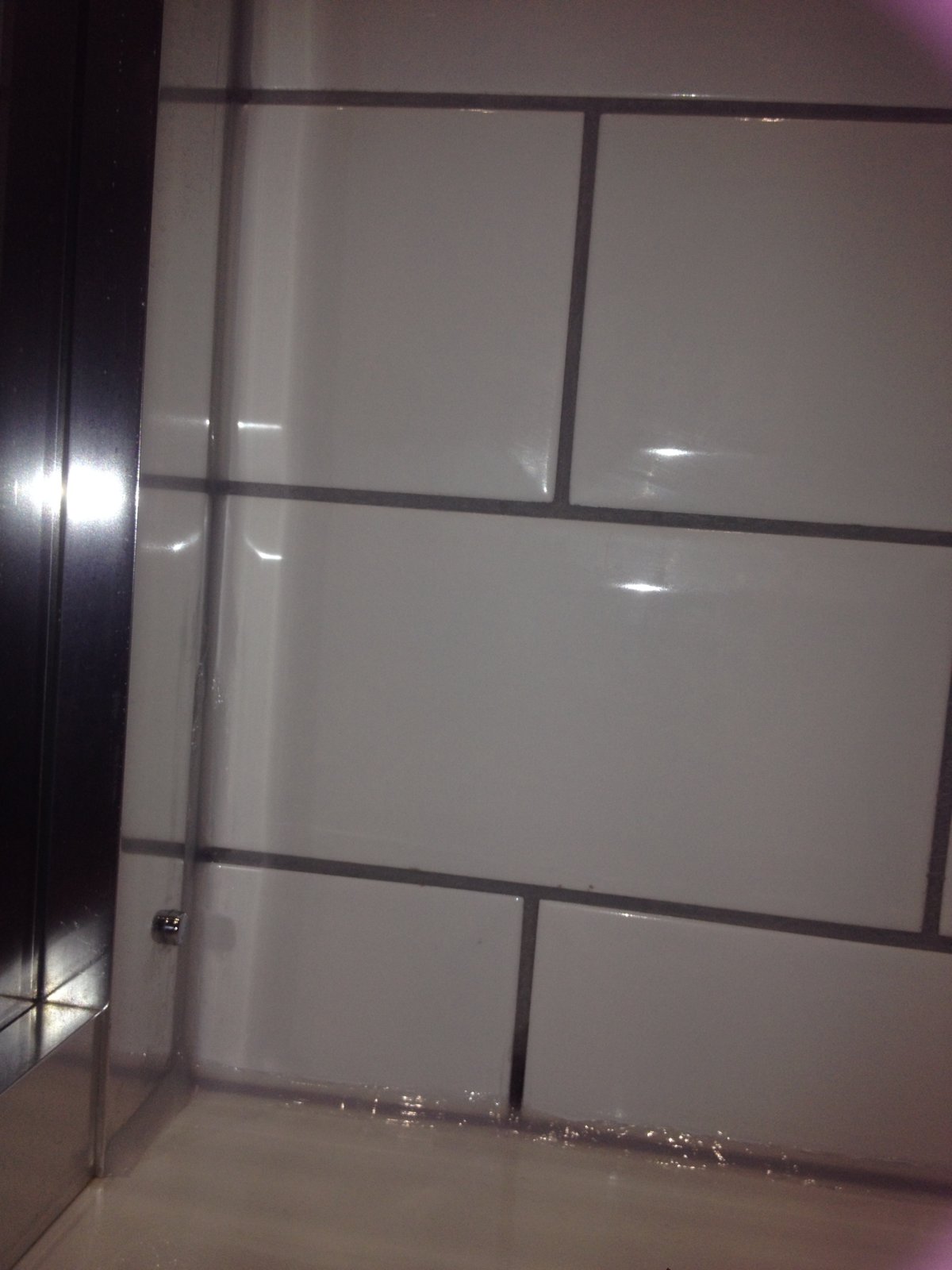

Water now appears to be coming from behind the tiles. The very bottom, left hand side tile. Currently drying it out again whilst searching desperately for an answer.
There is no plumbing on this side of the shower. The only possible answer is the grout. I can't see any physical deterioration of the grout but this may be because it's wet. (again!! pfff).

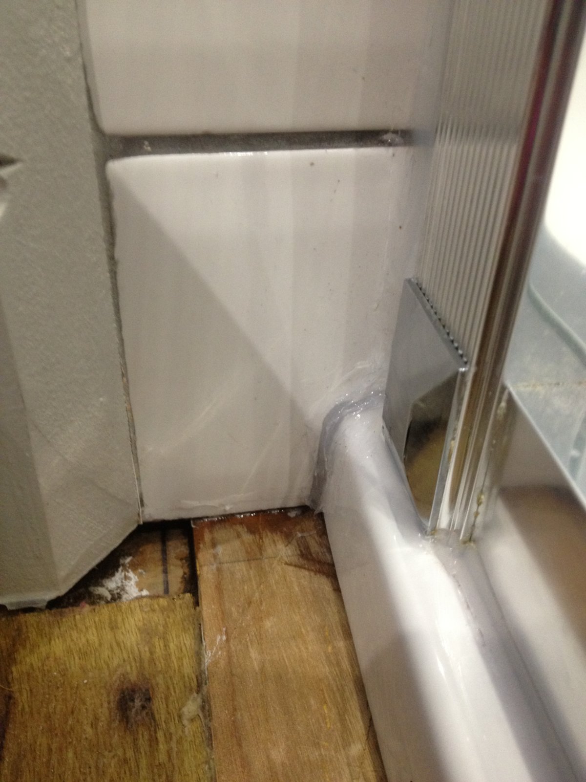

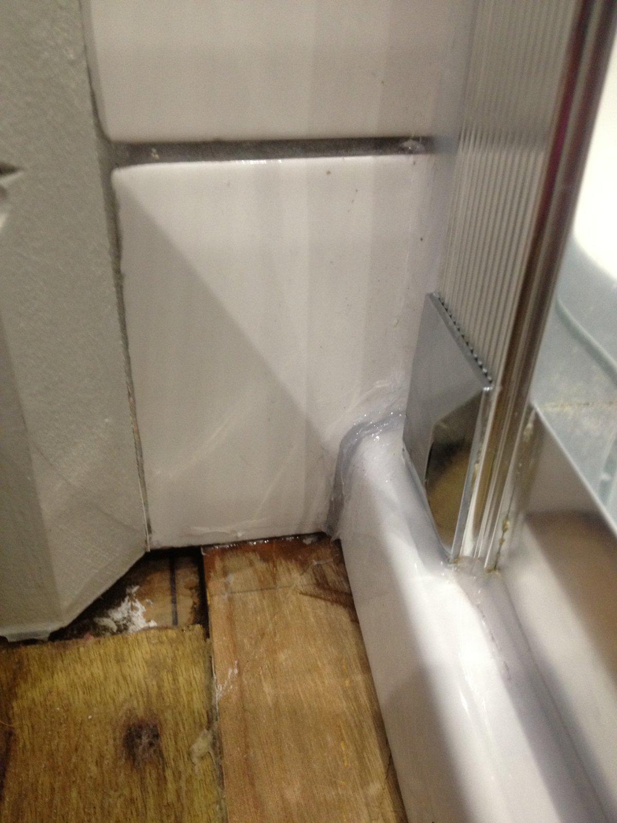

From what I can see of the grouting in your pics it looks fine. The silicone sealing however looks very dodgy. Inspect closely the whole length ,both where the top of the silicone meets tile ,and also where it meets the tray. See if its lifting away anywhere .
Thanks for taking the time to reply....the silicone looks bad because we've applied on top of the original silicone after allowing everything to dry and cleaning with meth. spirits. The original silicone appeared to have a small gap where there was a leak. Pushed it in using a rubber fougie.
Unfortunately there's still a leak...
Never a good idea to apply silicone onto silicone .strip it off and do it properly. Its highly unlikely a problem with the grout.
Whats underneath the transparent silicone where the tray meets the bottom of the tiles along the horizontal - its not grout is it?

We siliconed over the top because we were concerned about damaging the integrity of the silicone behind the glass panel. (The grey silicone was applied after the tiles were applied and before the glass panels were fitted). It has to be the worst looking silicone I've ever done (not that I've done much!). I'll be kind of glad to get rid of it!
When you stated " water seems to be appearing from behind the tiles" it left me somewhat confused . as I understood your earlier posts ,water is showing beneath the floor tiles ( vinyl ), and in the corner shown in pic ,the tiled wall in that pic does not have the shower supply pipework or shower. So where is water showing behind tiles ???
Before installing the upright screen profiles, did you apply a short bead of silicone to the intersection between wall and tray where the ‘heel’ of the profiles sit? This not being done is by far the most common cause of leaking enclosures that I come across!
As Terryplumb says - remove all the silicone and replace with Neutral Curing silicone. A lot of "sanitary" silicones are acetoxy? Smell of vinegar - this type DOES NOT stick to plastic - so when the tray moves it will come unstuck. I know (the vinegar one) is used everywhere and by window fitters - But I went to a job where there were yards of it flapping in the wind. Pulled it off and re did it with neutral curing. Whats a fougie:unsure:
Yes, this was done prior to the panels being fitted.
I've just checked out the tube we used on top of the original silicone... acetoxy silicone.... !
(This tube wasn't what was used originally but I'd have to ask what was used - a mute point really seeing as it'll all be coming off).
Good Morning, sorry... I'll try to make myself clearer.
The leak was first found tracking along the floor vinyl (along the adhesive lines), we tracked it back to the corner in the photo.
The water is not leaking over the shower tray, so unable to observe any obvious water leak/ hole.
First signs of any leak is when the first horizontal grout line gets dark and water starts to seep on to the floor from behind the tile.
Almost as though the leak is travelling behind the tiles from that corner of the shower...

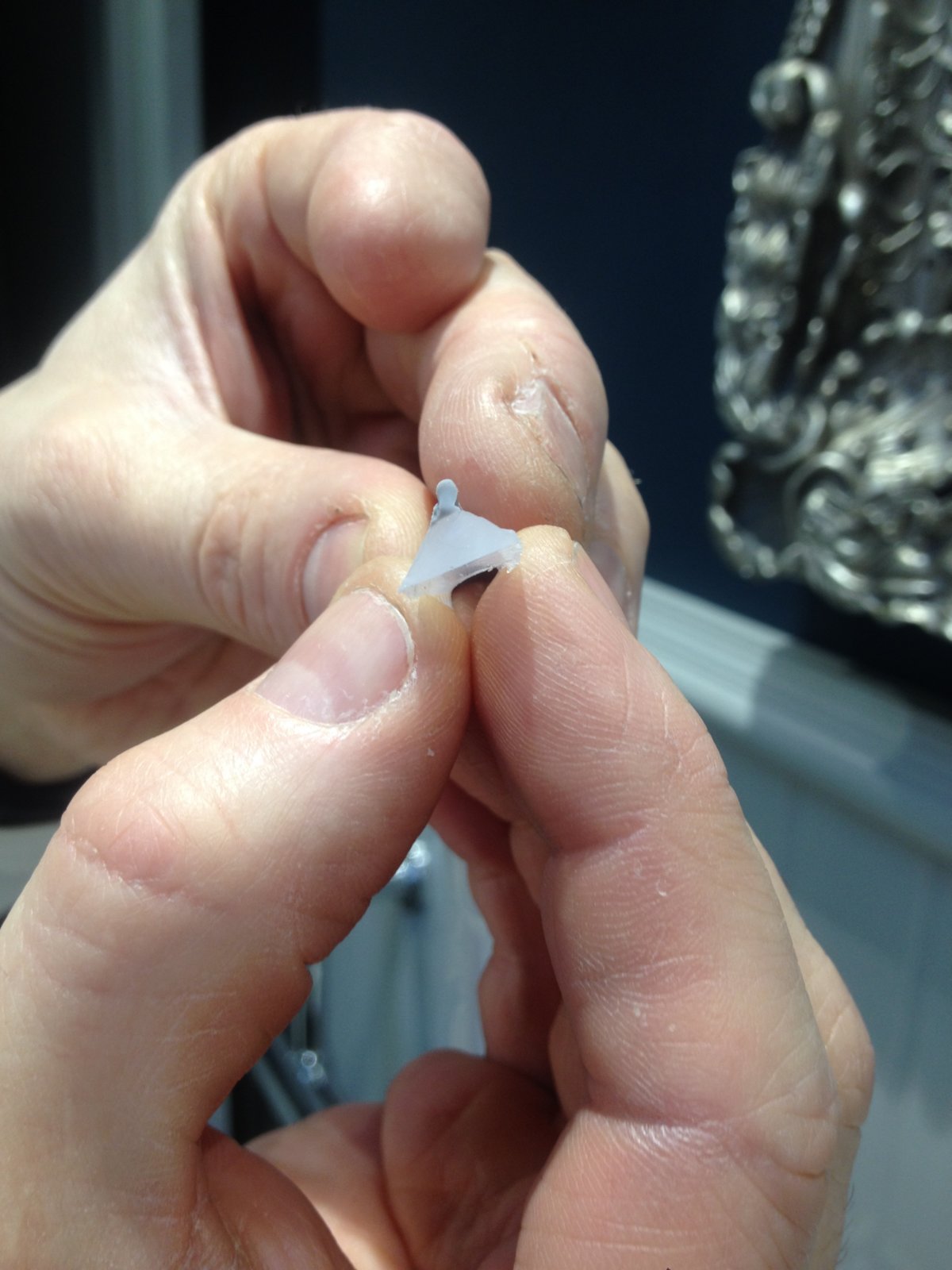

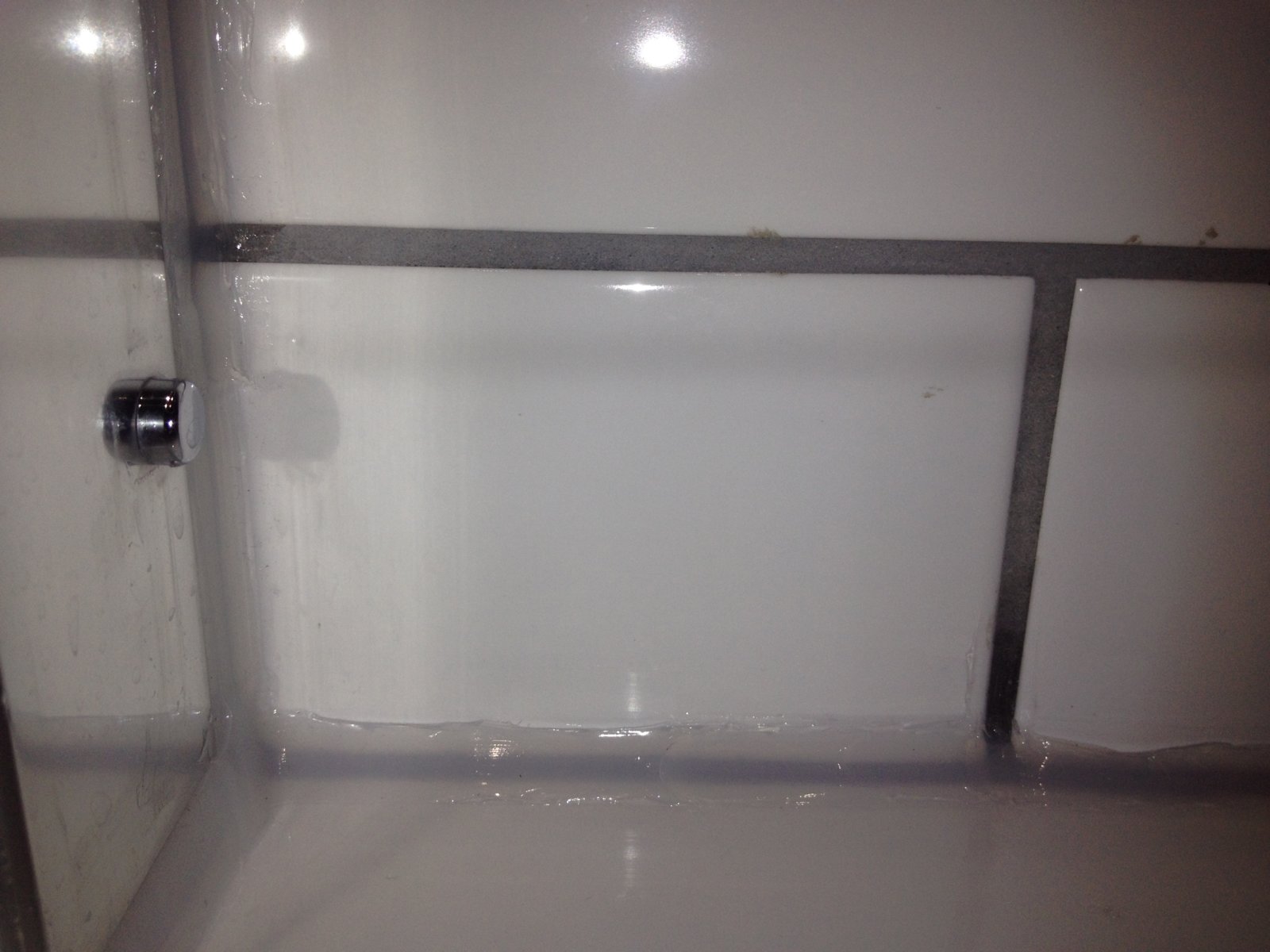

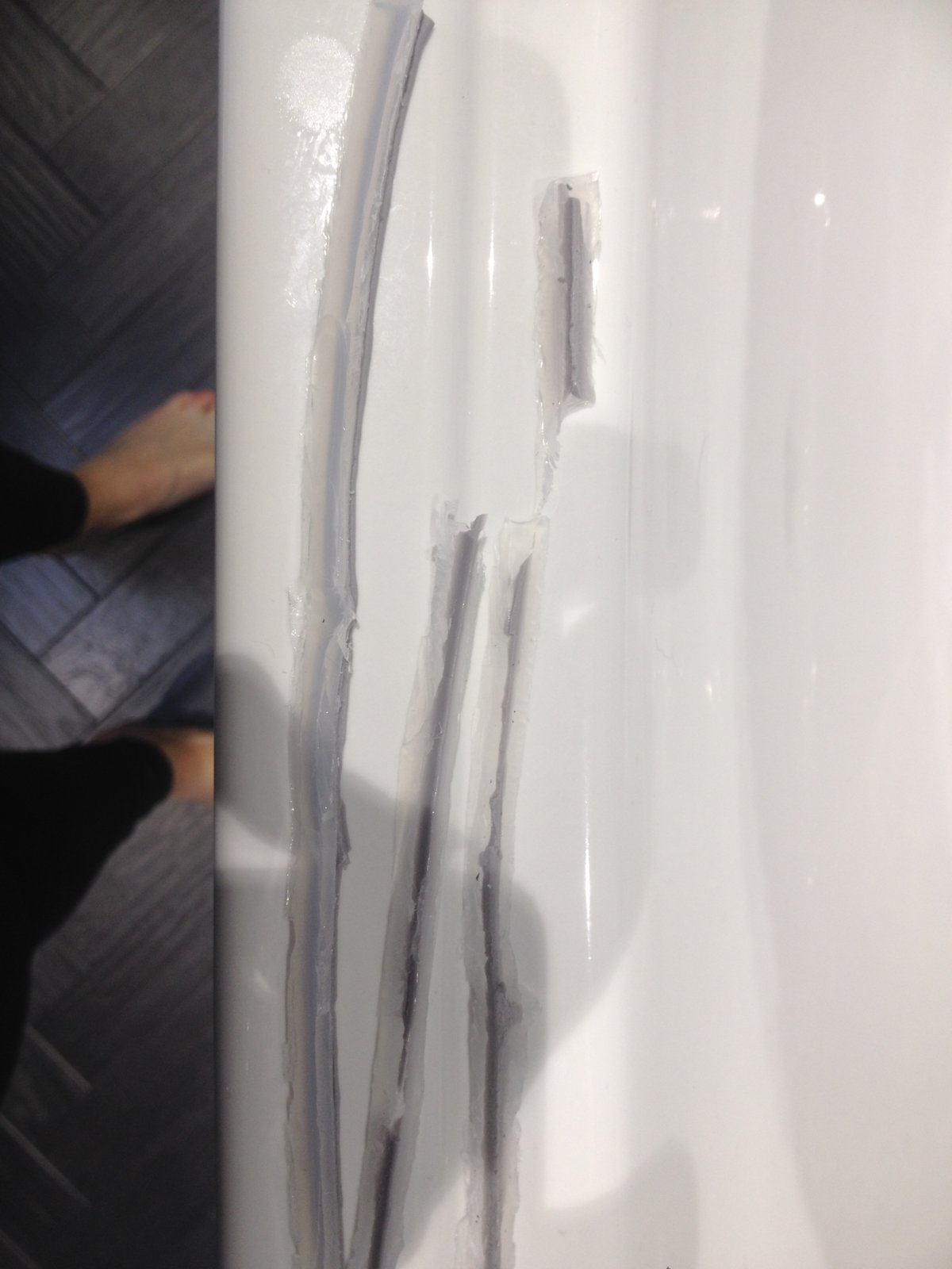

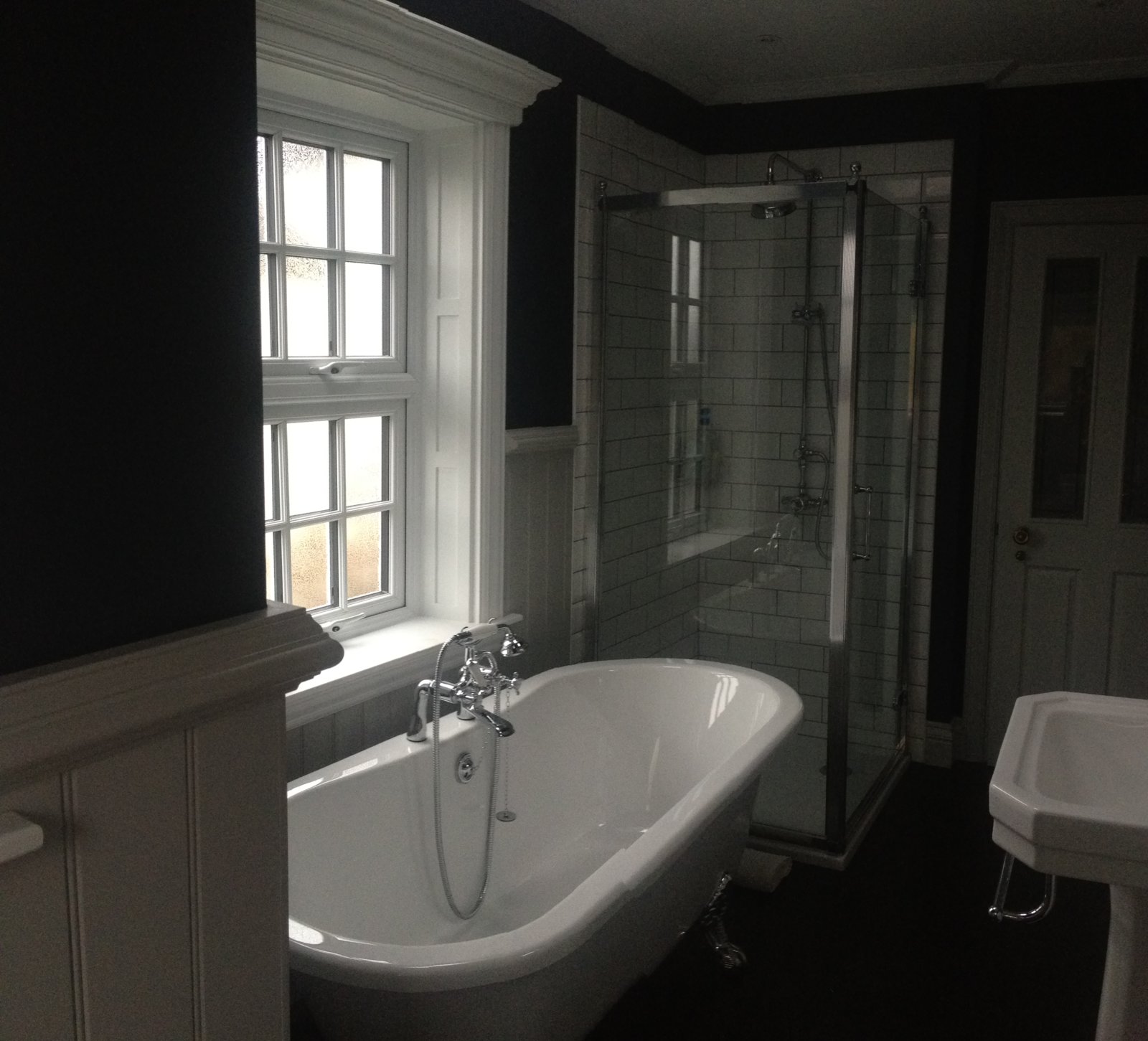

Mini update:
Removal of some of the horizontal sealant showed that we only had a small amount of original grey seal. (please see photos 1 and 2).
I'm hoping that we can get the shower dried out and re-sealed and back to looking like the last photo for christmas!
Thank you for all of your suggestions... I really appreciate it.
I think I was dreaming of hoping to have it fixed before my OH came back from a weekend away!
