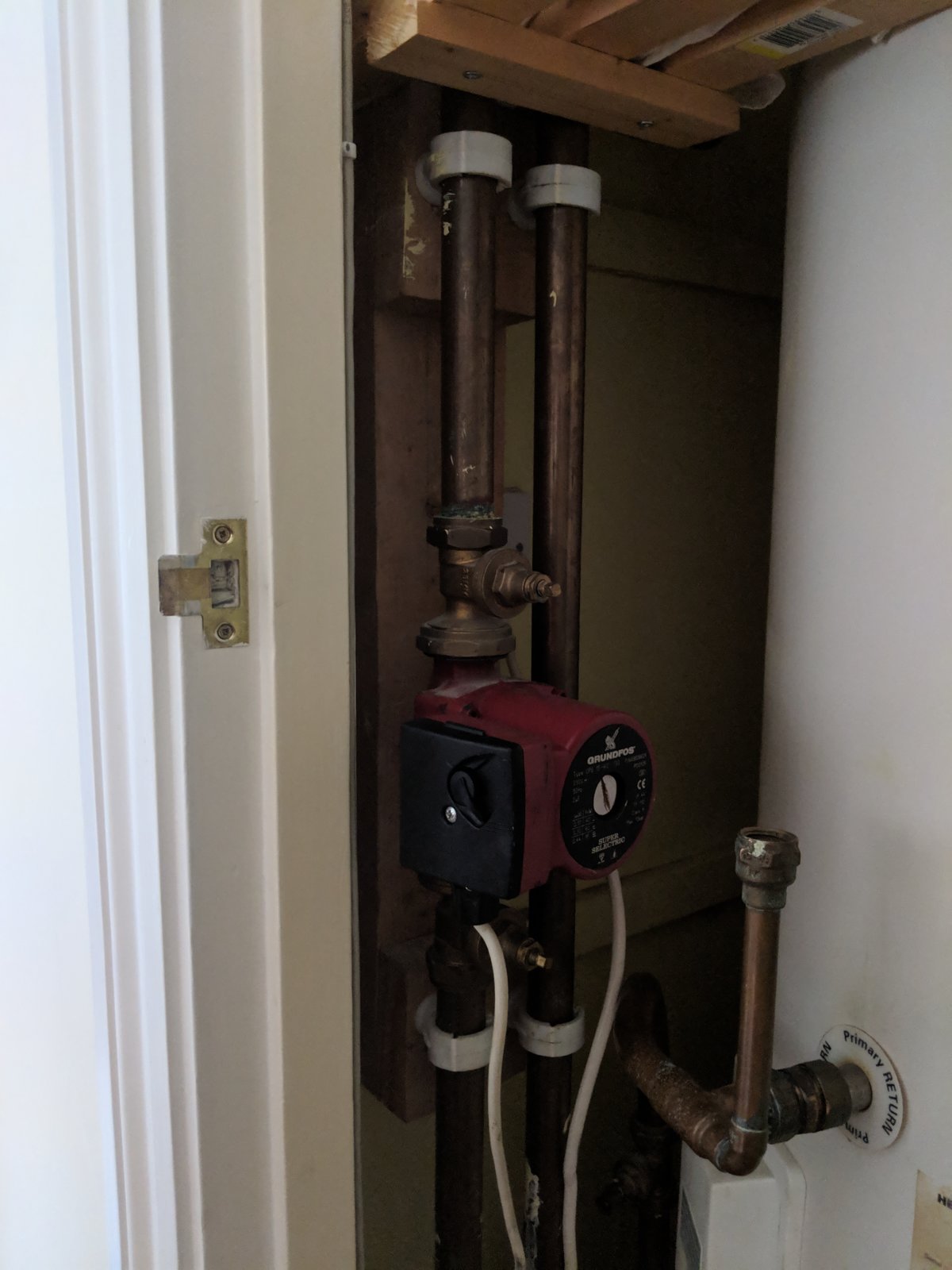

Would need to know more about your system. Do you have zonal heating ,your down and upstairs rads separately controlled ? Can you take pics of pump and pipework around hot water cylinder including motorised valves and post the pics here ?

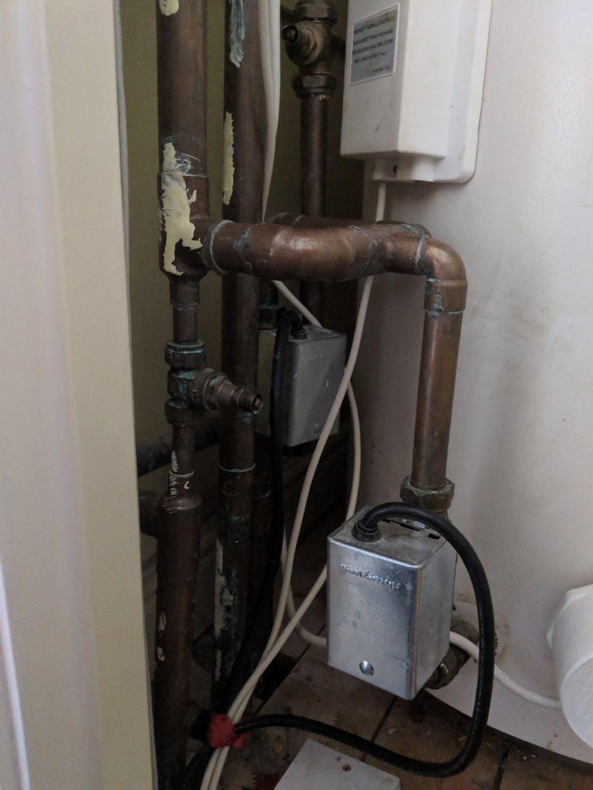

Do you have one "diverter valve" for hot water cylinder and one for heating? or more than one for heating.

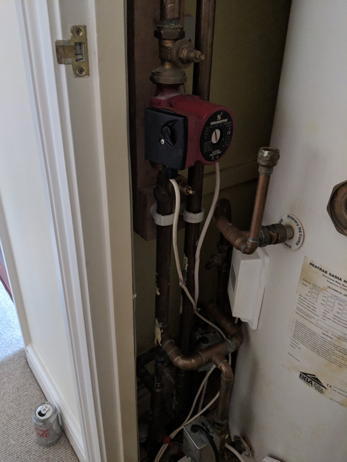

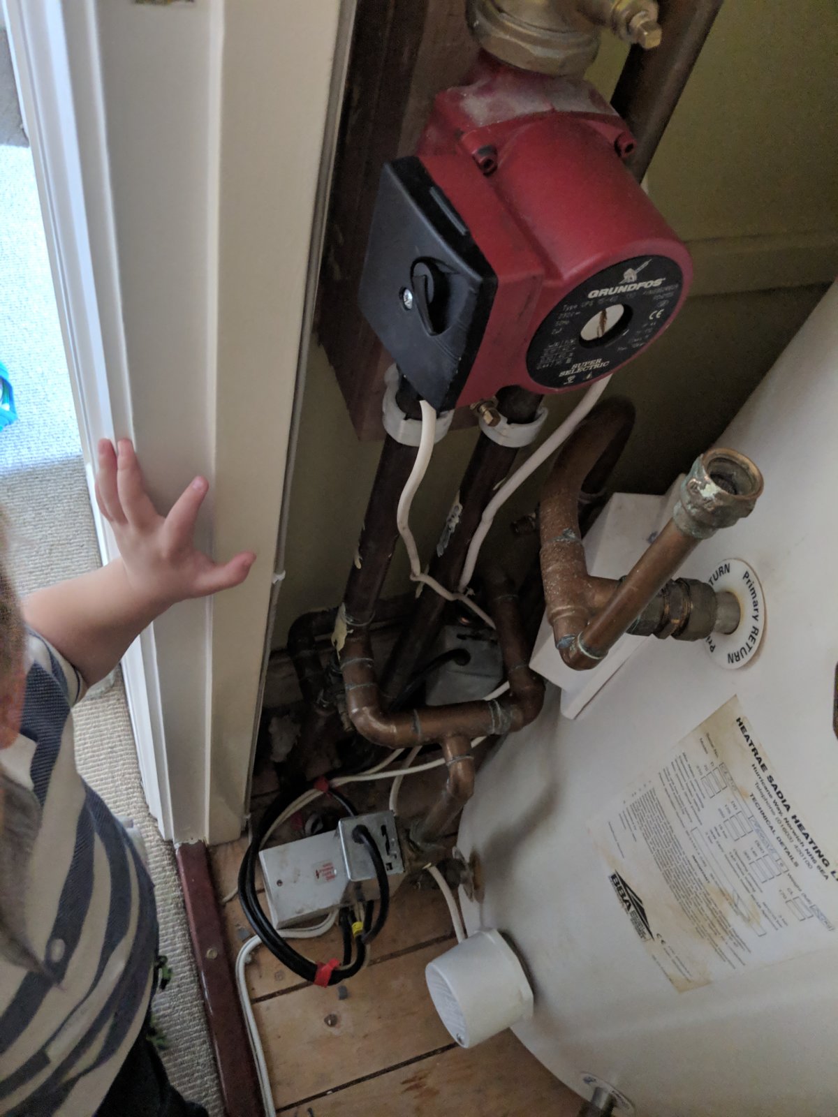

Thanks for the help everyone. I've checked the header cistern which all looks fine. Here's some pictures (excuse my helper!). I'll turn off all the upstairs radiators now and see what happens downstairs. Should I leave the heating off for it?

Hot water to OFF ,central heating on ,wall stat to high. ( if you have latched motorised valve ,put back to auto position ). Down rads trvs on full ,upstairs rads trv closed off.
it could be when they turned mains on, a rush of water into cylinder disturbed the coil, and a piece of scale or debri sludge loosened off, and traveled round , either getting caught in pump impeller, or diverter valve. reducing the flow . maybe.
Thanks all, downstairs rads are now getting hot. Will leave it a while to see if every rad downstairs gets to temp. Assume that rules out the diverter valve at least!
