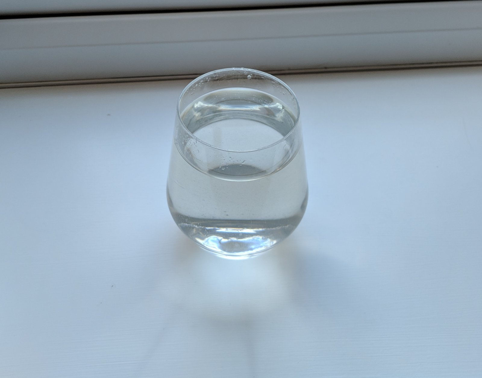

Might try draining down and refilling and seeing the state of the system water that comes out.
January this year - they cleaned the system
I bet it will be the colour of used engine oil. :ROFLMAO::ROFLMAO::ROFLMAO:

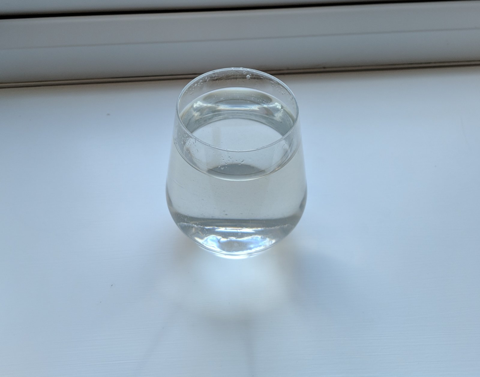

I've attached a pic of the water that came out one of the radiator drainage valves, unfortunately (fortunately!?) it's pretty clear.

4) it doesn't seem to be sludge (or should I be checking somewhere else?)
