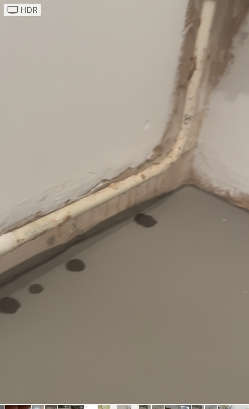

Hi all
I am renewing some pipework which will hopefully solve this, but why would there be water drips coming from copper pipes. The outside of the pipework is wet.
Would this be due to old pipework etc?
It only seems to happen at night time.
Many thanks
Not the best photo, but could be condensation. Colder supply and you may have the heating on.
