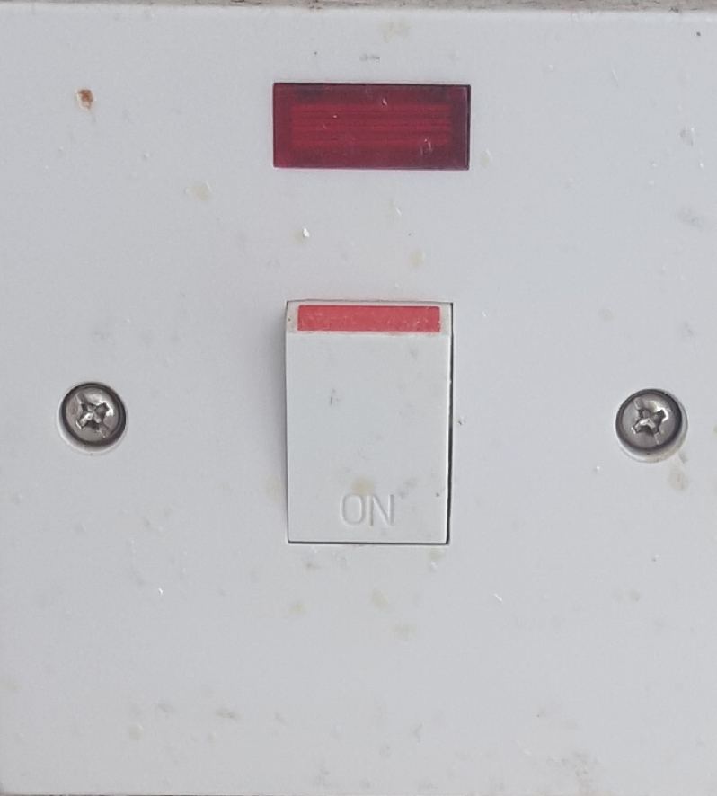

Is there a double pole switch for the off-peak supply in the open position, by any chance?
Yip its on ... first thing we did when it was all installed was turn it on ready for the next heating time .. but it didnt come on so we are using the boost for hot water

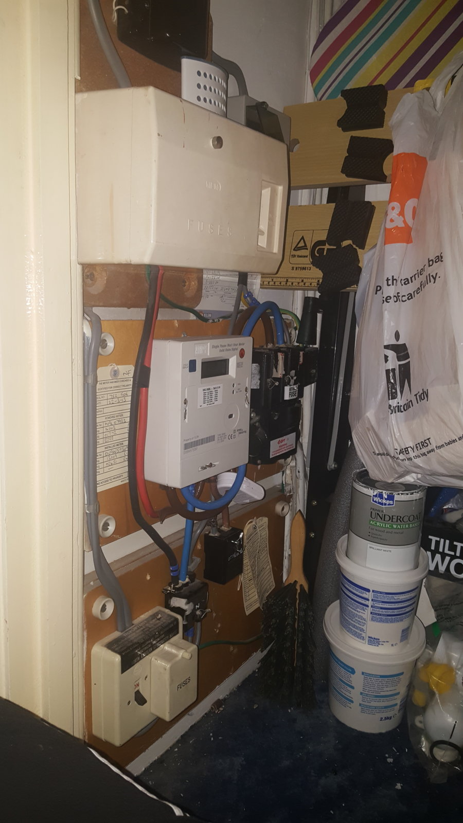

I would get you timer checked out, can you post a pic of it

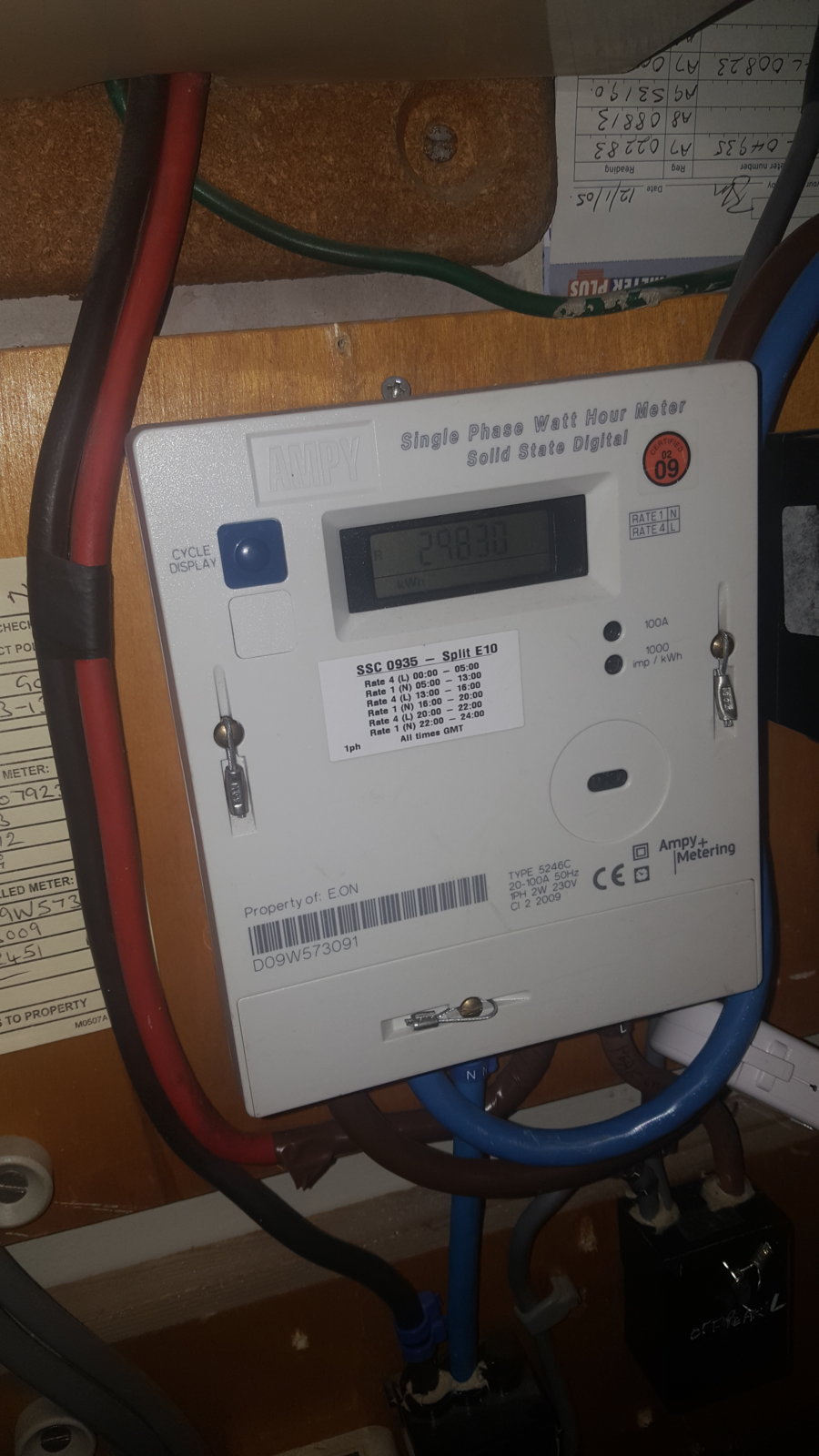

This pic shows everything we have in the electric cupboard and the digital meter ... that is the only thing we have in the house apart from the heater itself and the on and off power switch regarding the heater.

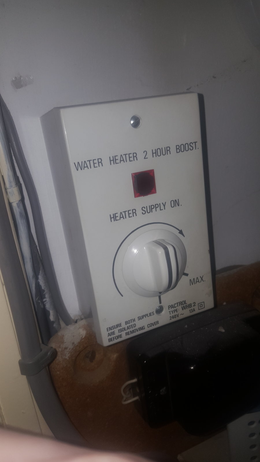

When you say you used the boost, is this on a unit near the hot water cylinder, can you do a pic of it
Nah its in the actual electric cupboard .. the cylinder is in the airing cupboard in the kids bedroom ....
