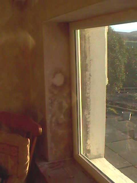

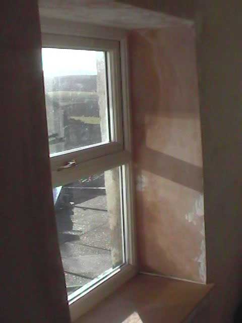

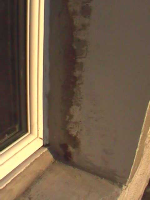

Hello all,

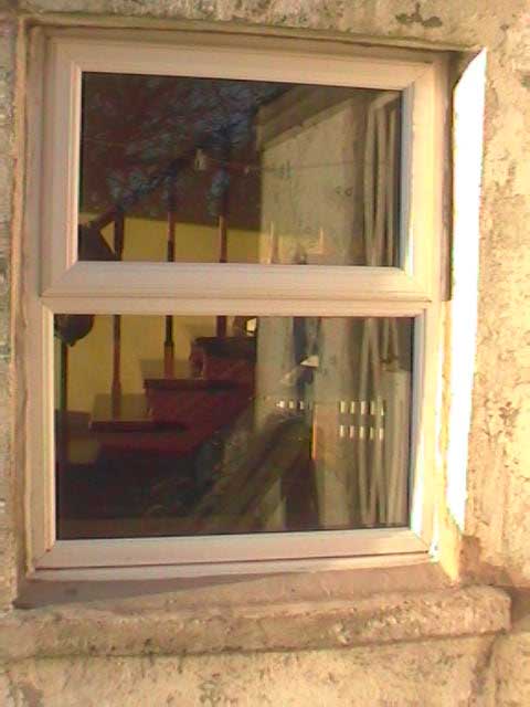

Right...I installed all the new windows (uPVC double glazed units) myself, and thought I'd done a good job :cool: ..until autumn arrived and now I have water ingress at the sides of a few of the windows :( . I fixed the windows using the clip-on side adjustable fixings, then expanding foam, allowed to cure, cut back and then mortar 3:1 mix with waterproofer, let cure then silicon sealant.....you'd think that would stop the water ingress, but NO!! It hasn't and now this is the third time of doing this :eek: ...I've used the right quantities of waterproofer...the house is 200 years old, 800mm thick walls and the units are halfway in the rebate...where the frames meet the sides of the rebate there is a channel on each side to where the windows fit in (40mm each side)....the mortar mix seems to soak the water in like a sponge and then it appears on my internal walls wrecking the plaster..what the hell am I doing wrong and how the hell can I sort this out!!! I'm going mad, 2 years now :cry: ...PLEASE HELP, I have no funds for a pro and am going into hospital soon for surgery on my arm so need to act fast...apologies for such a long post.

However, we are where we are, and this guy needs some first aid. If the 'waterproofed' mortar is absorbing the rain and allowing it to soak through then it needs coating with a really waterproof paint. If there is a minute crack between the plastic frame then it should be possible to seal this with silicone.

I've got a stonemason friend of mine coming up in a couple of weeks to take a look, gratis, I hope....I've been mixing the cement in a bucket with a drill mixer, and have been thinking as to wether this is adding air into the mix like mixing a cake mixture in a bowl, maybe I should be folding it in gently with a shovel on the floor...I really don't know wether this makes any difference or not??? If it does then I am a lazy git and deserve to have water ingress. Thanks again for your help...Matt.
One other possibility to consider - modern plastic window frames have a complex profile including channels for water to run down and vents for it to escape to the outside... could you have accidentally filled or sealed these? I get the impression that you mean it is rain penetrating round the frame, have I understood?
thanks again....yep it is rainwater...and it aint just a little bit either, the inside reveals get saturated...doimg my flippin' head in. :(

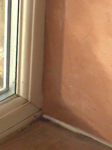

Did you seal the ends of the cill before you put the frame on it, or have you put the the window on the cill correctly, in most cases the lip on the back ( inside) of the cill goes against the inside face of the window not tucked under it, i've seen this done many times.
Also how far back are the windows from the outside of the wall, and what is the external wall finish, Render? Brick?

I just read you other post about 19 windows, if you only have 3 problem windows the chances are it aint the fitting its the walls, it looks like the were sash windows and the box has bricked up this could be the problem and the plaster looks newish did you use bonding as an undercoat ?
Also it like like water has been coming in through the glazing beads its worth taking these out to check the drainage is ok and that they're not full of water
