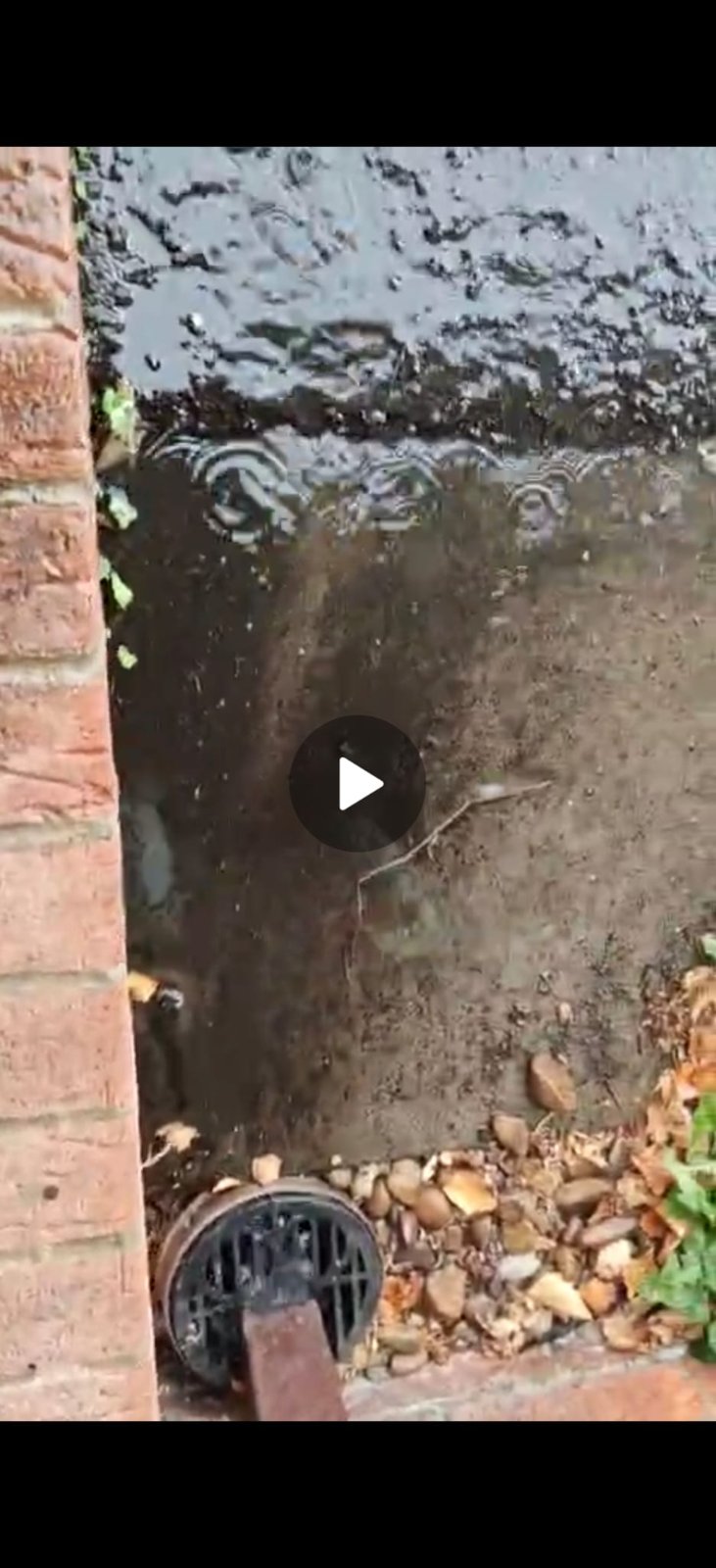

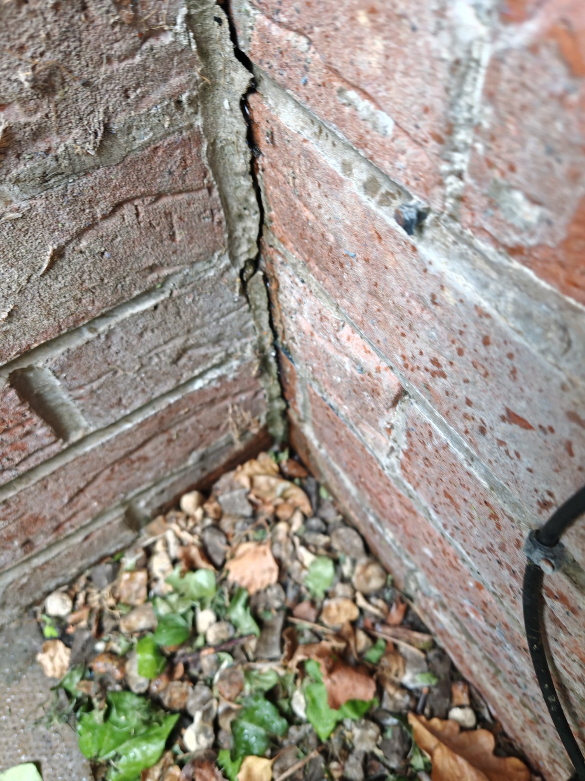

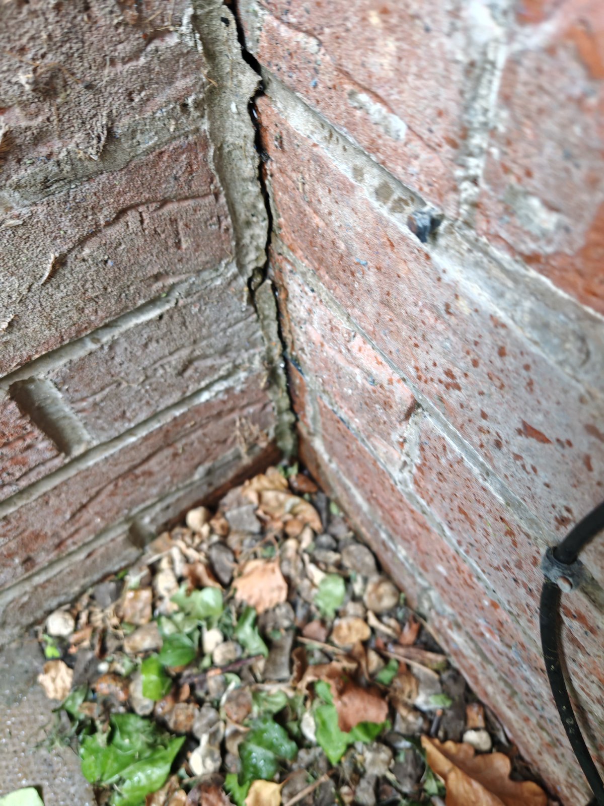

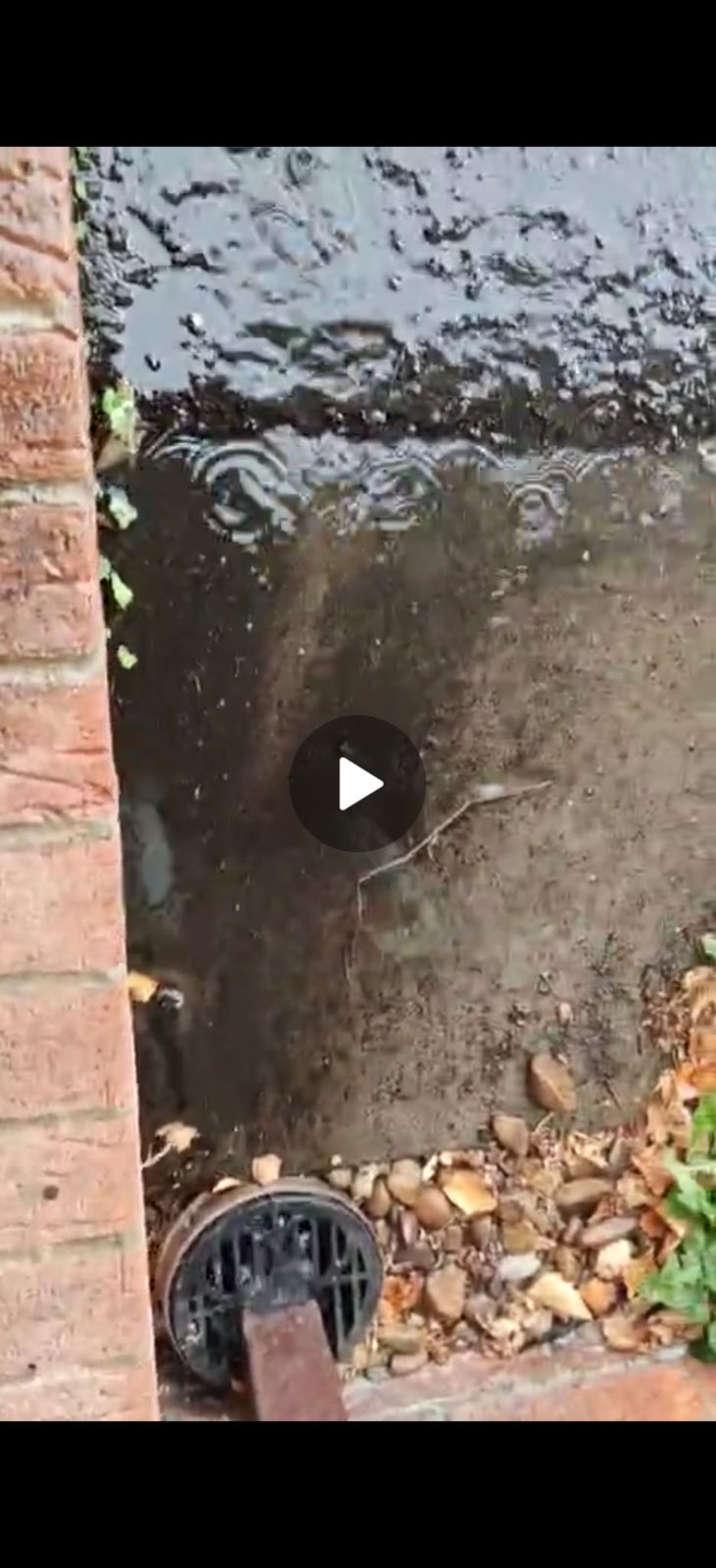

Hi there, I have water running down my wall, please see pics.
Cement was originally where the gap is.
A friend said leave open to prevent damp getting behind any obstruction. Though, I feel if left, the water will spread across the wall and worsen. There's some pooling on neighbours side and I have ran some sealant along the base of the wall on the other side. Despite this, the water's still sleeping through. So, my question is, do I fill in the gap with cement as it was in it's original form? Your thoughts will be most welcome. Thanks
Andy

These pictures are of the outside, have you got any of the inside?
The wall is dry and fine on the inside, no damage as of yet ; )
Water running down the outside wall, is not an issue.

Thanks chaps, I think some of the water is coming from the neighbours drive, it's on a slope. And my bottom gutter runs off down into the neighbours run away drain.
As it's only a small gap between the garden wall and house, it's hard to truly ascertain where the water is coming from. I have a video, which shows the problem, but the file is too big. I'll see if I can edit it. Cheers
